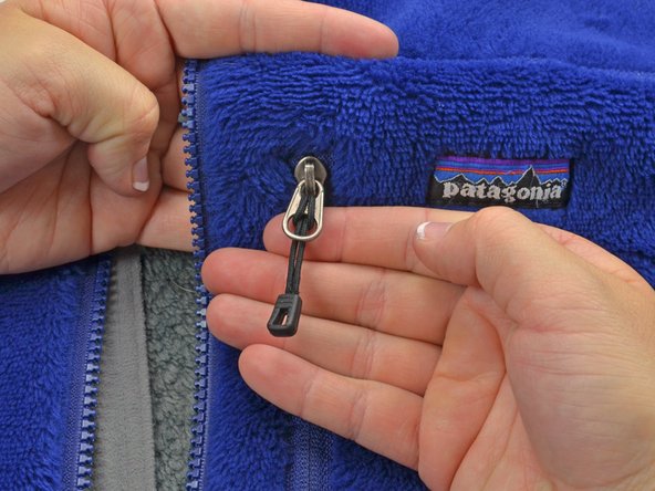

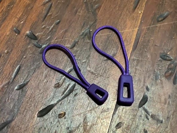

      • This tutorial demonstrates how to insert a paracord pull with a rubber end, a common type of zipper pull on Patagonia products. These pulls come in a large size for main zippers and a small size for pockets (reference image #2).
      • If you need to remove a damaged zipper pull, skip to Step 6.

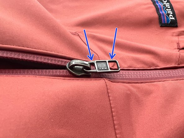

      • Locate the zipper slider that is missing a pull. The slider has a tab with two holes, one where the tab is attached to the slider body and one at the end of the tab.
    2. Zipper Pull Replacement, Insert the paracord end: crwdns2935265:02crwdnd2935265:01crwdnd2935265:02crwdne2935265:0 Zipper Pull Replacement, Insert the paracord end: crwdns2935265:02crwdnd2935265:02crwdnd2935265:02crwdne2935265:0
      • Pinch the paracord end of the pull and slide it into the tab hole that's closer to the slider.
      • It doesn't matter whether it's inserted from the top or bottom.
      • Pull the paracord through the tab hole.
      • Use pliers to help pinch the paracord and aid in this step, especially if the tab hole is small.

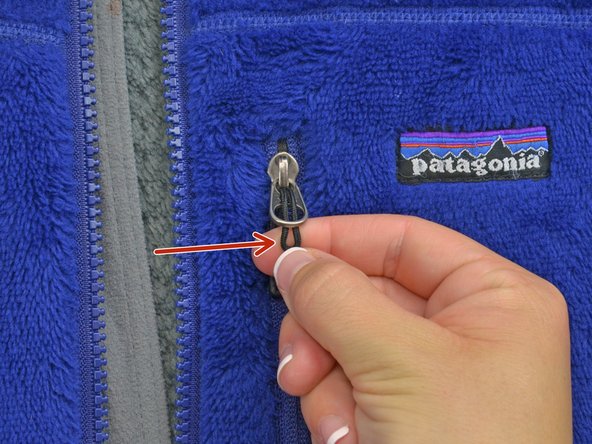

    3. Zipper Pull Replacement, Thread the pull through the second hole: crwdns2935265:03crwdnd2935265:01crwdnd2935265:02crwdne2935265:0 Zipper Pull Replacement, Thread the pull through the second hole: crwdns2935265:03crwdnd2935265:02crwdnd2935265:02crwdne2935265:0
      • Pinch the paracord end of the pull and thread it through the other hole on the slider tab, the one furthest from the slider body.
      • Now there will be a paracord loop emerging from this tab hole (reference red arrow, image #2).
