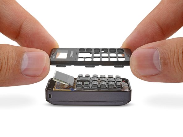

    • Opening a phone of this scale requires specialty tools. Fortunately, iFixit has got it covered.
    • Despite its retro aesthetic, this opening procedure is far from obsolete. Some micro spudger action frees up the front clips, and the top plastic plate is free!
    • Unlike with some phones, we encounter no proprietary screws here.
    • We move the keypad aside and find the button pad soldered to the board beneath.
    • To supply backlight to the keypad, two white adhesive pads diffuse light from four surface-mounted LEDs underneath.

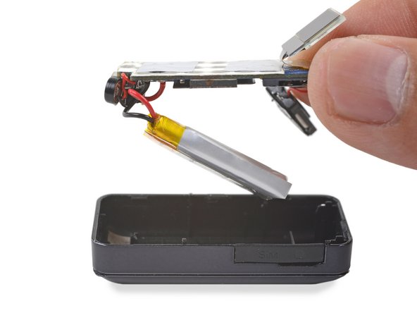

    • While most modern phones are held together by an army of screws and nasty adhesives, the Tiny T1 has none of that. Zero screws! Zero adhesives!
    • The entire innards pop out with a single pry with a (normal) sized spudger.
    • The likely lesson here: to easily open normal-sized phones, we need a giant spudger.
    • Who says small can't be repairable? (Looking at you, AirPods.)

    • Here we have the inner workings of the Tiny T1—all of them. It's just one board, with (nearly) everything soldered to it:
    • Speaker
    • Microphone capsule
    • High tech Bluetooth antenna (it's a wire)
    • "Nano" SIM slot, ironically hogging nearly half the board
    • Two mysterious pogo pins, which are accessible from outside—possibly for charging? Accessory port? A tiny taser?
    • 200 mAh 0.74 Wh battery (for comparison, the ENV3 has 3.5 Wh, while the Galaxy S9+ weighs in at 13.48 Wh)
    • While the S9+ battery packs over eighteen times the capacity, we doubt that its standby scales linearly to the Tiny T1's three-day rating.
