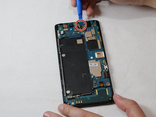

  2. ZTE Tempo Headphone Jack Replacement: crwdns2935265:02crwdnd2935265:01crwdnd2935265:03crwdne2935265:0 ZTE Tempo Headphone Jack Replacement: crwdns2935265:02crwdnd2935265:02crwdnd2935265:03crwdne2935265:0 ZTE Tempo Headphone Jack Replacement: crwdns2935265:02crwdnd2935265:03crwdnd2935265:03crwdne2935265:0
    • Use the plastic opening tool to gently lift and disconnect the wires.

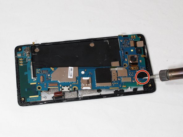

  5. ZTE Tempo Headphone Jack Replacement: crwdns2935265:05crwdnd2935265:01crwdnd2935265:02crwdne2935265:0 ZTE Tempo Headphone Jack Replacement: crwdns2935265:05crwdnd2935265:02crwdnd2935265:02crwdne2935265:0
    • Use a soldering iron to desolder the headphone jack from the circuit board.
    • Carefully remove the old jack and position the new one in place.
