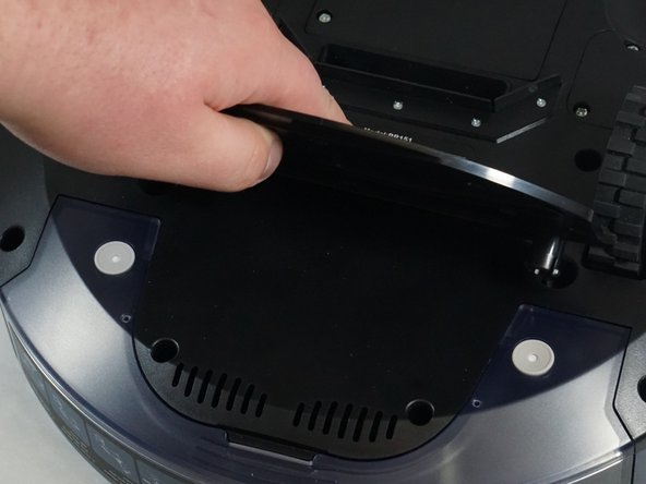

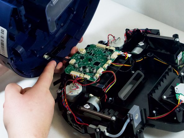

    • Carefully lift the bottom panel off of the top.
    • The top and bottom panels are attached by a set of wires. They will not fully detach at this point.
    • Gently place the bottom of the device on your workspace surface, wheels down, exposing the inner workings of the device.

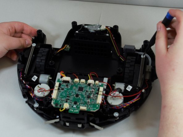

  8. ZCWA BR151 Wheel Replacement: crwdns2935265:08crwdnd2935265:01crwdnd2935265:01crwdne2935265:0
    • Though optional, we recommend separating the top and bottom panels for easy access to the wheels.
    • Pinch the wire bracket that is on the top panel while pulling the bracket away.
    • Pull the cable away from the connector in the same direction as the individual wires are running.
    • Pull evenly on the full width of the cable so that no individual wires are overly strained.

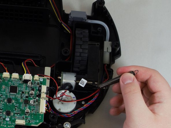

  9. ZCWA BR151 Wheel Replacement: crwdns2935265:09crwdnd2935265:01crwdnd2935265:03crwdne2935265:0 ZCWA BR151 Wheel Replacement: crwdns2935265:09crwdnd2935265:02crwdnd2935265:03crwdne2935265:0 ZCWA BR151 Wheel Replacement: crwdns2935265:09crwdnd2935265:03crwdnd2935265:03crwdne2935265:0
    • Using a Phillips #1 screwdriver, remove the single screw to the spring.
    • Once the spring is unscrewed, slowly pull it towards you, then to the left of the spring bracket to free the spring.

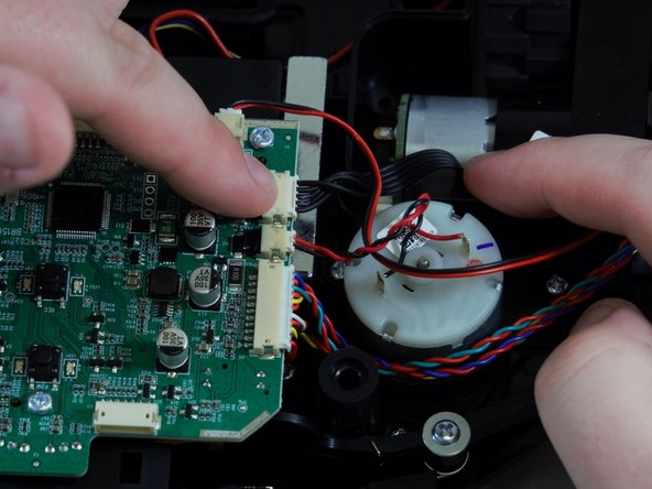

  10. ZCWA BR151 Wheel Replacement: crwdns2935265:010crwdnd2935265:01crwdnd2935265:02crwdne2935265:0 ZCWA BR151 Wheel Replacement: crwdns2935265:010crwdnd2935265:02crwdnd2935265:02crwdne2935265:0
    • The wheel's motor is still attached to the motherboard of the device. Locate the wheel's wiring and the port connector on the motherboard.
    • Pinch the silver brackets and pull the wire casing away from the motherboard.
    • Remove the wheel from the vacuum.
    • Repeat Steps 6-10 to replace the wheel on the opposite side.
