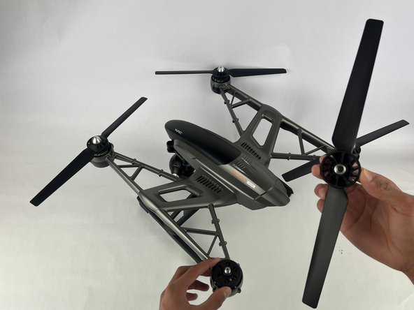

    • Remove the propeller from the side where the motor is not working.
    • You can remove the propeller at any point in the replacement.
  2. Yuneec Typhoon Q500 4K Motor Replacement: crwdns2935265:02crwdnd2935265:01crwdnd2935265:02crwdne2935265:0 Yuneec Typhoon Q500 4K Motor Replacement: crwdns2935265:02crwdnd2935265:02crwdnd2935265:02crwdne2935265:0
    • Grab the motor with one hand and propeller with the other.
    • Turn the propeller counterclockwise to separate the propeller from the drone.

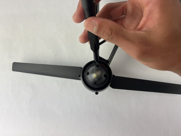

  4. Yuneec Typhoon Q500 4K Motor Replacement: crwdns2935265:04crwdnd2935265:01crwdnd2935265:03crwdne2935265:0 Yuneec Typhoon Q500 4K Motor Replacement: crwdns2935265:04crwdnd2935265:02crwdnd2935265:03crwdne2935265:0 Yuneec Typhoon Q500 4K Motor Replacement: crwdns2935265:04crwdnd2935265:03crwdnd2935265:03crwdne2935265:0
    • Use a Phillips #00 screwdriver and remove the four screws that secure the light cover.

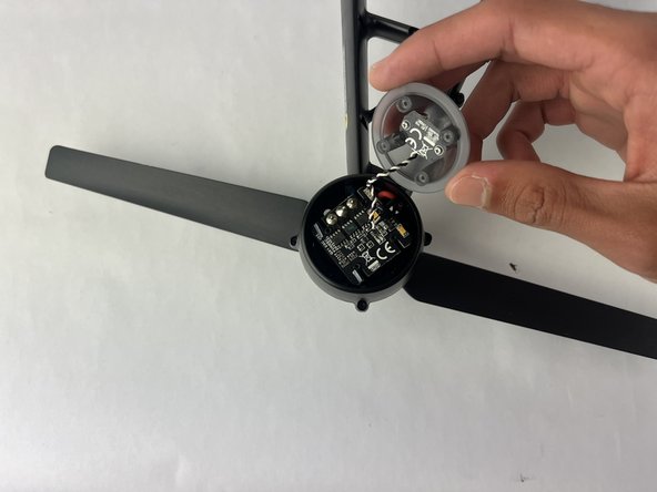

  5. Yuneec Typhoon Q500 4K Motor Replacement: crwdns2935265:05crwdnd2935265:01crwdnd2935265:01crwdne2935265:0
    • Use the plastic opening tool to pry up and out the PCB.

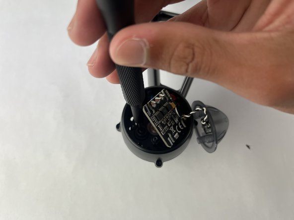

  6. Yuneec Typhoon Q500 4K Motor Replacement: crwdns2935265:06crwdnd2935265:01crwdnd2935265:02crwdne2935265:0 Yuneec Typhoon Q500 4K Motor Replacement: crwdns2935265:06crwdnd2935265:02crwdnd2935265:02crwdne2935265:0
    • Use a 2mm Hex screwdriver to remove the four screws that are located below the PCB.
