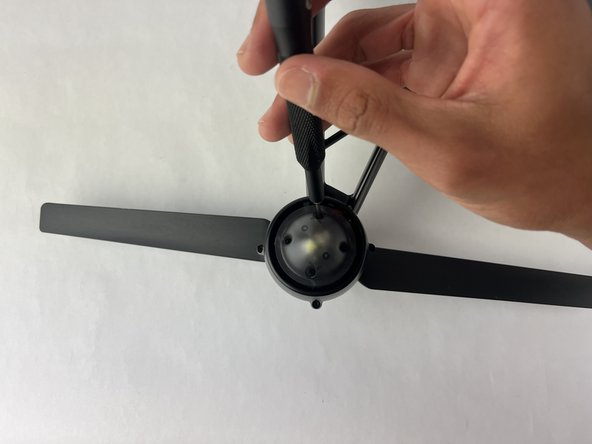

    • Flip the drone upside down.
    • Identify the faulty light that need to be replaced.
  2. Yuneec Typhoon Q500 4K LED Lights Replacement: crwdns2935265:02crwdnd2935265:01crwdnd2935265:02crwdne2935265:0 Yuneec Typhoon Q500 4K LED Lights Replacement: crwdns2935265:02crwdnd2935265:02crwdnd2935265:02crwdne2935265:0
    • Use a Phillips #00 screwdriver to remove the four screws that hold the light cover.
  3. Yuneec Typhoon Q500 4K LED Lights Replacement: crwdns2935265:03crwdnd2935265:01crwdnd2935265:02crwdne2935265:0 Yuneec Typhoon Q500 4K LED Lights Replacement: crwdns2935265:03crwdnd2935265:02crwdnd2935265:02crwdne2935265:0

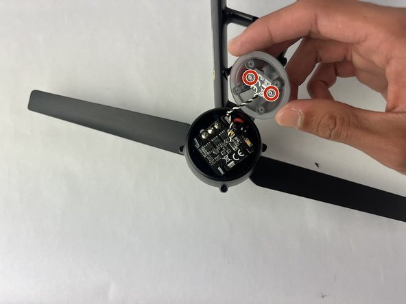

    • Hold the light cover in such a way, so that you can see the LED chip in it.
    • Remove the Phillips screws that holds the chip in place.
  4. Yuneec Typhoon Q500 4K LED Lights Replacement: crwdns2935265:04crwdnd2935265:01crwdnd2935265:01crwdne2935265:0
    • Use a Phillips #00 screwdriver to remove the two screws that hold the LED chip in the cover.
