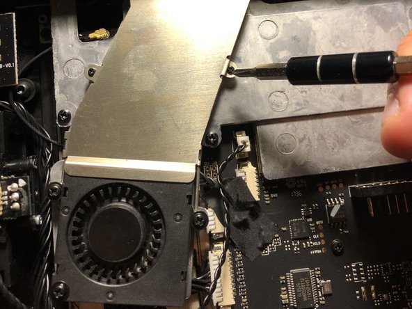

  8. Yuneec ST16S Cooling Fan Replacement, Cooling Fan: crwdns2935265:08crwdnd2935265:01crwdnd2935265:02crwdne2935265:0 Yuneec ST16S Cooling Fan Replacement, Cooling Fan: crwdns2935265:08crwdnd2935265:02crwdnd2935265:02crwdne2935265:0
    • Remove the screws from the metal bracket and around the cooling fan.
  9. Yuneec ST16S Cooling Fan Replacement: crwdns2935265:09crwdnd2935265:01crwdnd2935265:01crwdne2935265:0
    • Unplug the cooling fan from the device.
  10. Yuneec ST16S Cooling Fan Replacement: crwdns2935265:010crwdnd2935265:01crwdnd2935265:01crwdne2935265:0
    • Remove the cooling fan from the device.
