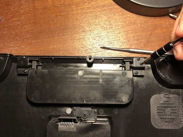

    1. Yuneec ST16S Carrying Handle Replacement, Carrying Handle: crwdns2935265:08crwdnd2935265:01crwdnd2935265:02crwdne2935265:0 Yuneec ST16S Carrying Handle Replacement, Carrying Handle: crwdns2935265:08crwdnd2935265:02crwdnd2935265:02crwdne2935265:0
      • Remove the screws from the clips on both ends of the handle.

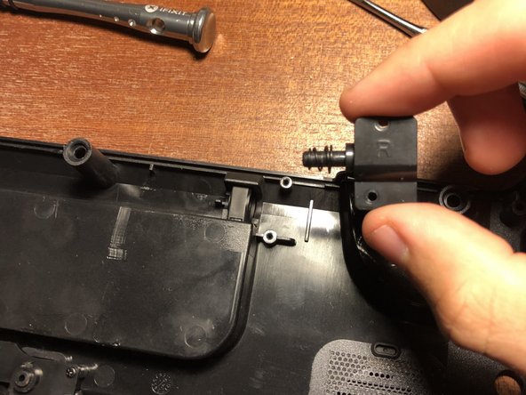

    2. Yuneec ST16S Carrying Handle Replacement: crwdns2935265:09crwdnd2935265:01crwdnd2935265:02crwdne2935265:0 Yuneec ST16S Carrying Handle Replacement: crwdns2935265:09crwdnd2935265:02crwdnd2935265:02crwdne2935265:0
      • Slide the clips away from the handle.
    3. Yuneec ST16S Carrying Handle Replacement: crwdns2935265:010crwdnd2935265:01crwdnd2935265:01crwdne2935265:0
      • Remove the handle from the device.
