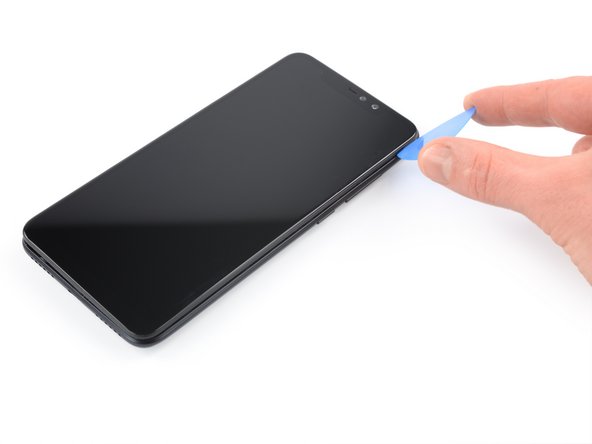

    1. Xiaomi Redmi Note 6 Pro Battery Replacement, Insert an opening pick: crwdns2935265:02crwdnd2935265:01crwdnd2935265:02crwdne2935265:0 Xiaomi Redmi Note 6 Pro Battery Replacement, Insert an opening pick: crwdns2935265:02crwdnd2935265:02crwdnd2935265:02crwdne2935265:0
      • The back cover is held in place by plastic clips.
      • Insert an opening pick between the screen and the back cover on the left edge of the phone where the SIM card tray was located.

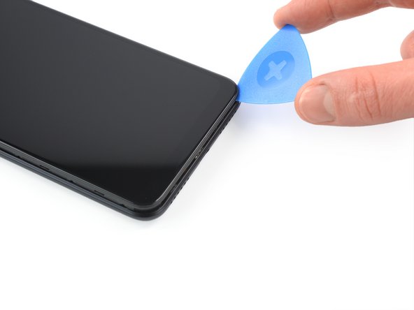

    2. Xiaomi Redmi Note 6 Pro Battery Replacement, Release the plastic clips: crwdns2935265:03crwdnd2935265:01crwdnd2935265:03crwdne2935265:0 Xiaomi Redmi Note 6 Pro Battery Replacement, Release the plastic clips: crwdns2935265:03crwdnd2935265:02crwdnd2935265:03crwdne2935265:0 Xiaomi Redmi Note 6 Pro Battery Replacement, Release the plastic clips: crwdns2935265:03crwdnd2935265:03crwdnd2935265:03crwdne2935265:0
      • Slide the opening pick along the left edge to the bottom left corner to release the plastic clips.
    3. Xiaomi Redmi Note 6 Pro Battery Replacement: crwdns2935265:04crwdnd2935265:01crwdnd2935265:03crwdne2935265:0 Xiaomi Redmi Note 6 Pro Battery Replacement: crwdns2935265:04crwdnd2935265:02crwdnd2935265:03crwdne2935265:0 Xiaomi Redmi Note 6 Pro Battery Replacement: crwdns2935265:04crwdnd2935265:03crwdnd2935265:03crwdne2935265:0
      • Slide the opening pick along the bottom edge to the bottom right corner to release the plastic clips.
    4. Xiaomi Redmi Note 6 Pro Battery Replacement: crwdns2935265:05crwdnd2935265:01crwdnd2935265:03crwdne2935265:0 Xiaomi Redmi Note 6 Pro Battery Replacement: crwdns2935265:05crwdnd2935265:02crwdnd2935265:03crwdne2935265:0 Xiaomi Redmi Note 6 Pro Battery Replacement: crwdns2935265:05crwdnd2935265:03crwdnd2935265:03crwdne2935265:0
      • Slide the opening pick along the right edge of your phone to the top right corner to release the plastic clips.

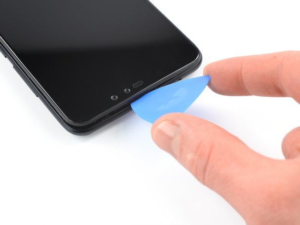

    5. Xiaomi Redmi Note 6 Pro Battery Replacement, Release the remaining plastic clips: crwdns2935265:06crwdnd2935265:01crwdnd2935265:03crwdne2935265:0 Xiaomi Redmi Note 6 Pro Battery Replacement, Release the remaining plastic clips: crwdns2935265:06crwdnd2935265:02crwdnd2935265:03crwdne2935265:0 Xiaomi Redmi Note 6 Pro Battery Replacement, Release the remaining plastic clips: crwdns2935265:06crwdnd2935265:03crwdnd2935265:03crwdne2935265:0
      • Slide the opening pick along the top edge to release the remaining plastic clips.
      • Don't try to remove the back cover all the way yet! It's still connected to the motherboard!

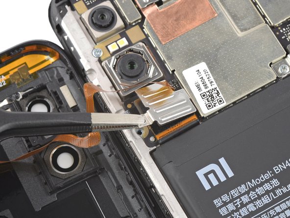

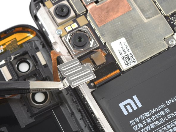

    8. Xiaomi Redmi Note 6 Pro Battery Replacement, Remove the metal cover: crwdns2935265:09crwdnd2935265:01crwdnd2935265:03crwdne2935265:0 Xiaomi Redmi Note 6 Pro Battery Replacement, Remove the metal cover: crwdns2935265:09crwdnd2935265:02crwdnd2935265:03crwdne2935265:0 Xiaomi Redmi Note 6 Pro Battery Replacement, Remove the metal cover: crwdns2935265:09crwdnd2935265:03crwdnd2935265:03crwdne2935265:0
      • Use a pair of blunt nose tweezers to remove the metal cover.

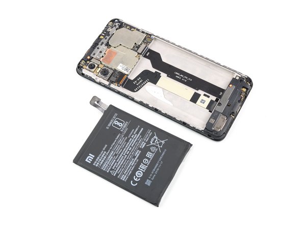

    4. Xiaomi Redmi Note 6 Pro Battery Replacement, Remove the battery: crwdns2935265:018crwdnd2935265:01crwdnd2935265:03crwdne2935265:0 Xiaomi Redmi Note 6 Pro Battery Replacement, Remove the battery: crwdns2935265:018crwdnd2935265:02crwdnd2935265:03crwdne2935265:0 Xiaomi Redmi Note 6 Pro Battery Replacement, Remove the battery: crwdns2935265:018crwdnd2935265:03crwdnd2935265:03crwdne2935265:0
      • Remove the battery.
      • Do not reinstall a damaged or deformed battery, as doing so is a potential safety hazard.
      • Before installing a new battery remove any remaining adhesive, and clean the glued areas with isopropyl alcohol and a lint-free cloth.
      • During reassembly, temporarily reconnect the battery to the motherboard to help align it correctly. Disconnect the battery after it is seated.
