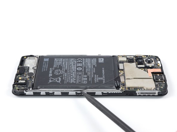

  21. Xiaomi Redmi Note 10S Screen Replacement, Disconnect the battery cable: crwdns2935265:021crwdnd2935265:01crwdnd2935265:02crwdne2935265:0 Xiaomi Redmi Note 10S Screen Replacement, Disconnect the battery cable: crwdns2935265:021crwdnd2935265:02crwdnd2935265:02crwdne2935265:0
    • Use a spudger to disconnect the battery flex cable by prying the connector straight up from its socket.

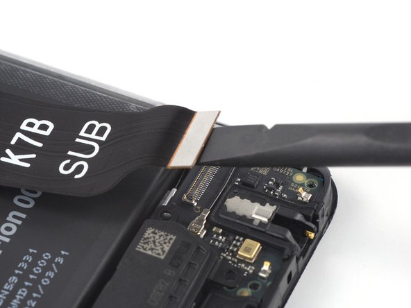

  22. Xiaomi Redmi Note 10S Screen Replacement, Disconnect the daughterboard interconnect cable: crwdns2935265:022crwdnd2935265:01crwdnd2935265:03crwdne2935265:0 Xiaomi Redmi Note 10S Screen Replacement, Disconnect the daughterboard interconnect cable: crwdns2935265:022crwdnd2935265:02crwdnd2935265:03crwdne2935265:0 Xiaomi Redmi Note 10S Screen Replacement, Disconnect the daughterboard interconnect cable: crwdns2935265:022crwdnd2935265:03crwdnd2935265:03crwdne2935265:0
    • Use a spudger to disconnect both ends of the daughterboard interconnect cable.
    • Remove the daughterboard connection cable.

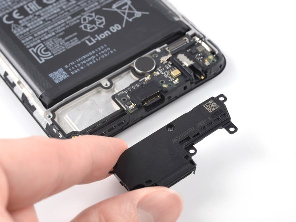

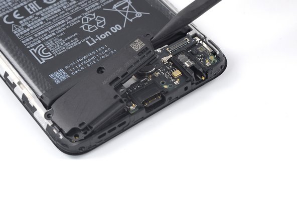

  23. Xiaomi Redmi Note 10S Screen Replacement, Remove the loudspeaker: crwdns2935265:023crwdnd2935265:01crwdnd2935265:03crwdne2935265:0 Xiaomi Redmi Note 10S Screen Replacement, Remove the loudspeaker: crwdns2935265:023crwdnd2935265:02crwdnd2935265:03crwdne2935265:0 Xiaomi Redmi Note 10S Screen Replacement, Remove the loudspeaker: crwdns2935265:023crwdnd2935265:03crwdnd2935265:03crwdne2935265:0
    • Use a spudger on the right top edge to lift up the loudspeaker.
    • Use your fingers or a pair of tweezers to remove the loudspeaker.

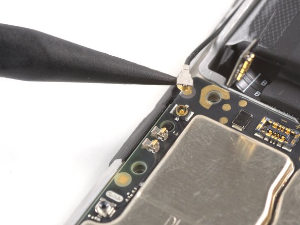

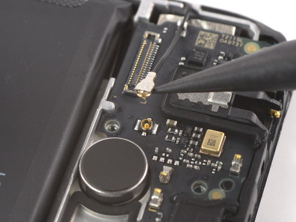

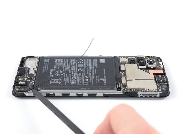

  24. Xiaomi Redmi Note 10S Screen Replacement, Disconnect the antenna cable: crwdns2935265:024crwdnd2935265:01crwdnd2935265:03crwdne2935265:0 Xiaomi Redmi Note 10S Screen Replacement, Disconnect the antenna cable: crwdns2935265:024crwdnd2935265:02crwdnd2935265:03crwdne2935265:0 Xiaomi Redmi Note 10S Screen Replacement, Disconnect the antenna cable: crwdns2935265:024crwdnd2935265:03crwdnd2935265:03crwdne2935265:0
    • Use a spudger to disconnect both ends of the antenna cable by prying the connectors straight up from their sockets.
  25. Xiaomi Redmi Note 10S Screen Replacement, Free the antenna cable: crwdns2935265:025crwdnd2935265:01crwdnd2935265:03crwdne2935265:0 Xiaomi Redmi Note 10S Screen Replacement, Free the antenna cable: crwdns2935265:025crwdnd2935265:02crwdnd2935265:03crwdne2935265:0 Xiaomi Redmi Note 10S Screen Replacement, Free the antenna cable: crwdns2935265:025crwdnd2935265:03crwdnd2935265:03crwdne2935265:0
    • Use a spudger to remove the antenna cable from its recess.
    • Don't release the antenna cable from its clip on the daughterboard. This will make positioning the cable during reassembly easier.

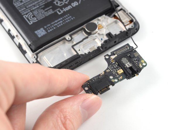

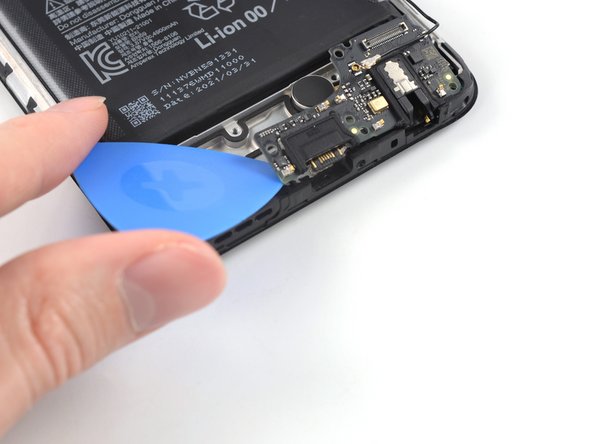

  26. Xiaomi Redmi Note 10S Screen Replacement, Remove the daughterboard: crwdns2935265:026crwdnd2935265:01crwdnd2935265:03crwdne2935265:0 Xiaomi Redmi Note 10S Screen Replacement, Remove the daughterboard: crwdns2935265:026crwdnd2935265:02crwdnd2935265:03crwdne2935265:0 Xiaomi Redmi Note 10S Screen Replacement, Remove the daughterboard: crwdns2935265:026crwdnd2935265:03crwdnd2935265:03crwdne2935265:0
    • Insert an opening pick into the gap between the front panel and the left edge of the daughterboard.
    • Pry up the daughterboard by twisting the opening pick sideways.
    • Use your fingers or a pair of tweezers to remove the daughterboard.

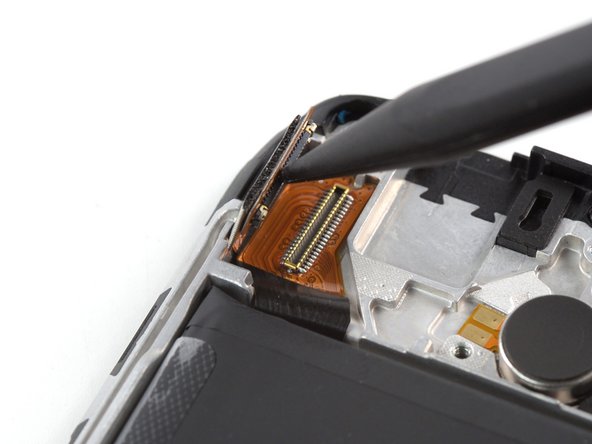

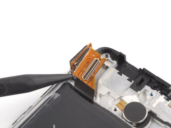

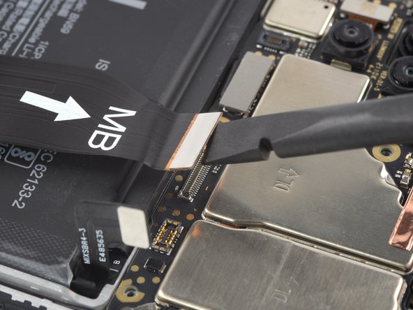

  27. Xiaomi Redmi Note 10S Screen Replacement, Disconnect the display cable: crwdns2935265:027crwdnd2935265:01crwdnd2935265:02crwdne2935265:0 Xiaomi Redmi Note 10S Screen Replacement, Disconnect the display cable: crwdns2935265:027crwdnd2935265:02crwdnd2935265:02crwdne2935265:0
    • Use a spudger to disconnect the display cable by prying the connector straight up from its socket.
  28. Xiaomi Redmi Note 10S Screen Replacement, Free the display cable: crwdns2935265:028crwdnd2935265:01crwdnd2935265:02crwdne2935265:0 Xiaomi Redmi Note 10S Screen Replacement, Free the display cable: crwdns2935265:028crwdnd2935265:02crwdnd2935265:02crwdne2935265:0
    • Insert a spudger into the opening on the bottom left of the display interconnect cable.
    • Use the spudger to pry up the display interconnect cable to free the display cable.

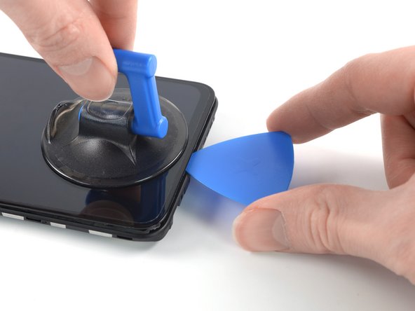

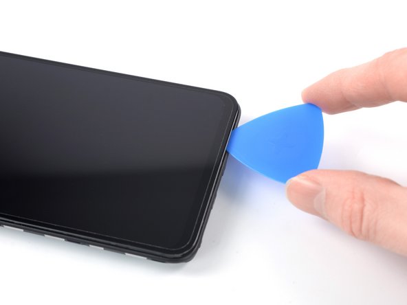

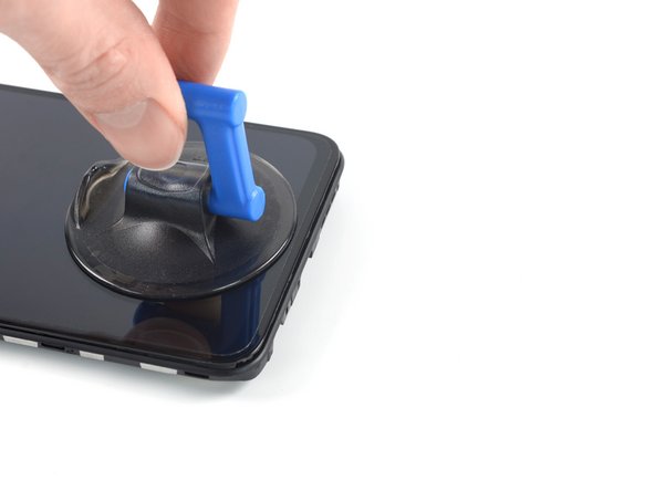

  30. Xiaomi Redmi Note 10S Screen Replacement, Insert an opening pick: crwdns2935265:030crwdnd2935265:01crwdnd2935265:03crwdne2935265:0 Xiaomi Redmi Note 10S Screen Replacement, Insert an opening pick: crwdns2935265:030crwdnd2935265:02crwdnd2935265:03crwdne2935265:0 Xiaomi Redmi Note 10S Screen Replacement, Insert an opening pick: crwdns2935265:030crwdnd2935265:03crwdnd2935265:03crwdne2935265:0
    • Apply a suction handle to the bottom of the screen.
    • If your display is badly cracked, covering it with a layer of clear packing tape may allow the suction cup to adhere. Alternatively, very strong tape may be used instead of the suction cup. If all else fails, you can superglue the suction cup to the broken screen.
    • Pull the suction cup up with strong, steady force to create a gap.
    • Insert an opening pick into the gap.

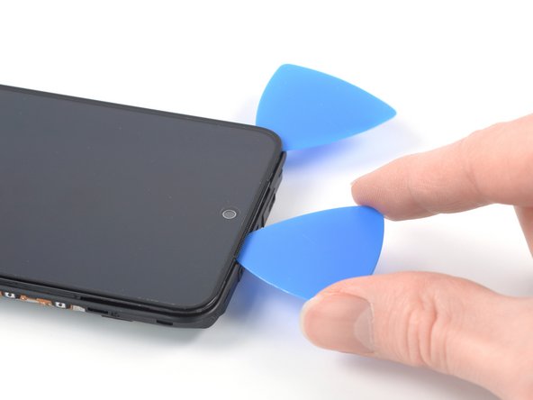

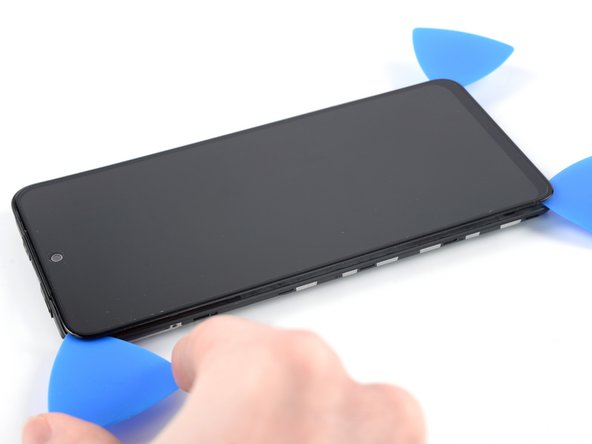

  31. Xiaomi Redmi Note 10S Screen Replacement, Slice the adhesive: crwdns2935265:031crwdnd2935265:01crwdnd2935265:03crwdne2935265:0 Xiaomi Redmi Note 10S Screen Replacement, Slice the adhesive: crwdns2935265:031crwdnd2935265:02crwdnd2935265:03crwdne2935265:0 Xiaomi Redmi Note 10S Screen Replacement, Slice the adhesive: crwdns2935265:031crwdnd2935265:03crwdnd2935265:03crwdne2935265:0
    • Slide the opening pick to the bottom right corner of the screen to slice the adhesive.
    • Leave the opening pick in place to prevent the adhesive from resealing.
  32. Xiaomi Redmi Note 10S Screen Replacement: crwdns2935265:032crwdnd2935265:01crwdnd2935265:03crwdne2935265:0 Xiaomi Redmi Note 10S Screen Replacement: crwdns2935265:032crwdnd2935265:02crwdnd2935265:03crwdne2935265:0 Xiaomi Redmi Note 10S Screen Replacement: crwdns2935265:032crwdnd2935265:03crwdnd2935265:03crwdne2935265:0
    • When you slice near the display cable, insert only the tip of the opening pick (about 2–3 mm) to avoid damaging the cable.
    • Insert a second opening pick at the bottom right corner and slide it to the bottom left corner of the screen to slice the adhesive.

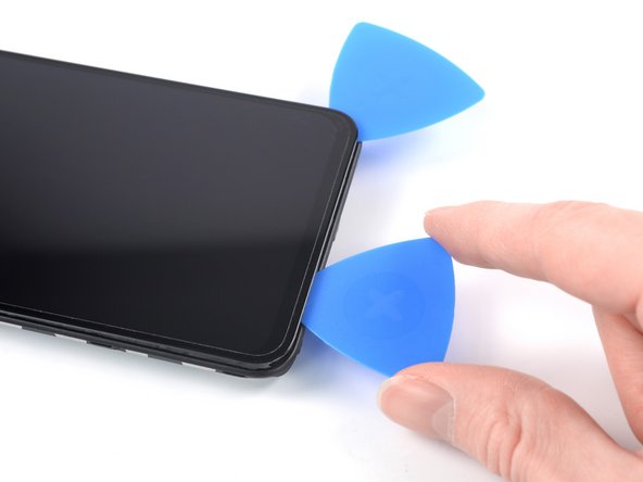

  33. Xiaomi Redmi Note 10S Screen Replacement: crwdns2935265:033crwdnd2935265:01crwdnd2935265:03crwdne2935265:0 Xiaomi Redmi Note 10S Screen Replacement: crwdns2935265:033crwdnd2935265:02crwdnd2935265:03crwdne2935265:0 Xiaomi Redmi Note 10S Screen Replacement: crwdns2935265:033crwdnd2935265:03crwdnd2935265:03crwdne2935265:0
    • If the adhesive becomes hard to cut, it has most likely cooled down. Use your iOpener or heat gun for 1–2 minutes to reheat it.

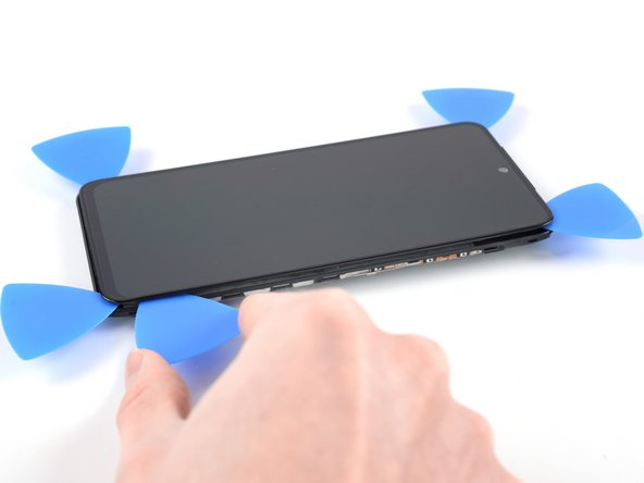

    • Insert a third opening pick underneath the bottom left corner of the screen.
    • Slide the opening pick along the left edge of the screen to slice the adhesive.
    • Leave it in the top left corner to prevent the adhesive from resealing.

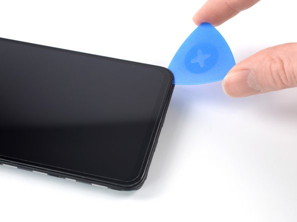

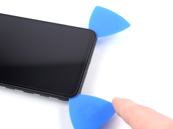

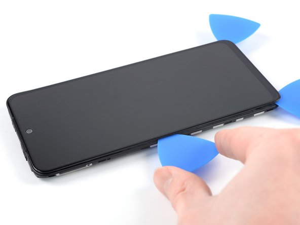

  34. Xiaomi Redmi Note 10S Screen Replacement: crwdns2935265:034crwdnd2935265:01crwdnd2935265:03crwdne2935265:0 Xiaomi Redmi Note 10S Screen Replacement: crwdns2935265:034crwdnd2935265:02crwdnd2935265:03crwdne2935265:0 Xiaomi Redmi Note 10S Screen Replacement: crwdns2935265:034crwdnd2935265:03crwdnd2935265:03crwdne2935265:0
    • When you slice near the front facing camera, insert only the tip of the opening pick (about 2–3 mm) to avoid damaging or smearing the camera.
    • Insert a fourth opening pick at the top left corner of the screen.

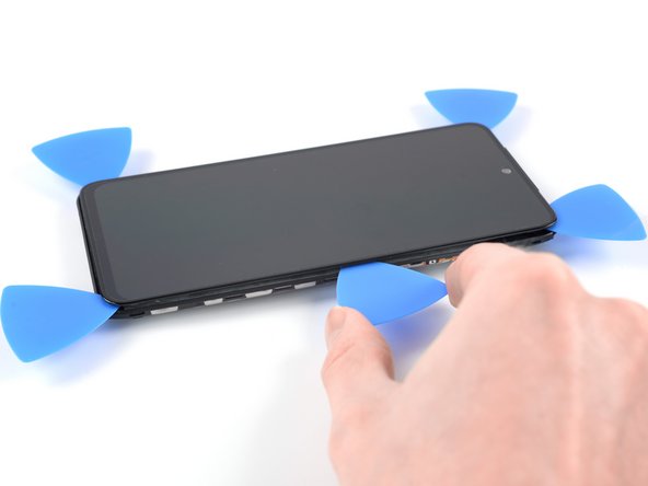

    • Slide the opening pick along the top edge of the phone to slice the adhesive.

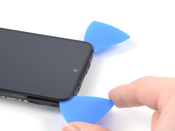

  35. Xiaomi Redmi Note 10S Screen Replacement: crwdns2935265:035crwdnd2935265:01crwdnd2935265:03crwdne2935265:0 Xiaomi Redmi Note 10S Screen Replacement: crwdns2935265:035crwdnd2935265:02crwdnd2935265:03crwdne2935265:0 Xiaomi Redmi Note 10S Screen Replacement: crwdns2935265:035crwdnd2935265:03crwdnd2935265:03crwdne2935265:0
    • Insert a fifth opening pick and slide it along the right edge of the phone to slice the remaining adhesive.
    • Don't try to remove the display all the way yet, the display cable is still threaded through the front panel assembly.

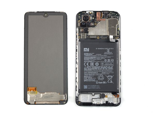

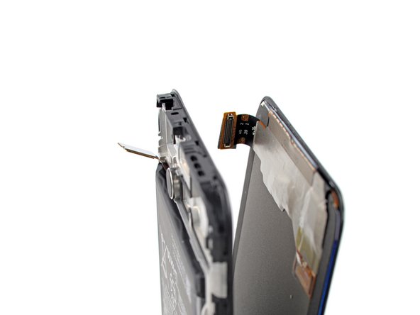

  36. Xiaomi Redmi Note 10S Screen Replacement, Remove the screen: crwdns2935265:036crwdnd2935265:01crwdnd2935265:03crwdne2935265:0 Xiaomi Redmi Note 10S Screen Replacement, Remove the screen: crwdns2935265:036crwdnd2935265:02crwdnd2935265:03crwdne2935265:0 Xiaomi Redmi Note 10S Screen Replacement, Remove the screen: crwdns2935265:036crwdnd2935265:03crwdnd2935265:03crwdne2935265:0
    • Thread the display flex cable through the gap in the front panel assembly.
    • If your screen is still sticking to the frame, slide the pick around the edges of the phone until the screen completely separates.
    • Remove the screen.
If possible, turn on your device and test your repair before installing new adhesive and resealing.
Compare your new replacement part to the original part—you may need to transfer remaining components or remove adhesive backings from the new part before you install it.The best way to secure the new screen is to apply a sheet of custom-cut double-sided tape to the back of the screen.
To reassemble your device, follow these instructions in reverse order. Apply new adhesive where necessary after cleaning the relevant areas with isopropyl alcohol (>90%).
