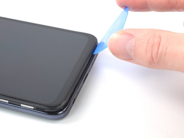

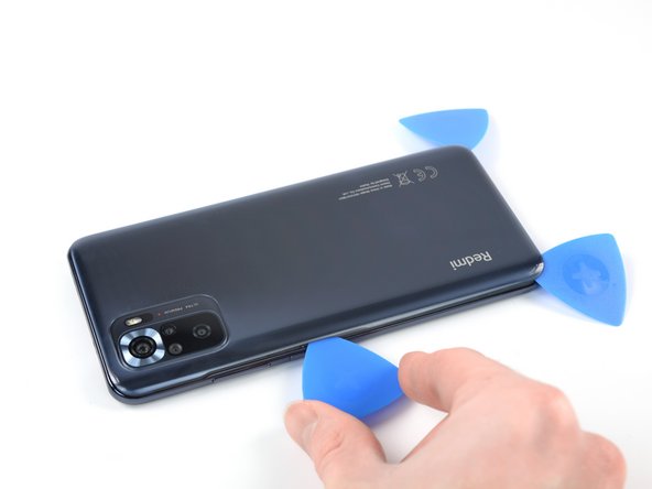

  2. Xiaomi Redmi Note 10S Battery Replacement, Insert an opening pick: crwdns2935265:02crwdnd2935265:01crwdnd2935265:03crwdne2935265:0 Xiaomi Redmi Note 10S Battery Replacement, Insert an opening pick: crwdns2935265:02crwdnd2935265:02crwdnd2935265:03crwdne2935265:0 Xiaomi Redmi Note 10S Battery Replacement, Insert an opening pick: crwdns2935265:02crwdnd2935265:03crwdnd2935265:03crwdne2935265:0
    • Secure a suction handle to the bottom edge of the back cover, as close to the edge as possible.
    • Lift the back cover with the suction handle to create a small gap between the back cover and the frame.
    • If you have trouble creating a gap, apply more heat to further soften the adhesive. Follow the iOpener instructions to avoid overheating.
    • Insert an opening pick into the gap you created.

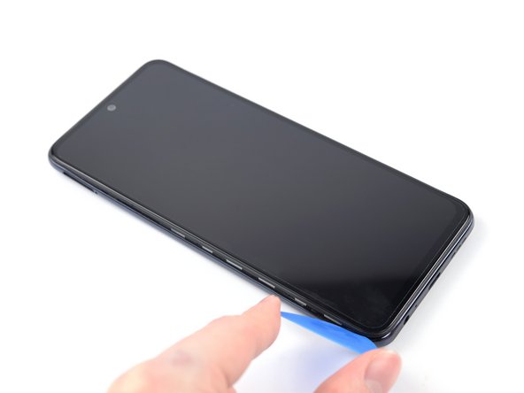

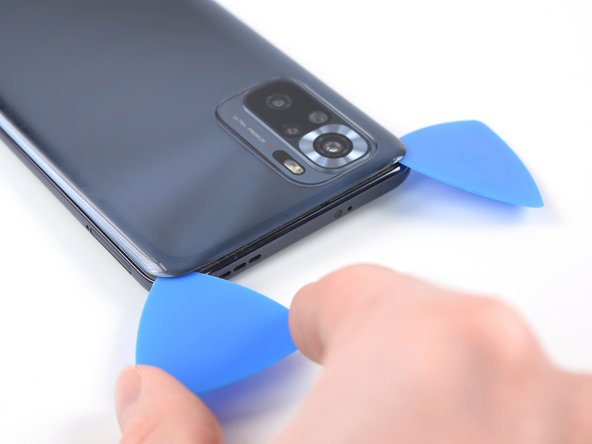

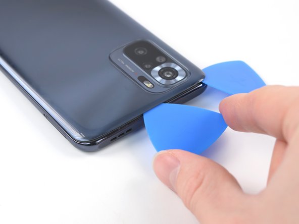

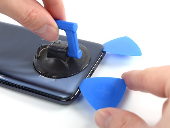

  3. Xiaomi Redmi Note 10S Battery Replacement, Slice the adhesive: crwdns2935265:03crwdnd2935265:01crwdnd2935265:02crwdne2935265:0 Xiaomi Redmi Note 10S Battery Replacement, Slice the adhesive: crwdns2935265:03crwdnd2935265:02crwdnd2935265:02crwdne2935265:0
    • Slide the opening pick to the bottom right corner to slice the adhesive.
    • Leave the opening pick in place to prevent the adhesive from resealing.

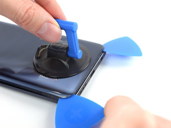

  4. Xiaomi Redmi Note 10S Battery Replacement, Slice the adhesive: crwdns2935265:04crwdnd2935265:01crwdnd2935265:03crwdne2935265:0 Xiaomi Redmi Note 10S Battery Replacement, Slice the adhesive: crwdns2935265:04crwdnd2935265:02crwdnd2935265:03crwdne2935265:0 Xiaomi Redmi Note 10S Battery Replacement, Slice the adhesive: crwdns2935265:04crwdnd2935265:03crwdnd2935265:03crwdne2935265:0
    • Insert a second opening pick at the bottom edge of your phone.
    • Slide the opening pick to the bottom left corner to slice the adhesive.
    • Leave the opening picks in place to prevent the adhesive from resealing.
    • You can remove the suction cup now.

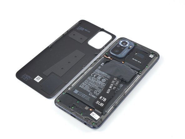

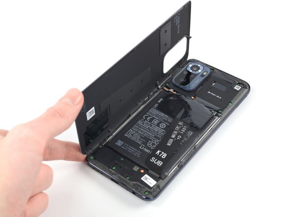

  8. Xiaomi Redmi Note 10S Battery Replacement, Remove the back cover: crwdns2935265:08crwdnd2935265:01crwdnd2935265:03crwdne2935265:0 Xiaomi Redmi Note 10S Battery Replacement, Remove the back cover: crwdns2935265:08crwdnd2935265:02crwdnd2935265:03crwdne2935265:0 Xiaomi Redmi Note 10S Battery Replacement, Remove the back cover: crwdns2935265:08crwdnd2935265:03crwdnd2935265:03crwdne2935265:0
    • Remove the back cover.
    • Apply new adhesive where necessary after cleaning the relevant areas with isopropyl alcohol (>90%).
    • Secure the new back cover with pre-cut adhesive or double-sided adhesive tape. After installing the back cover, apply strong, steady pressure to your phone for several minutes to help the adhesive form a good bond—a stack of heavy books works well.

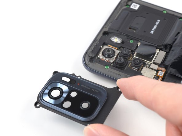

  11. Xiaomi Redmi Note 10S Battery Replacement, Remove the camera cover: crwdns2935265:011crwdnd2935265:01crwdnd2935265:02crwdne2935265:0 Xiaomi Redmi Note 10S Battery Replacement, Remove the camera cover: crwdns2935265:011crwdnd2935265:02crwdnd2935265:02crwdne2935265:0
    • Use your fingers or a pair of tweezers to remove the camera cover.

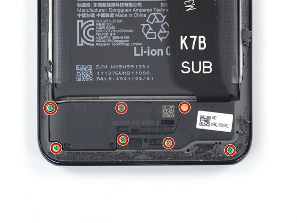

  12. Xiaomi Redmi Note 10S Battery Replacement, Unfasten the midframe screws: crwdns2935265:012crwdnd2935265:01crwdnd2935265:02crwdne2935265:0 Xiaomi Redmi Note 10S Battery Replacement, Unfasten the midframe screws: crwdns2935265:012crwdnd2935265:02crwdnd2935265:02crwdne2935265:0
    • Use a Phillips screwdriver to remove the twelve 3.9 mm-long screws securing the midframe.
    • One of the screws is hidden beneath an orange sticker.

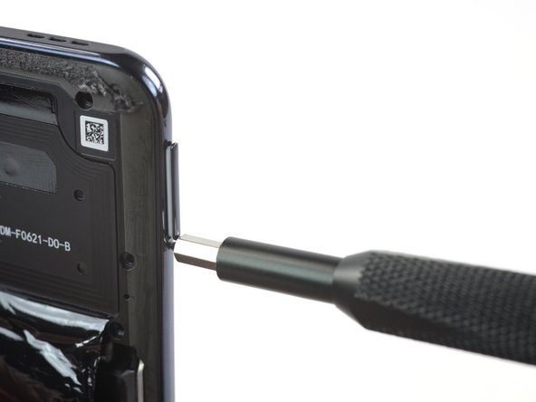

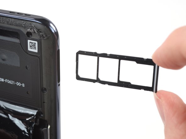

  13. Xiaomi Redmi Note 10S Battery Replacement, Eject the SIM card tray: crwdns2935265:013crwdnd2935265:01crwdnd2935265:03crwdne2935265:0 Xiaomi Redmi Note 10S Battery Replacement, Eject the SIM card tray: crwdns2935265:013crwdnd2935265:02crwdnd2935265:03crwdne2935265:0 Xiaomi Redmi Note 10S Battery Replacement, Eject the SIM card tray: crwdns2935265:013crwdnd2935265:03crwdnd2935265:03crwdne2935265:0
    • Insert a SIM card eject tool into the small hole in the SIM card tray, located at the left edge of the phone.
    • Press directly into the hole to eject the SIM card tray.
    • Remove the SIM card tray.

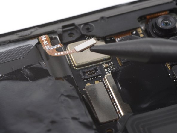

  14. Xiaomi Redmi Note 10S Battery Replacement, Disconnect the power and volume button flex cable: crwdns2935265:014crwdnd2935265:01crwdnd2935265:02crwdne2935265:0 Xiaomi Redmi Note 10S Battery Replacement, Disconnect the power and volume button flex cable: crwdns2935265:014crwdnd2935265:02crwdnd2935265:02crwdne2935265:0
    • Use a spudger to disconnect the power and volume button flex cable by prying the connector straight up from its socket.

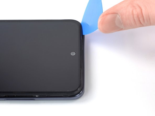

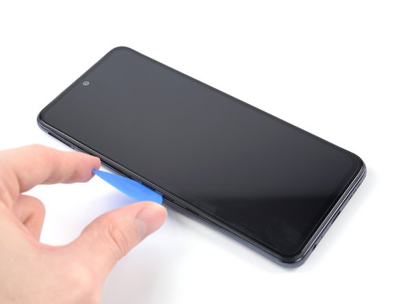

  15. Xiaomi Redmi Note 10S Battery Replacement, Insert an opening pick: crwdns2935265:015crwdnd2935265:01crwdnd2935265:02crwdne2935265:0 Xiaomi Redmi Note 10S Battery Replacement, Insert an opening pick: crwdns2935265:015crwdnd2935265:02crwdnd2935265:02crwdne2935265:0
    • The midframe of the Xiaomi Redmi Note 10S is held in place by plastic clips.
    • Insert an opening pick between the midframe and display assembly on the left edge of the phone where the SIM tray slot is located.
    • Make sure to insert the opening pick between the midframe and the display frame to avoid separating the screen from the frame.

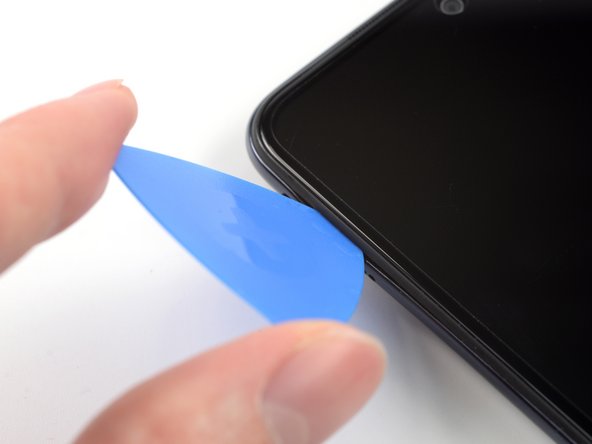

  16. Xiaomi Redmi Note 10S Battery Replacement, Release the plastic clips: crwdns2935265:016crwdnd2935265:01crwdnd2935265:03crwdne2935265:0 Xiaomi Redmi Note 10S Battery Replacement, Release the plastic clips: crwdns2935265:016crwdnd2935265:02crwdnd2935265:03crwdne2935265:0 Xiaomi Redmi Note 10S Battery Replacement, Release the plastic clips: crwdns2935265:016crwdnd2935265:03crwdnd2935265:03crwdne2935265:0
    • The plastic clips of the midframe are sitting in place tightly. Releasing them might require some force.
    • Slide the opening pick along the left edge of the phone to release the plastic clips.

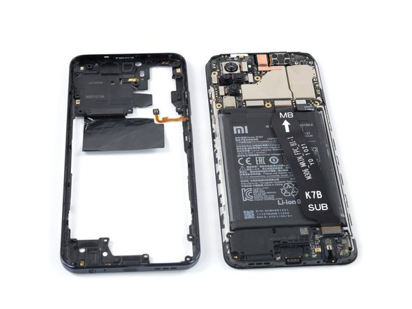

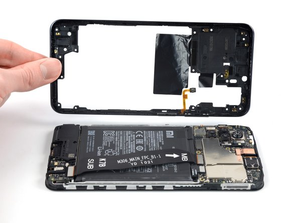

  20. Xiaomi Redmi Note 10S Battery Replacement, Remove the midframe: crwdns2935265:020crwdnd2935265:01crwdnd2935265:03crwdne2935265:0 Xiaomi Redmi Note 10S Battery Replacement, Remove the midframe: crwdns2935265:020crwdnd2935265:02crwdnd2935265:03crwdne2935265:0 Xiaomi Redmi Note 10S Battery Replacement, Remove the midframe: crwdns2935265:020crwdnd2935265:03crwdnd2935265:03crwdne2935265:0
    • Before removing the midframe make sure the power and volume button flex cable is freed and not tangled with the motherboard to avoid tearing it.
    • Remove the midframe.

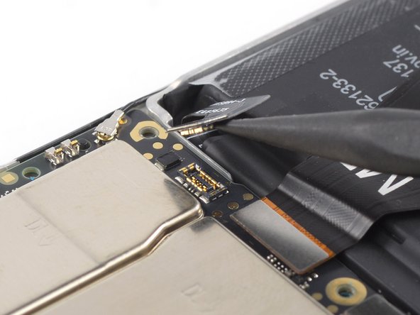

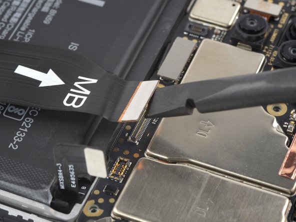

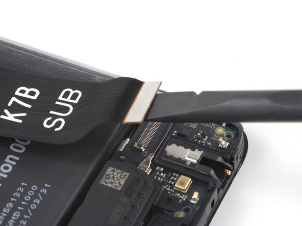

  21. Xiaomi Redmi Note 10S Battery Replacement, Disconnect the battery cable: crwdns2935265:021crwdnd2935265:01crwdnd2935265:02crwdne2935265:0 Xiaomi Redmi Note 10S Battery Replacement, Disconnect the battery cable: crwdns2935265:021crwdnd2935265:02crwdnd2935265:02crwdne2935265:0
    • Use a spudger to disconnect the battery flex cable by prying the connector straight up from its socket.

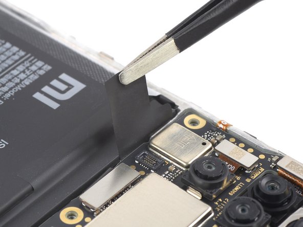

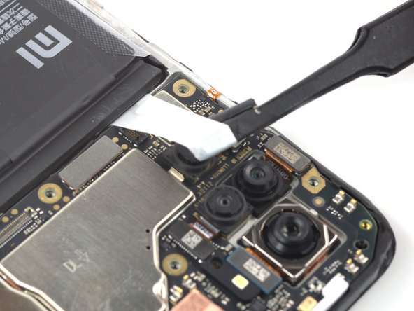

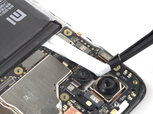

  23. Xiaomi Redmi Note 10S Battery Replacement, Peel off the pull-tabs: crwdns2935265:023crwdnd2935265:01crwdnd2935265:03crwdne2935265:0 Xiaomi Redmi Note 10S Battery Replacement, Peel off the pull-tabs: crwdns2935265:023crwdnd2935265:02crwdnd2935265:03crwdne2935265:0 Xiaomi Redmi Note 10S Battery Replacement, Peel off the pull-tabs: crwdns2935265:023crwdnd2935265:03crwdnd2935265:03crwdne2935265:0
    • The battery is secured to the rear case with two pieces of stretch-release adhesive.
    • Don't jab the battery with any sharp tools. A punctured battery may leak dangerous chemicals or catch fire.
    • Use a pair of blunt nose tweezers or a clean fingernail to peel off both battery adhesive pull-tabs to unstick them from the top edge of the battery.
  24. Xiaomi Redmi Note 10S Battery Replacement, Remove the pull-tab: crwdns2935265:024crwdnd2935265:01crwdnd2935265:03crwdne2935265:0 Xiaomi Redmi Note 10S Battery Replacement, Remove the pull-tab: crwdns2935265:024crwdnd2935265:02crwdnd2935265:03crwdne2935265:0 Xiaomi Redmi Note 10S Battery Replacement, Remove the pull-tab: crwdns2935265:024crwdnd2935265:03crwdnd2935265:03crwdne2935265:0
    • Grab the first pull-tab with a pair of blunt nose tweezers or your fingers and slowly pull it away from the battery towards the top edge of your phone.
    • Pull hard enough to maintain tension on the strip, but don't force it. Give it plenty of time to stretch and unstick from under the battery.
    • Don't press down on the battery. Hold the phone firmly by its sides.
    • Keep the strip flat and unwrinkled. Try to pull evenly on the whole strip, rather than pulling in the middle or on one side.
    • Pull at a low angle so the strip doesn't snag on the edge of the battery.
    • If the adhesive strip breaks off, try to retrieve it using your fingers or blunt tweezers, and continue pulling—but do not pry under the battery.
    • If the adhesive breaks off underneath the battery and can't be retrieved, continue with the next step.

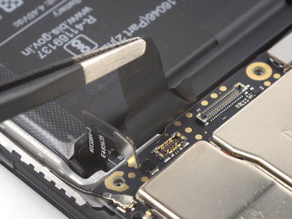

  25. Xiaomi Redmi Note 10S Battery Replacement: crwdns2935265:025crwdnd2935265:01crwdnd2935265:03crwdne2935265:0 Xiaomi Redmi Note 10S Battery Replacement: crwdns2935265:025crwdnd2935265:02crwdnd2935265:03crwdne2935265:0 Xiaomi Redmi Note 10S Battery Replacement: crwdns2935265:025crwdnd2935265:03crwdnd2935265:03crwdne2935265:0
    • Repeat the previous pull-tab removal procedure on the second pull-tab.
    • Follow the same procedure as with the previous strip: don't press down on the battery, keep the strip flat and unwrinkled, and pull at a low angle.
    • If the adhesive breaks off underneath the battery and can't be retrieved, apply a few drops of high concentration (over 90%) isopropyl alcohol under the edge of the battery in the area of the broken adhesive strip(s).
    • Wait about one minute for the alcohol solution to weaken the adhesive.
    • Use the flat end of a spudger to gently lift the battery.
    • Don't try to forcefully lever the battery out. If needed, apply a few more drops of alcohol to further weaken the adhesive. Never deform or puncture the battery with your pry tool.
