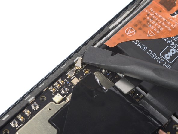

  15. Xiaomi Poco F3 Loudspeaker Replacement, Disconnect the antenna cable: crwdns2935265:015crwdnd2935265:01crwdnd2935265:02crwdne2935265:0 Xiaomi Poco F3 Loudspeaker Replacement, Disconnect the antenna cable: crwdns2935265:015crwdnd2935265:02crwdnd2935265:02crwdne2935265:0
    • Use a spudger to pry up and disconnect the black antenna cable from the motherboard.
    • During reassembly, these can be tricky to reconnect. Hold the connector in place over its socket and press down with the flat end of a spudger. The connector should snap into place.
