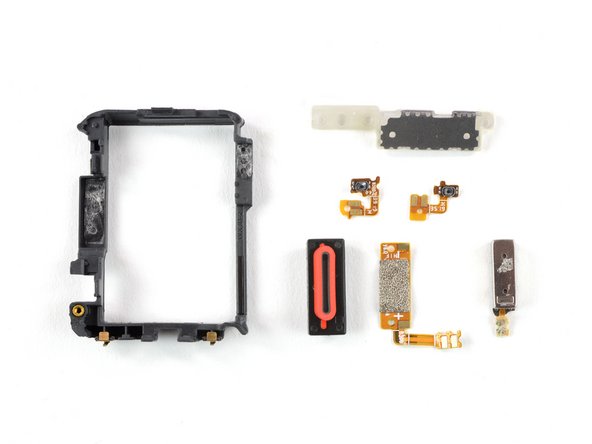

    • The midframe carries the speaker with its red rubber gasket, buttons for the crown and home button, as well as a small linear resonant actuator.
    • Again, compared with the Taptic Engine from the Apple Watch, this LRA is only a fraction of the size. What does that mean in terms of vibration force—what’d be their score on a Richter scale?
    • Turning the digital crown on the Mi Watch does prompt small, haptic steps—so Xiaomi certainly seems to be trying to make the most of this relatively small actuator.
    • But more than anything else, this comparison shows how much importance Apple places on that relatively enormous Taptic Engine—trading a lot of battery life for more communicative haptic feedback.
