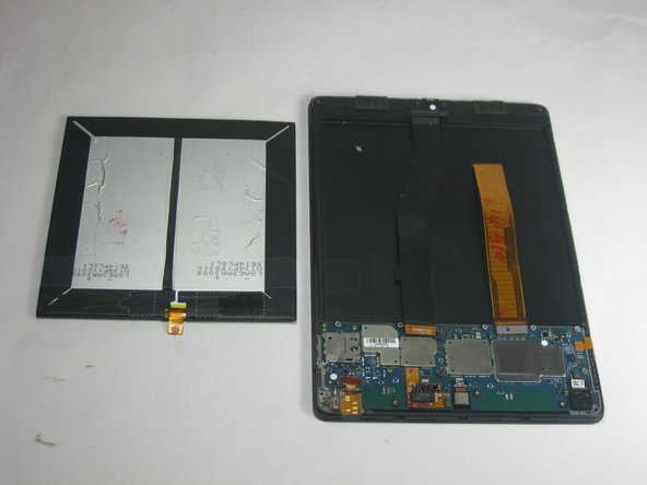

  6. Xiaomi Mi Pad Battery Replacement: crwdns2935265:06crwdnd2935265:01crwdnd2935265:01crwdne2935265:0
    • Carefully pry around the perimeter of the battery with a plastic opening tool to loosen the adhesive securing the battery to the device.
    • Be gentle when removing the battery, as lithium-ion batteries should not be bent or punctured.
  7. Xiaomi Mi Pad Battery Replacement: crwdns2935265:07crwdnd2935265:01crwdnd2935265:03crwdne2935265:0 Xiaomi Mi Pad Battery Replacement: crwdns2935265:07crwdnd2935265:02crwdnd2935265:03crwdne2935265:0 Xiaomi Mi Pad Battery Replacement: crwdns2935265:07crwdnd2935265:03crwdnd2935265:03crwdne2935265:0
    • If you disconnected all three connectors, the charging port ribbon cable may have a small amount of adhesive securing it to the battery. Gently pry the cable free of the battery and lift the battery up and out of the device.
