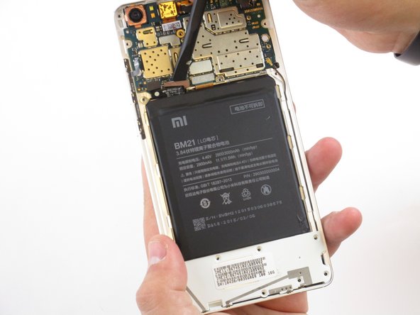

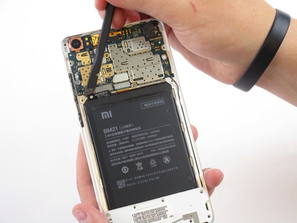

    • Use a nylon spudger to pry upwards to detach the ribbon that's connecting the battery to the motherboard.
  6. Xiaomi Mi Note Screen Replacement: crwdns2935265:06crwdnd2935265:01crwdnd2935265:02crwdne2935265:0 Xiaomi Mi Note Screen Replacement: crwdns2935265:06crwdnd2935265:02crwdnd2935265:02crwdne2935265:0
    • Insert a nylon or metal spudger underneath the battery at any point. Then slide the spudger around all the edges to loosen it. The battery can now be easily lifted out of the frame.
    • Glue will be holding down the backside of the battery.

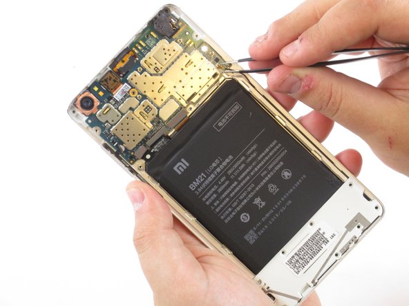

  7. Xiaomi Mi Note Screen Replacement, Screen: crwdns2935265:07crwdnd2935265:01crwdnd2935265:03crwdne2935265:0 Xiaomi Mi Note Screen Replacement, Screen: crwdns2935265:07crwdnd2935265:02crwdnd2935265:03crwdne2935265:0 Xiaomi Mi Note Screen Replacement, Screen: crwdns2935265:07crwdnd2935265:03crwdnd2935265:03crwdne2935265:0
    • Use a spudger to detach the ribbons connected to the motherboard using an upward prying motion.

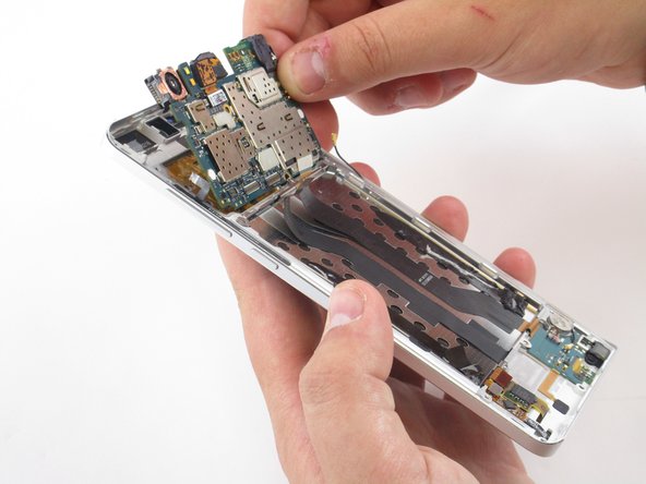

  9. Xiaomi Mi Note Screen Replacement: crwdns2935265:09crwdnd2935265:01crwdnd2935265:02crwdne2935265:0 Xiaomi Mi Note Screen Replacement: crwdns2935265:09crwdnd2935265:02crwdnd2935265:02crwdne2935265:0
    • Use a tweezer to lift and remove the motherboard from the frame.
    • Be sure that the Dual SIM card and tray has been removed.

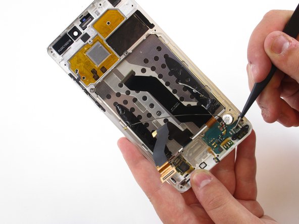

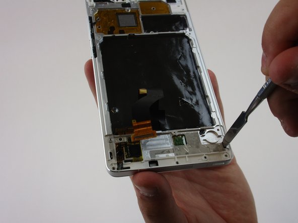

  10. Xiaomi Mi Note Screen Replacement: crwdns2935265:010crwdnd2935265:01crwdnd2935265:01crwdne2935265:0
    • Peel back the ribbon that is adhered to the metal surface as shown.

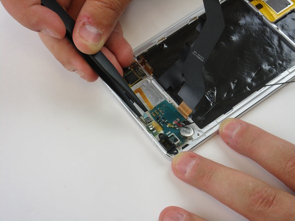

  11. Xiaomi Mi Note Screen Replacement: crwdns2935265:011crwdnd2935265:01crwdnd2935265:03crwdne2935265:0 Xiaomi Mi Note Screen Replacement: crwdns2935265:011crwdnd2935265:02crwdnd2935265:03crwdne2935265:0 Xiaomi Mi Note Screen Replacement: crwdns2935265:011crwdnd2935265:03crwdnd2935265:03crwdne2935265:0
    • The dock connector is firmly adhered to the frame below it. To prevent damage to the phone use minimal force when removing.
    • Using tweezers slowly start prying upwards at the locations shown in the images. After carefully prying around the edges of the dock connector, it can now lifted upwards out of the frame.

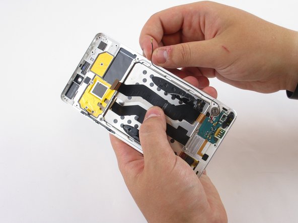

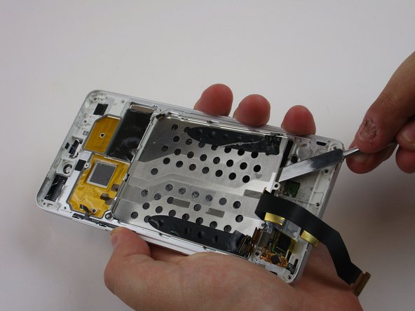

  12. Xiaomi Mi Note Screen Replacement: crwdns2935265:012crwdnd2935265:01crwdnd2935265:02crwdne2935265:0 Xiaomi Mi Note Screen Replacement: crwdns2935265:012crwdnd2935265:02crwdnd2935265:02crwdne2935265:0
    • Using a spudger detach the top two ribbons that connect the screen to the touch sensor and motherboard using an upwards prying motion.
  13. Xiaomi Mi Note Screen Replacement: crwdns2935265:013crwdnd2935265:01crwdnd2935265:02crwdne2935265:0 Xiaomi Mi Note Screen Replacement: crwdns2935265:013crwdnd2935265:02crwdnd2935265:02crwdne2935265:0
    • Using tweezers lift the two remaining ribbons from the bottom frame by grasping the ribbons at any point and lifting towards the bottom of the frame.
    • The ribbons should now be able to freely slide through the respective slits once the screen is lose enough to pull away from the frame for later.

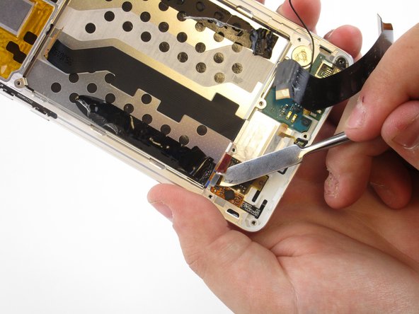

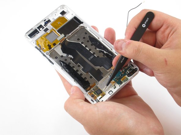

  14. Xiaomi Mi Note Screen Replacement: crwdns2935265:014crwdnd2935265:01crwdnd2935265:02crwdne2935265:0 Xiaomi Mi Note Screen Replacement: crwdns2935265:014crwdnd2935265:02crwdnd2935265:02crwdne2935265:0
    • Peel back the ribbon attached to the back metal frame.
    • Use your spudger at any point to get underneath the metal frame. Slide the spudger around the sides of the metal to free it from the frame.
    • Small amounts of adhesive are holding the metal frame in place.

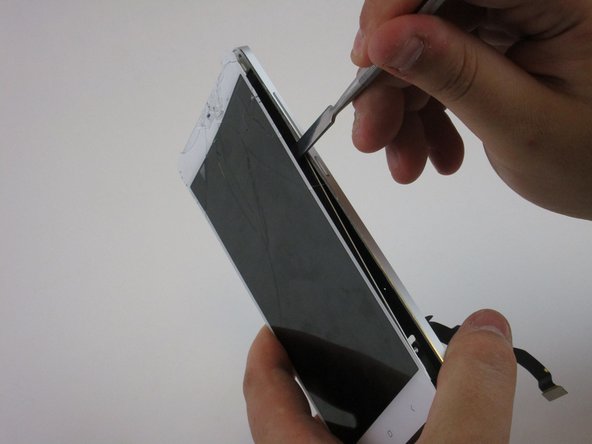

  15. Xiaomi Mi Note Screen Replacement: crwdns2935265:015crwdnd2935265:01crwdnd2935265:03crwdne2935265:0 Xiaomi Mi Note Screen Replacement: crwdns2935265:015crwdnd2935265:02crwdnd2935265:03crwdne2935265:0 Xiaomi Mi Note Screen Replacement: crwdns2935265:015crwdnd2935265:03crwdnd2935265:03crwdne2935265:0
    • Apply considerable force to the back corners using your spudger to help relieve it of the adhesive as shown.
    • Once you have freed the screen from a portion of the adhesive, wedge your spudger around the front edge to work around the edges of the screen and frame in order to fully remove it from the frame.
    • Be aware that the glass screen will break during this process. Be careful not to cut yourself while preforming this step.
