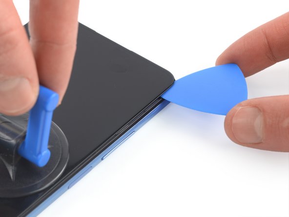

  3. Xiaomi Mi 11 Lite Screen Replacement, Create a gap: crwdns2935265:03crwdnd2935265:01crwdnd2935265:03crwdne2935265:0 Xiaomi Mi 11 Lite Screen Replacement, Create a gap: crwdns2935265:03crwdnd2935265:02crwdnd2935265:03crwdne2935265:0 Xiaomi Mi 11 Lite Screen Replacement, Create a gap: crwdns2935265:03crwdnd2935265:03crwdnd2935265:03crwdne2935265:0
    • Secure a suction handle to the right edge of the rear glass, as close to the edge as possible.
    • If the rear glass is cracked, the suction handle may not stick. Try lifting it with strong tape, or superglue the suction handle in place and allow it to cure so you can proceed.
    • Lift the rear glass with the suction handle to create a small gap between the rear glass and the frame.
    • If you have trouble creating a gap, apply more heat to further soften the adhesive. Follow the iOpener instructions to avoid overheating.
    • Insert an opening pick into the gap you created.
    • Slide the opening pick to the top right corner to slice the adhesive.
    • Leave the opening pick in place to prevent the adhesive from resealing.

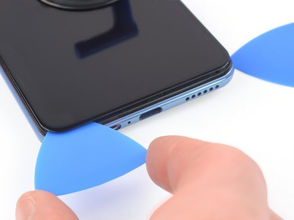

    • Insert a third opening pick at the bottom right corner of your phone.
    • Slide the opening pick along the bottom edge to slice the adhesive.
    • Leave the opening pick in the bottom left corner to prevent the adhesive from resealing.

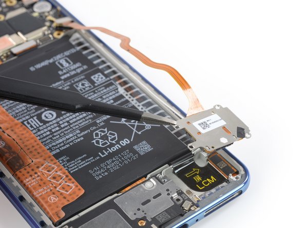

  12. Xiaomi Mi 11 Lite Screen Replacement, Disconnect the SIM card tray cable: crwdns2935265:012crwdnd2935265:01crwdnd2935265:02crwdne2935265:0 Xiaomi Mi 11 Lite Screen Replacement, Disconnect the SIM card tray cable: crwdns2935265:012crwdnd2935265:02crwdnd2935265:02crwdne2935265:0
    • Use the flat end of a spudger to disconnect the SIM card tray cable from the motherboard.
  13. Xiaomi Mi 11 Lite Screen Replacement, Unscrew the SIM card tray: crwdns2935265:013crwdnd2935265:01crwdnd2935265:01crwdne2935265:0
    • Use a Phillips screwdriver to remove the four screws securing the SIM card tray in the midframe:
    • Three 3.5 mm screws
    • One 3.0 mm screw
  14. Xiaomi Mi 11 Lite Screen Replacement, Remove the SIM card tray: crwdns2935265:014crwdnd2935265:01crwdnd2935265:02crwdne2935265:0 Xiaomi Mi 11 Lite Screen Replacement, Remove the SIM card tray: crwdns2935265:014crwdnd2935265:02crwdnd2935265:02crwdne2935265:0
    • Use a pair of blunt nose tweezers to remove the SIM card tray from the phone assembly.

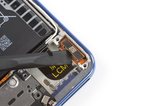

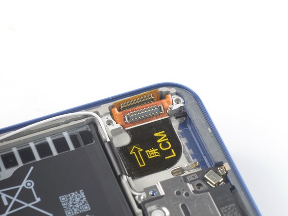

  15. Xiaomi Mi 11 Lite Screen Replacement, Disconnect the display flex cable: crwdns2935265:015crwdnd2935265:01crwdnd2935265:02crwdne2935265:0 Xiaomi Mi 11 Lite Screen Replacement, Disconnect the display flex cable: crwdns2935265:015crwdnd2935265:02crwdnd2935265:02crwdne2935265:0
    • Use a spudger to disconnect the display flex cable by prying the connector straight up from its socket.

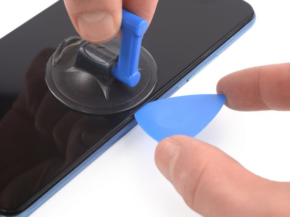

    • Apply a heated iOpener or a heat gun to the screen for two minutes to loosen the adhesive underneath.
  17. Xiaomi Mi 11 Lite Screen Replacement, Insert an opening pick: crwdns2935265:017crwdnd2935265:01crwdnd2935265:02crwdne2935265:0 Xiaomi Mi 11 Lite Screen Replacement, Insert an opening pick: crwdns2935265:017crwdnd2935265:02crwdnd2935265:02crwdne2935265:0
    • Once the screen is warm to the touch, apply a suction cup to the right edge of the phone.
    • If your screen is badly cracked, covering it with a layer of clear packing tape may allow the suction cup to adhere. Alternatively, very strong tape may be used instead of the suction cup. If all else fails, you can superglue the suction cup to the screen.
    • Lift the screen with the suction handle to create a small gap between the screen and the frame.
    • Insert an opening pick into the gap between the midframe and the screen.

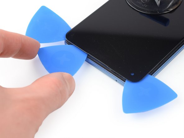

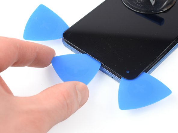

  18. Xiaomi Mi 11 Lite Screen Replacement, Slice the adhesive: crwdns2935265:018crwdnd2935265:01crwdnd2935265:02crwdne2935265:0 Xiaomi Mi 11 Lite Screen Replacement, Slice the adhesive: crwdns2935265:018crwdnd2935265:02crwdnd2935265:02crwdne2935265:0
    • Slide the opening pick to the top right corner of the screen to slice its adhesive.

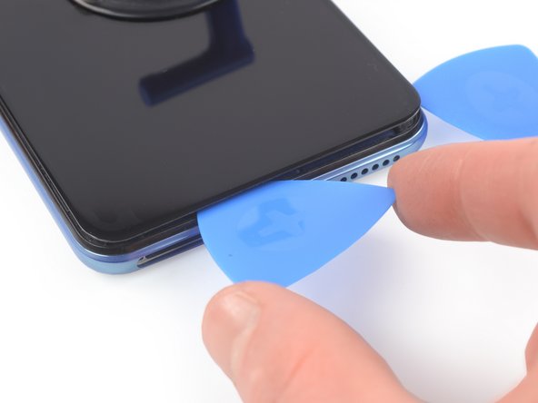

  19. Xiaomi Mi 11 Lite Screen Replacement, Slice the adhesive: crwdns2935265:019crwdnd2935265:01crwdnd2935265:03crwdne2935265:0 Xiaomi Mi 11 Lite Screen Replacement, Slice the adhesive: crwdns2935265:019crwdnd2935265:02crwdnd2935265:03crwdne2935265:0 Xiaomi Mi 11 Lite Screen Replacement, Slice the adhesive: crwdns2935265:019crwdnd2935265:03crwdnd2935265:03crwdne2935265:0
    • Insert a second opening pick underneath the top right corner.
    • Slide the opening pick to the bottom right corner of the screen to cut the adhesive.
    • Leave the opening picks in place to prevent the adhesive from resealing.

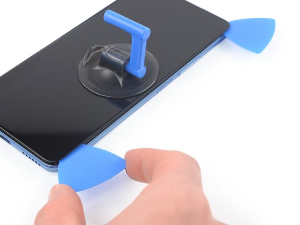

  20. Xiaomi Mi 11 Lite Screen Replacement: crwdns2935265:020crwdnd2935265:01crwdnd2935265:03crwdne2935265:0 Xiaomi Mi 11 Lite Screen Replacement: crwdns2935265:020crwdnd2935265:02crwdnd2935265:03crwdne2935265:0 Xiaomi Mi 11 Lite Screen Replacement: crwdns2935265:020crwdnd2935265:03crwdnd2935265:03crwdne2935265:0
    • If the adhesive becomes hard to cut, it has most likely cooled down. Use your iOpener or heat gun for 1-2 minutes to reheat it.
    • Insert a third opening pick underneath the bottom right corner of the screen.
    • Slide the opening pick along the bottom edge of the screen to slice the adhesive.

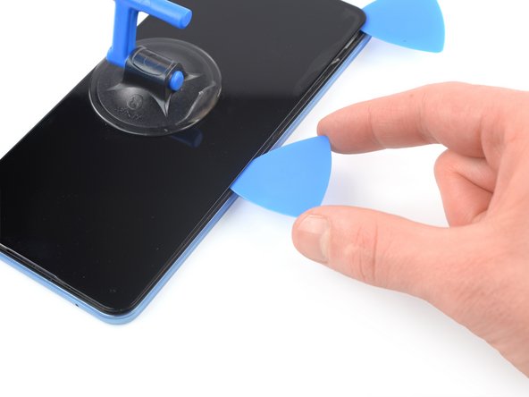

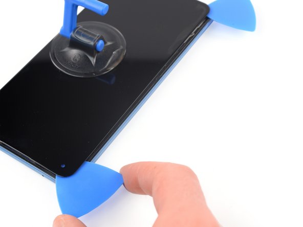

  21. Xiaomi Mi 11 Lite Screen Replacement: crwdns2935265:021crwdnd2935265:01crwdnd2935265:03crwdne2935265:0 Xiaomi Mi 11 Lite Screen Replacement: crwdns2935265:021crwdnd2935265:02crwdnd2935265:03crwdne2935265:0 Xiaomi Mi 11 Lite Screen Replacement: crwdns2935265:021crwdnd2935265:03crwdnd2935265:03crwdne2935265:0
    • Insert a fourth opening pick at the bottom left corner of the screen.
    • Slide the opening pick along the left edge of the phone to slice the adhesive.
    • Leave the opening pick in the top left corner of the screen to prevent the adhesive from resealing.

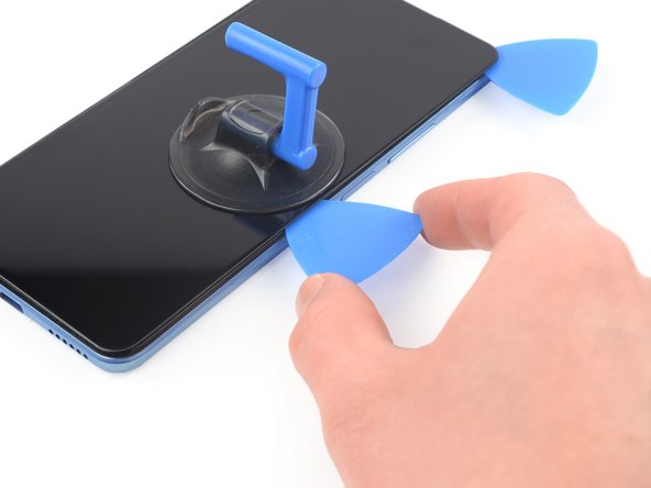

  22. Xiaomi Mi 11 Lite Screen Replacement: crwdns2935265:022crwdnd2935265:01crwdnd2935265:03crwdne2935265:0 Xiaomi Mi 11 Lite Screen Replacement: crwdns2935265:022crwdnd2935265:02crwdnd2935265:03crwdne2935265:0 Xiaomi Mi 11 Lite Screen Replacement: crwdns2935265:022crwdnd2935265:03crwdnd2935265:03crwdne2935265:0
    • Insert a fifth opening pick underneath the top left corner.
    • Slide the opening pick along the top edge of the phone to slice the remaining adhesive.
    • Do not try to remove the display all the way yet, the display cable is still threaded through the frame.
  23. Xiaomi Mi 11 Lite Screen Replacement, Pry up the display connector: crwdns2935265:023crwdnd2935265:01crwdnd2935265:02crwdne2935265:0 Xiaomi Mi 11 Lite Screen Replacement, Pry up the display connector: crwdns2935265:023crwdnd2935265:02crwdnd2935265:02crwdne2935265:0
    • Use the flat end of a spudger to carefully pry up the display connector from the midframe.
  24. Xiaomi Mi 11 Lite Screen Replacement, Thread the display flex cable through the gap: crwdns2935265:024crwdnd2935265:01crwdnd2935265:03crwdne2935265:0 Xiaomi Mi 11 Lite Screen Replacement, Thread the display flex cable through the gap: crwdns2935265:024crwdnd2935265:02crwdnd2935265:03crwdne2935265:0 Xiaomi Mi 11 Lite Screen Replacement, Thread the display flex cable through the gap: crwdns2935265:024crwdnd2935265:03crwdnd2935265:03crwdne2935265:0
    • Thread the display flex cable through the gap in the midframe.
