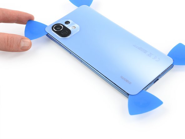

  2. Xiaomi Mi 11 Lite Battery Replacement, Create a gap: crwdns2935265:02crwdnd2935265:01crwdnd2935265:03crwdne2935265:0 Xiaomi Mi 11 Lite Battery Replacement, Create a gap: crwdns2935265:02crwdnd2935265:02crwdnd2935265:03crwdne2935265:0 Xiaomi Mi 11 Lite Battery Replacement, Create a gap: crwdns2935265:02crwdnd2935265:03crwdnd2935265:03crwdne2935265:0
    • Secure a suction handle to the right edge of the rear glass, as close to the edge as possible.
    • If the rear glass is cracked, the suction handle may not stick. Try lifting it with strong tape, or superglue the suction handle in place and allow it to cure so you can proceed.
    • Lift the rear glass with the suction handle to create a small gap between the rear glass and the frame.
    • If you have trouble creating a gap, apply more heat to further soften the adhesive. Follow the iOpener instructions to avoid overheating.
    • Insert an opening pick into the gap you created.
    • Slide the opening pick to the top right corner to slice the adhesive.
    • Leave the opening pick in place to prevent the adhesive from resealing.

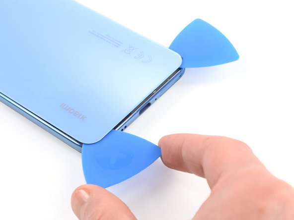

  3. Xiaomi Mi 11 Lite Battery Replacement, Slice the adhesive: crwdns2935265:03crwdnd2935265:01crwdnd2935265:03crwdne2935265:0 Xiaomi Mi 11 Lite Battery Replacement, Slice the adhesive: crwdns2935265:03crwdnd2935265:02crwdnd2935265:03crwdne2935265:0 Xiaomi Mi 11 Lite Battery Replacement, Slice the adhesive: crwdns2935265:03crwdnd2935265:03crwdnd2935265:03crwdne2935265:0
    • Insert a second opening pick underneath the top right corner of your phone.
    • Slide the opening pick along the right edge to slice the adhesive.
    • Leave the opening pick in the bottom right corner to prevent the adhesive from resealing.

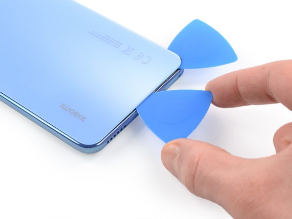

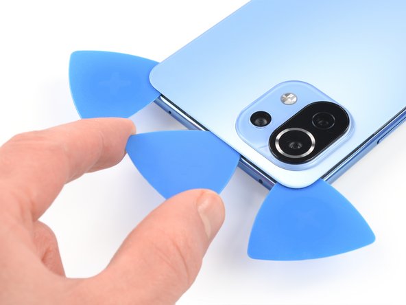

    • Insert a third opening pick at the bottom right corner of your phone.
    • Slide the opening pick along the bottom edge to slice the adhesive.
    • Leave the opening pick in the bottom left corner to prevent the adhesive from resealing.

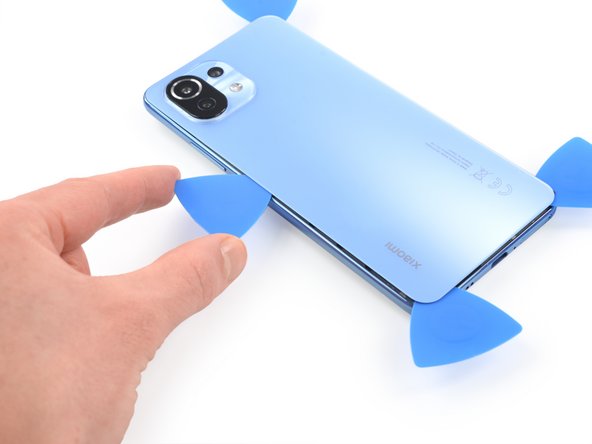

  5. Xiaomi Mi 11 Lite Battery Replacement: crwdns2935265:05crwdnd2935265:01crwdnd2935265:03crwdne2935265:0 Xiaomi Mi 11 Lite Battery Replacement: crwdns2935265:05crwdnd2935265:02crwdnd2935265:03crwdne2935265:0 Xiaomi Mi 11 Lite Battery Replacement: crwdns2935265:05crwdnd2935265:03crwdnd2935265:03crwdne2935265:0
    • Insert a fourth opening pick underneath the bottom left corner of your phone.
    • Slide the opening pick along the left edge to slice the adhesive.
    • Leave the opening pick in the top left corner to prevent the adhesive from resealing.
  6. Xiaomi Mi 11 Lite Battery Replacement: crwdns2935265:06crwdnd2935265:01crwdnd2935265:03crwdne2935265:0 Xiaomi Mi 11 Lite Battery Replacement: crwdns2935265:06crwdnd2935265:02crwdnd2935265:03crwdne2935265:0 Xiaomi Mi 11 Lite Battery Replacement: crwdns2935265:06crwdnd2935265:03crwdnd2935265:03crwdne2935265:0
    • Insert a fifth opening pick underneath the top left corner.
    • Slide the opening pick along the top edge of the rear glass to slice the remaining adhesive.

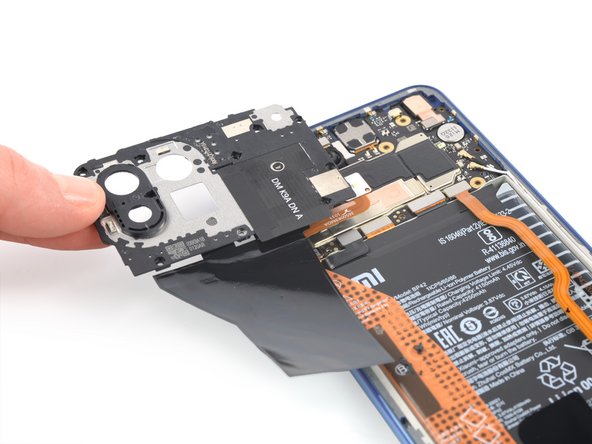

  8. Xiaomi Mi 11 Lite Battery Replacement, Unfasten the motherboard cover screws: crwdns2935265:08crwdnd2935265:01crwdnd2935265:01crwdne2935265:0
    • Use a Phillips screwdriver to remove the eleven 3.4 mm-long screws securing the motherboard cover.

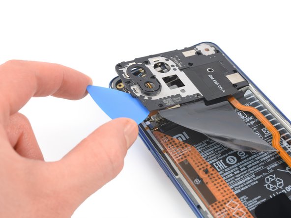

  9. Xiaomi Mi 11 Lite Battery Replacement, Pry up the motherboard cover: crwdns2935265:09crwdnd2935265:01crwdnd2935265:03crwdne2935265:0 Xiaomi Mi 11 Lite Battery Replacement, Pry up the motherboard cover: crwdns2935265:09crwdnd2935265:02crwdnd2935265:03crwdne2935265:0 Xiaomi Mi 11 Lite Battery Replacement, Pry up the motherboard cover: crwdns2935265:09crwdnd2935265:03crwdnd2935265:03crwdne2935265:0
    • Insert the tip of an opening pick underneath the left edge of the motherboard cover.
    • Use the opening pick to pry up the motherboard cover.
    • Remove the motherboard cover.

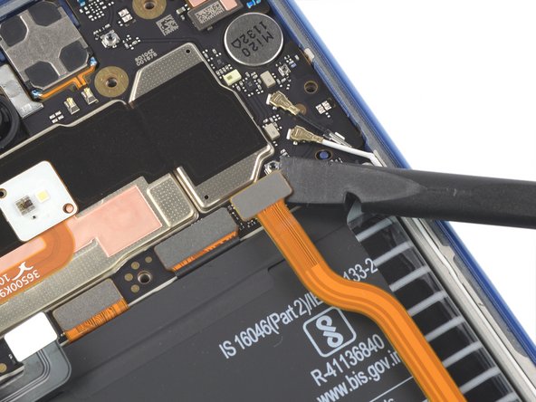

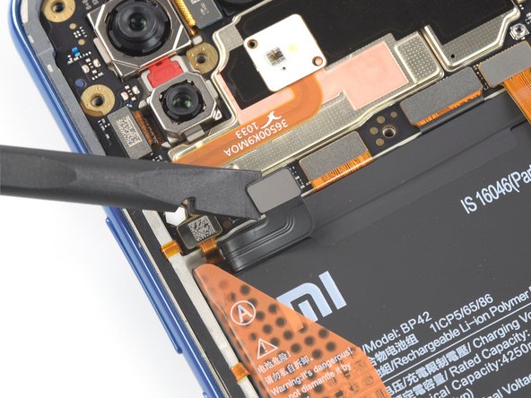

  10. Xiaomi Mi 11 Lite Battery Replacement, Disconnect the battery cable: crwdns2935265:010crwdnd2935265:01crwdnd2935265:02crwdne2935265:0 Xiaomi Mi 11 Lite Battery Replacement, Disconnect the battery cable: crwdns2935265:010crwdnd2935265:02crwdnd2935265:02crwdne2935265:0
    • Use a spudger to disconnect the battery cable by prying the connector straight up from its socket.

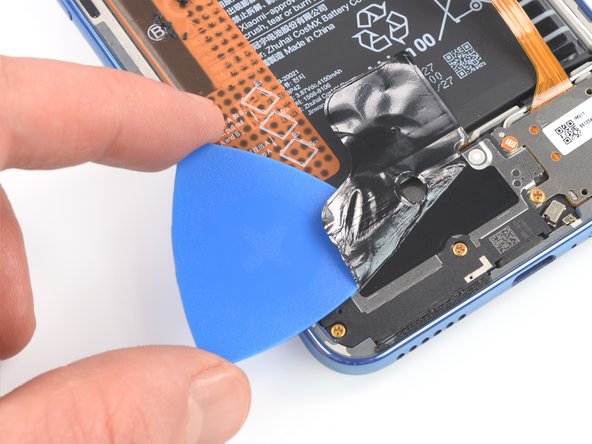

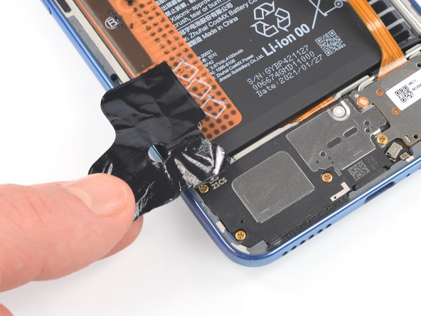

  12. Xiaomi Mi 11 Lite Battery Replacement, Remove the graphite film: crwdns2935265:012crwdnd2935265:01crwdnd2935265:03crwdne2935265:0 Xiaomi Mi 11 Lite Battery Replacement, Remove the graphite film: crwdns2935265:012crwdnd2935265:02crwdnd2935265:03crwdne2935265:0 Xiaomi Mi 11 Lite Battery Replacement, Remove the graphite film: crwdns2935265:012crwdnd2935265:03crwdnd2935265:03crwdne2935265:0
    • Slide an opening pick underneath the graphite film at the bottom end of your phone and carefully separate it from the battery and loudspeaker assembly.
    • Remove the graphite film.

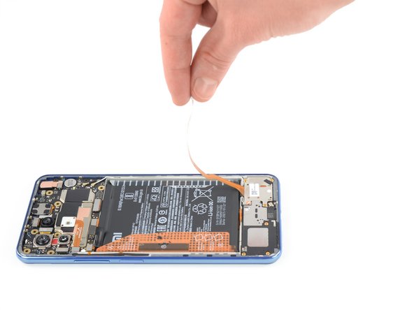

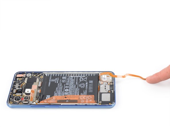

  13. Xiaomi Mi 11 Lite Battery Replacement, Free the battery: crwdns2935265:013crwdnd2935265:01crwdnd2935265:03crwdne2935265:0 Xiaomi Mi 11 Lite Battery Replacement, Free the battery: crwdns2935265:013crwdnd2935265:02crwdnd2935265:03crwdne2935265:0 Xiaomi Mi 11 Lite Battery Replacement, Free the battery: crwdns2935265:013crwdnd2935265:03crwdnd2935265:03crwdne2935265:0
    • During the following step do not fold the cables sharply and only bend them to avoid cable damage.
    • Fold the SIM card tray flex cable towards the charging port in order to get free access to the battery.
    • You might want to use a small piece of tape to temporarily stick the cable onto your working surface to avoid accidentally damaging it during the battery removal.

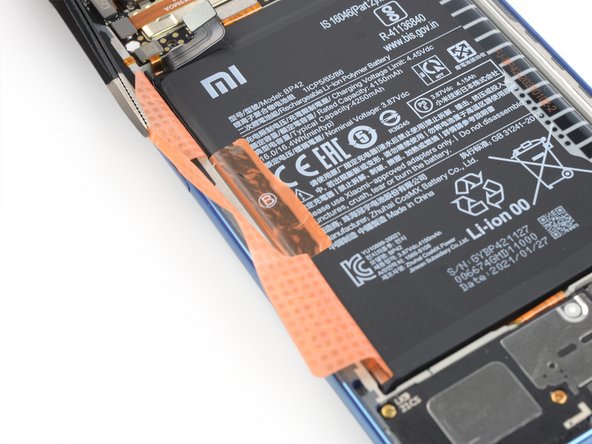

  15. Xiaomi Mi 11 Lite Battery Replacement, Peel off the battery pull-tabs: crwdns2935265:015crwdnd2935265:01crwdnd2935265:02crwdne2935265:0 Xiaomi Mi 11 Lite Battery Replacement, Peel off the battery pull-tabs: crwdns2935265:015crwdnd2935265:02crwdnd2935265:02crwdne2935265:0
    • Use a pair of blunt nose tweezers or a clean fingernail to peel the orange adhesive strip labelled with a B off the battery.

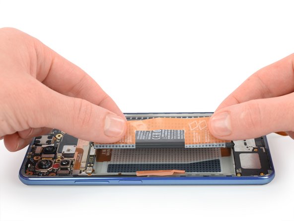

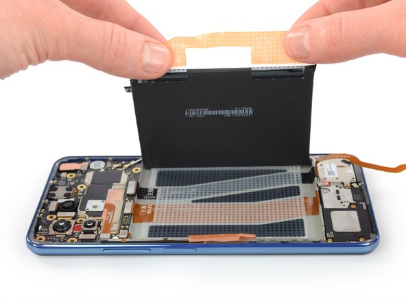

  16. Xiaomi Mi 11 Lite Battery Replacement, Lift up the battery: crwdns2935265:016crwdnd2935265:01crwdnd2935265:03crwdne2935265:0 Xiaomi Mi 11 Lite Battery Replacement, Lift up the battery: crwdns2935265:016crwdnd2935265:02crwdnd2935265:03crwdne2935265:0 Xiaomi Mi 11 Lite Battery Replacement, Lift up the battery: crwdns2935265:016crwdnd2935265:03crwdnd2935265:03crwdne2935265:0
    • Pull up on the orange adhesive strip to lift the battery out of its recess and swing it up to an upright position.
    • Although these adhesive tabs are supposed to make the battery removal easier, they may require some force. If you're having trouble removing the battery, you can apply a heated iOpener to the center of the display to loosen the adhesive underneath.
    • Peel the battery off the remaining adhesive.
  17. Xiaomi Mi 11 Lite Battery Replacement, Remove the battery: crwdns2935265:017crwdnd2935265:01crwdnd2935265:01crwdne2935265:0
    • Remove the battery.
    • During reassembly, temporarily reconnect the battery to the motherboard to help align it correctly. Disconnect the battery after it is seated.
    • In case you're replacing the adhesive sticker with a new one, peel the battery's adhesive sticker off the midframe and clean the relevant areas with isopropyl alcohol (>90%). Let the alcohol dry before installing new adhesive.
    • Secure the new battery with pre-cut adhesive or double-sided adhesive tape. In order to position it correctly, apply the new adhesive into the device at the places where the old adhesive was located, not directly onto the battery. Press the new battery firmly into place.
