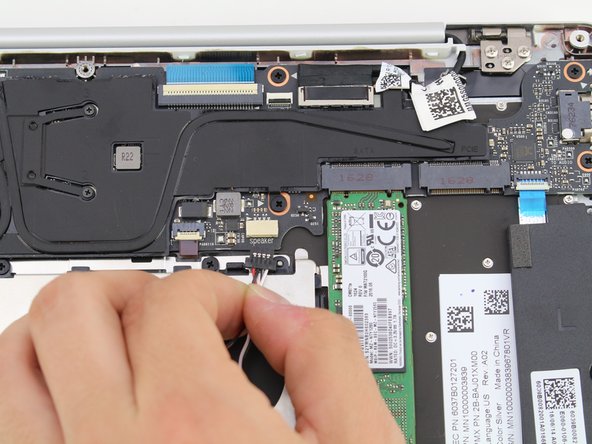

  6. Xiaomi Air 12 Speaker Replacement, Speaker: crwdns2935265:06crwdnd2935265:01crwdnd2935265:02crwdne2935265:0 Xiaomi Air 12 Speaker Replacement, Speaker: crwdns2935265:06crwdnd2935265:02crwdnd2935265:02crwdne2935265:0
    • Remove the white and black speaker wires from the black tabs by pulling upwards from the device.
  7. Xiaomi Air 12 Speaker Replacement: crwdns2935265:07crwdnd2935265:01crwdnd2935265:02crwdne2935265:0 Xiaomi Air 12 Speaker Replacement: crwdns2935265:07crwdnd2935265:02crwdnd2935265:02crwdne2935265:0
    • Gently pull the speaker connector out from the connection point using your hand.
  8. Xiaomi Air 12 Speaker Replacement: crwdns2935265:08crwdnd2935265:01crwdnd2935265:03crwdne2935265:0 Xiaomi Air 12 Speaker Replacement: crwdns2935265:08crwdnd2935265:02crwdnd2935265:03crwdne2935265:0 Xiaomi Air 12 Speaker Replacement: crwdns2935265:08crwdnd2935265:03crwdnd2935265:03crwdne2935265:0
    • Remove the left speaker module by pulling the panel up from the device.
    • Repeat the same process for the right speaker module.
    • Left and Right speaker modules are denoted by an "L" and "R" respectively.
    • There will be a slight adhesive underneath the module.
