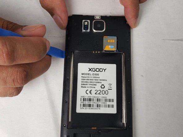

      • Place the phone on a flat surface with the back facing up and the screen facing down.
      • Next, use the pry tool to remove the case cover.
    2. Xgody D300 Screen Replacement: crwdns2935265:02crwdnd2935265:01crwdnd2935265:02crwdne2935265:0 Xgody D300 Screen Replacement: crwdns2935265:02crwdnd2935265:02crwdnd2935265:02crwdne2935265:0
      • After removing the case cover, locate the indentation in the battery enclosure.
      • Next, use a finger or pry tool to lift the battery and remove it from the housing.

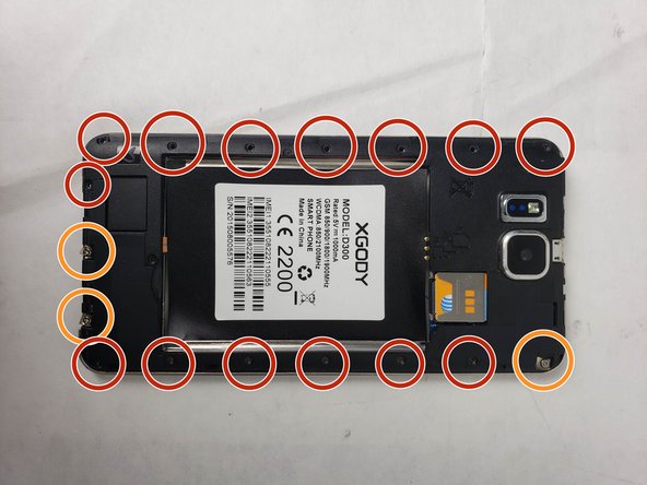

    3. Xgody D300 Screen Replacement: crwdns2935265:03crwdnd2935265:01crwdnd2935265:03crwdne2935265:0 Xgody D300 Screen Replacement: crwdns2935265:03crwdnd2935265:02crwdnd2935265:03crwdne2935265:0 Xgody D300 Screen Replacement: crwdns2935265:03crwdnd2935265:03crwdnd2935265:03crwdne2935265:0
      • Next, remove the battery housing/protective cover using a Phillips #00 screwdriver.
      • Use the Phillips #00 screwdriver to remove the screws securing the protective housing to the smartphone. There should be fourteen screws measuring 3 mm in length and one screw measuring 6 mm.
      • Three of the screws will remain attached to the protective housing and can be identified by a metal plate underneath them. In total, there are 18 screws.
      • After loosening and removing all the screws, use the pry tool and tweezers to lift the housing along the edges. A sticky pad will hold the housing to the smartphone, do not hesitate to give it a firm tug until the housing separates from the sticky pad.

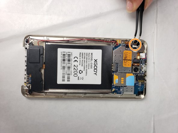

    5. Xgody D300 Screen Replacement: crwdns2935265:05crwdnd2935265:01crwdnd2935265:02crwdne2935265:0 Xgody D300 Screen Replacement: crwdns2935265:05crwdnd2935265:02crwdnd2935265:02crwdne2935265:0
      • Next, locate the connections for the screen and other devices attached to the smartphone case. There are two connections, both on the right side of the motherboard.
      • One will be black. The other will be a gold orange.
      • Disconnect these connections by using tweezers to grip them and giving them a firm tug until they come loose.

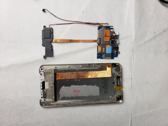

      • The motherboard should now be free from the smartphone. To finish removing it, use your fingers or tweezers to lift the board and set it aside.
      • Insert your new Motherboard.

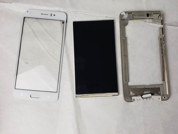

    13. Xgody D300 Screen Replacement: crwdns2935265:013crwdnd2935265:01crwdnd2935265:01crwdne2935265:0
      • Next, remove the screen cover by following the exposed edge with your finger or a pry tool to break it free from the sticky tack holding it to the screen.
      • Once all the sticky tack has been loosened, the screen cover will come off.
      • Be cautious when removing the screen cover, as it is fragile, and applying too much pressure may cause it to shatter.

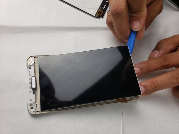

    1. Xgody D300 Screen Replacement, Screen: crwdns2935265:014crwdnd2935265:01crwdnd2935265:03crwdne2935265:0 Xgody D300 Screen Replacement, Screen: crwdns2935265:014crwdnd2935265:02crwdnd2935265:03crwdne2935265:0 Xgody D300 Screen Replacement, Screen: crwdns2935265:014crwdnd2935265:03crwdnd2935265:03crwdne2935265:0
      • Place your phone so the screen is facing up.
      • Use the iFixit pry tool to separate the LCD screen from the phone housing, starting from any edge.
      • Fully remove the LCD screen from the housing.
