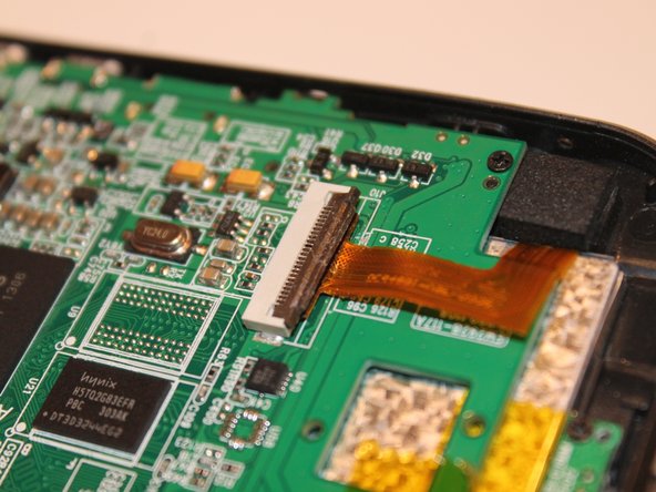

  3. Xelio P1001A-BK Rear Camera Replacement, Rear Camera: crwdns2935265:03crwdnd2935265:01crwdnd2935265:01crwdne2935265:0
    • Locate the ribbon connector, and make sure it is secure.

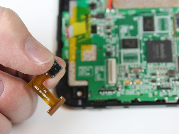

  4. Xelio P1001A-BK Rear Camera Replacement: crwdns2935265:04crwdnd2935265:01crwdnd2935265:01crwdne2935265:0
    • Gently use a plastic opening tool to pry the camera loose from its socket.
    • Avoid using metal tools to prevent damaging internal components.
  5. Xelio P1001A-BK Rear Camera Replacement: crwdns2935265:05crwdnd2935265:01crwdnd2935265:01crwdne2935265:0
    • Check that the camera lens is clean and free of any debris.

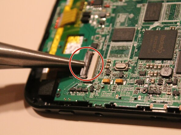

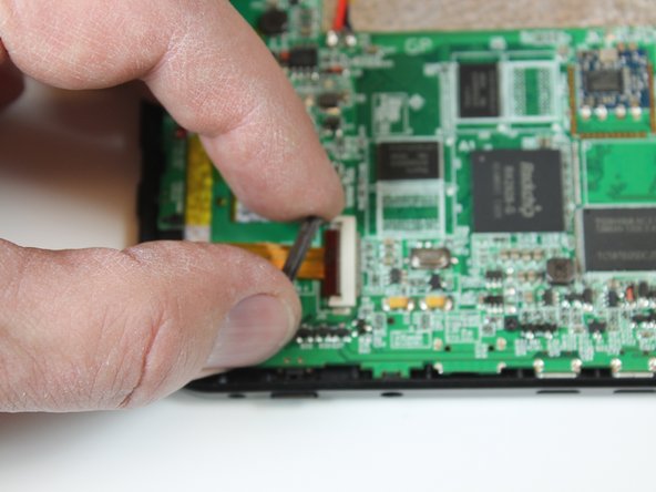

  6. Xelio P1001A-BK Rear Camera Replacement: crwdns2935265:06crwdnd2935265:01crwdnd2935265:03crwdne2935265:0 Xelio P1001A-BK Rear Camera Replacement: crwdns2935265:06crwdnd2935265:02crwdnd2935265:03crwdne2935265:0 Xelio P1001A-BK Rear Camera Replacement: crwdns2935265:06crwdnd2935265:03crwdnd2935265:03crwdne2935265:0
    • Use a plastic opening tool to gently lift the small locking flap on the ZIF (Zero Insertion Force) connector.
    • Do not pry up the entire connector, only the small locking flap.
    • Once the flap is unlocked, gently pull the ribbon cable straight out of the connector.
    • Carefully lift the camera out of the tablet.

  8. Xelio P1001A-BK Rear Camera Replacement: crwdns2935265:08crwdnd2935265:01crwdnd2935265:03crwdne2935265:0 Xelio P1001A-BK Rear Camera Replacement: crwdns2935265:08crwdnd2935265:02crwdnd2935265:03crwdne2935265:0 Xelio P1001A-BK Rear Camera Replacement: crwdns2935265:08crwdnd2935265:03crwdnd2935265:03crwdne2935265:0
    • Slide the ribbon cable straight into the ZIF connector.
    • Make sure the contacts are facing the correct direction and the cable is fully inserted.
    • Press the locking flap down to secure the cable in place.
    • The indentation on the securing tab should face up when reinstalled.
    • Place the camera into its socket.
