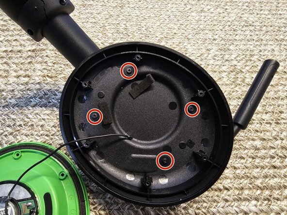

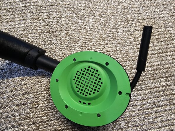

    • Remove the left ear pad from the headset.
  2. Xbox Wireless Headset Microphone Replacement: crwdns2935265:02crwdnd2935265:01crwdnd2935265:03crwdne2935265:0 Xbox Wireless Headset Microphone Replacement: crwdns2935265:02crwdnd2935265:02crwdnd2935265:03crwdne2935265:0 Xbox Wireless Headset Microphone Replacement: crwdns2935265:02crwdnd2935265:03crwdnd2935265:03crwdne2935265:0

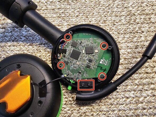

    • Remove all screws with your ph0 and ph00). (Approximately 16 screws)
  3. Xbox Wireless Headset Microphone Replacement: crwdns2935265:03crwdnd2935265:01crwdnd2935265:01crwdne2935265:0

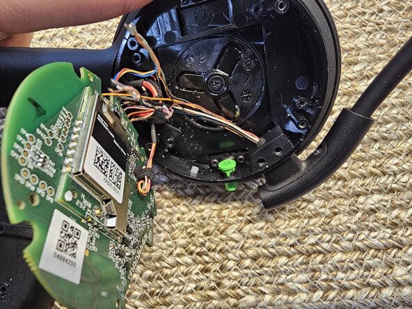

    • Remove the circuit board and microphone carefully

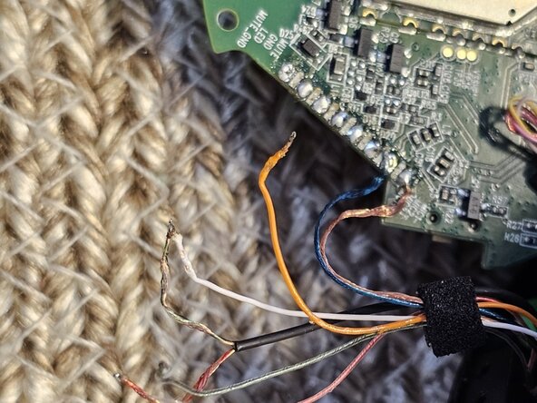

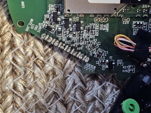

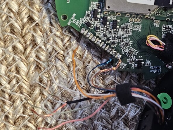

    • Use a soldering iron to desolder each wire of the microphone (it is recommended to take a picture of the wire of the circuit board).
  5. Xbox Wireless Headset Microphone Replacement: crwdns2935265:05crwdnd2935265:01crwdnd2935265:03crwdne2935265:0 Xbox Wireless Headset Microphone Replacement: crwdns2935265:05crwdnd2935265:02crwdnd2935265:03crwdne2935265:0 Xbox Wireless Headset Microphone Replacement: crwdns2935265:05crwdnd2935265:03crwdnd2935265:03crwdne2935265:0

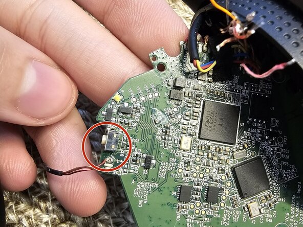

    • Grab your new microphone and connect each wire to the circuit board using your Soldering kit (Use the picture you took to connect the wires).
  6. Xbox Wireless Headset Microphone Replacement: crwdns2935265:06crwdnd2935265:01crwdnd2935265:02crwdne2935265:0 Xbox Wireless Headset Microphone Replacement: crwdns2935265:06crwdnd2935265:02crwdnd2935265:02crwdne2935265:0
    • Once the wires are connected, turn on the headset to check if the microphone works, if so, carefully place all pieces back to how they were.
    • If the microphone doesn't work, check if the wires are connected in the correct order.
