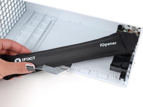

  27. Xbox Series X (Digital Edition) Shell Replacement, Separate the USB board cable: crwdns2935265:027crwdnd2935265:01crwdnd2935265:02crwdne2935265:0 Xbox Series X (Digital Edition) Shell Replacement, Separate the USB board cable: crwdns2935265:027crwdnd2935265:02crwdnd2935265:02crwdne2935265:0
    • The USB board cable is adhered to the shell with pieces of mild adhesive.
    • Use an iOpener or a hair dryer to heat the USB board cable.
  28. Xbox Series X (Digital Edition) Shell Replacement: crwdns2935265:028crwdnd2935265:01crwdnd2935265:03crwdne2935265:0 Xbox Series X (Digital Edition) Shell Replacement: crwdns2935265:028crwdnd2935265:02crwdnd2935265:03crwdne2935265:0 Xbox Series X (Digital Edition) Shell Replacement: crwdns2935265:028crwdnd2935265:03crwdnd2935265:03crwdne2935265:0
    Tesa 61395 Tape
    $2.99
    • Peel up the section of USB board cable near the outer edge of the shell to separate the adhesive.
    • Slide an opening pick under the section of the cable closest to the board to separate the adhesive.
    • During reassembly, use thin double‑sided adhesive to secure the cable. If there's adhesive left and it's still sticky, you can reuse it. If you have a new cable, check it for pre‑installed adhesive and remove any liners.
