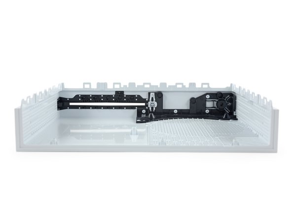

    • This One, more streamlined than its predecessor, doesn't feature any weird, afterthought components left out in the cold.
    • All that's left in the PC/ABS case are some button covers and Sabic and Samsung logos—probably the plastic suppliers.
    • Okay, is it just the teardown giddiness, or does this case vaguely resemble a Star Destroyer hangar?

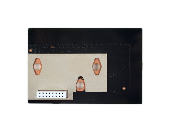

    • And on the back of the motherboard...is not much really.
    • Realtek RTL8111HM (Likely an iteration of the RTL8111 gigabit ethernet controller)
    • Nuvoton ISD8104 2 W class AB audio amplifier (likely)
    • Texas Instruments SN74LVC1G08 single 2-input AND gate
    • Oh and that handy front-side USB port—which is on the opposite end and opposite side from its friends, poor guy.
