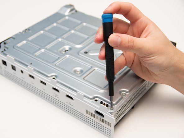

    • Remove the two 15mm screws from the front panel using the Torx T8 screwdriver.

  7. Xbox One S All Digital Edition Power Supply Replacement, Wifi Card: crwdns2935265:07crwdnd2935265:01crwdnd2935265:02crwdne2935265:0 Xbox One S All Digital Edition Power Supply Replacement, Wifi Card: crwdns2935265:07crwdnd2935265:02crwdnd2935265:02crwdne2935265:0
    • Remove the three 15 mm screws with the Torx T8 Security Bit Screwdriver.
    • The top of the metal chassis has been removed in the picture, but is not necessary for the replacement.
