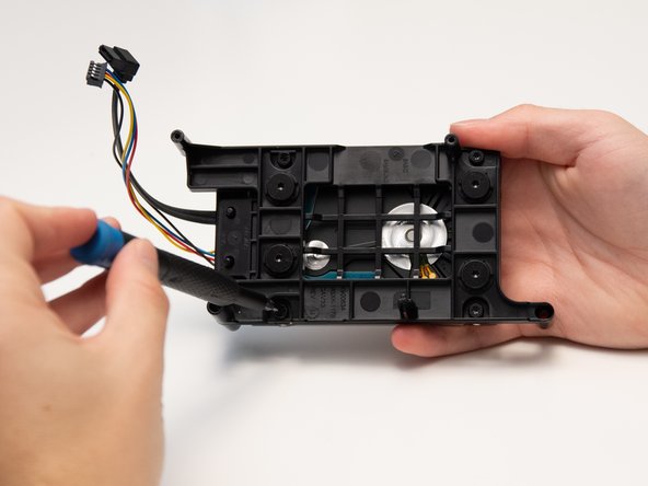

    • Remove the four 10mm screws attaching the hard drive to the plastic casing with the Torx T8 Security screwdriver.

    • Carefully remove the hard drive from its plastic case.
