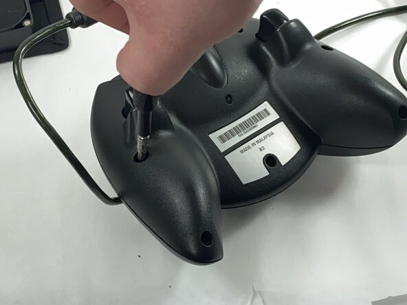

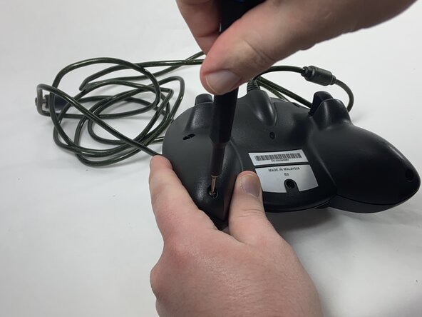

      • Remove the seven black 8 mm screws holding the two halves of the Duke together using a Phillips #1 screwdriver.
      • To reach the deeply set screws, use a longer screw driver or a 4.0 socket bit in addition to the PH1 bit.

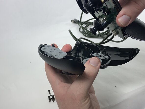

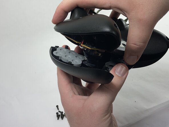

      • Remove the two halves of the Duke, placing the top plate face-down so the buttons don't fall out.

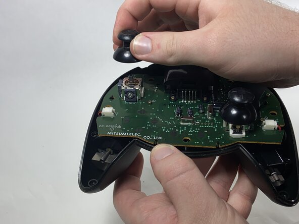

      • Remove the stick caps from the potentiometers.

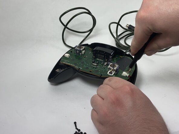

      • Disconnect the connectors attaching the rumble motors to the motherboard using a pair of tweezers.
      • Be gentle when slipping the tweezers underneath the flaps of the connectors; they are fragile and can snap.

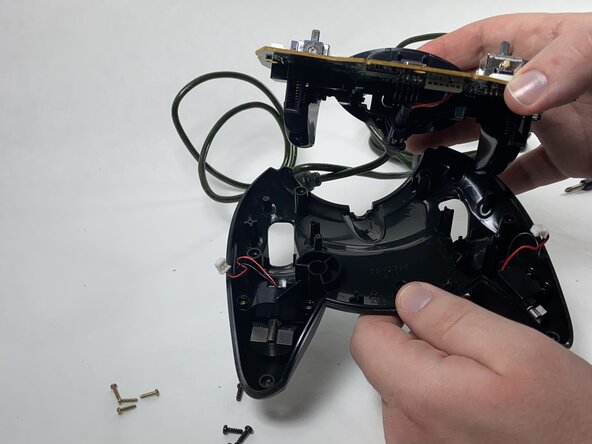

    3. Xbox Duke Controller Potentiometer Replacement: crwdns2935265:05crwdnd2935265:01crwdnd2935265:02crwdne2935265:0 Xbox Duke Controller Potentiometer Replacement: crwdns2935265:05crwdnd2935265:02crwdnd2935265:02crwdne2935265:0

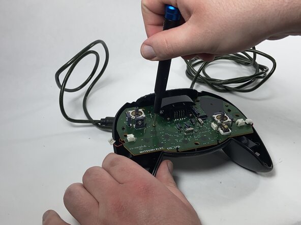

      • Using a Phillips #1 screwdriver, remove the four yellow 8 mm screws holding the motherboard to the bottom half of the controller.
    4. Xbox Duke Controller Potentiometer Replacement: crwdns2935265:06crwdnd2935265:01crwdnd2935265:02crwdne2935265:0 Xbox Duke Controller Potentiometer Replacement: crwdns2935265:06crwdnd2935265:02crwdnd2935265:02crwdne2935265:0
      • Remove the motherboard from the bottom half of the controller.

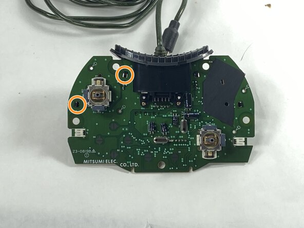

      • Desolder the connector pins holding the left trigger assembly in place.
      • Remove the trigger assembly by pushing on the black connectors that hold them to the motherboard.

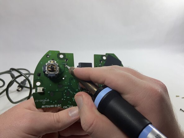

    6. Xbox Duke Controller Potentiometer Replacement: crwdns2935265:08crwdnd2935265:01crwdnd2935265:01crwdne2935265:0
      • Desolder all of the connector pins holding the potentiometer in place.
      • Pull out the potentiometers and solder the new ones into place.
