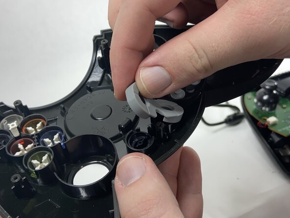

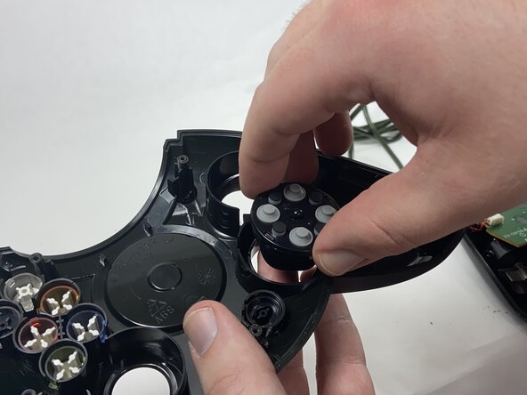

    1. Xbox Duke Controller Face Buttons Replacement, Face Buttons: crwdns2935265:03crwdnd2935265:01crwdnd2935265:03crwdne2935265:0 Xbox Duke Controller Face Buttons Replacement, Face Buttons: crwdns2935265:03crwdnd2935265:02crwdnd2935265:03crwdne2935265:0 Xbox Duke Controller Face Buttons Replacement, Face Buttons: crwdns2935265:03crwdnd2935265:03crwdnd2935265:03crwdne2935265:0
      • Remove the silicone pads and pull out the directional pad assembly.

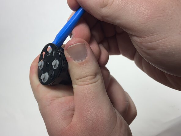

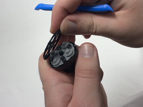

    2. Xbox Duke Controller Face Buttons Replacement: crwdns2935265:04crwdnd2935265:01crwdnd2935265:03crwdne2935265:0 Xbox Duke Controller Face Buttons Replacement: crwdns2935265:04crwdnd2935265:02crwdnd2935265:03crwdne2935265:0 Xbox Duke Controller Face Buttons Replacement: crwdns2935265:04crwdnd2935265:03crwdnd2935265:03crwdne2935265:0
      • Using a plastic opening tool, remove the plastic plate from the bottom of the directional pad assembly.
      • Pull out the silicone pad.

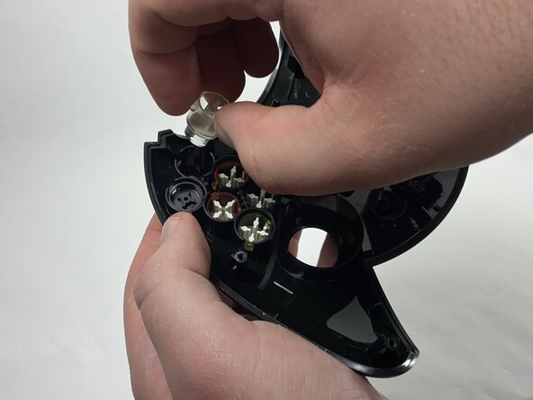

    3. Xbox Duke Controller Face Buttons Replacement: crwdns2935265:05crwdnd2935265:01crwdnd2935265:02crwdne2935265:0 Xbox Duke Controller Face Buttons Replacement: crwdns2935265:05crwdnd2935265:02crwdnd2935265:02crwdne2935265:0
      • Remove the silicone pads from the top plate of the controller and remove all of the face buttons.
      • To replace the buttons, line them up with the grooves in the top plate.
