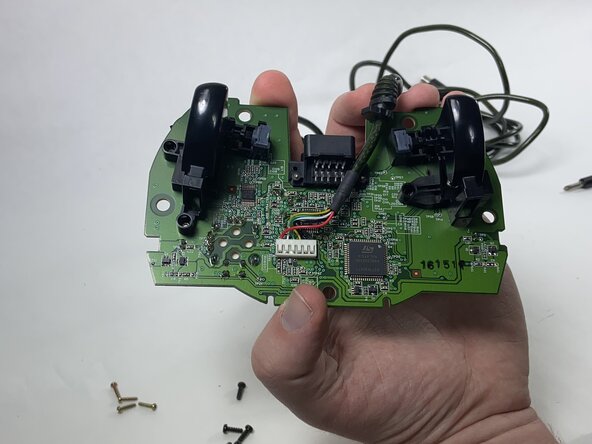

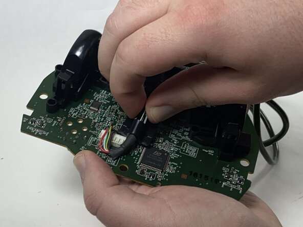

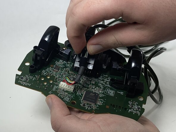

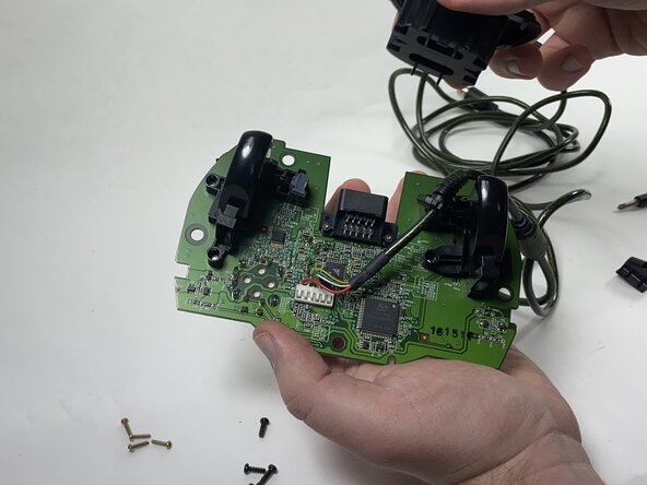

  9. Xbox Duke Controller 6-Pin Cable Replacement, 6-Pin Cable: crwdns2935265:09crwdnd2935265:01crwdnd2935265:03crwdne2935265:0 Xbox Duke Controller 6-Pin Cable Replacement, 6-Pin Cable: crwdns2935265:09crwdnd2935265:02crwdnd2935265:03crwdne2935265:0 Xbox Duke Controller 6-Pin Cable Replacement, 6-Pin Cable: crwdns2935265:09crwdnd2935265:03crwdnd2935265:03crwdne2935265:0
    • Disconnect the cable from the memory card slot, sliding the black plastic holder out of the slot.
    • Remove the plastic piece from the cable.
  10. Xbox Duke Controller 6-Pin Cable Replacement: crwdns2935265:010crwdnd2935265:01crwdnd2935265:02crwdne2935265:0 Xbox Duke Controller 6-Pin Cable Replacement: crwdns2935265:010crwdnd2935265:02crwdnd2935265:02crwdne2935265:0
    • Remove the memory card slot by sliding it away from the motherboard.
  11. Xbox Duke Controller 6-Pin Cable Replacement: crwdns2935265:011crwdnd2935265:01crwdnd2935265:02crwdne2935265:0 Xbox Duke Controller 6-Pin Cable Replacement: crwdns2935265:011crwdnd2935265:02crwdnd2935265:02crwdne2935265:0
    • Desolder the pins holding the cable in place, then pull the cable away from the motherboard.
    • Solder the new cable into the motherboard.
