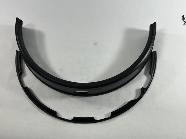

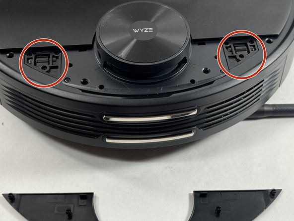

  11. Wyze WVCR200s Wheels Replacement: crwdns2935265:011crwdnd2935265:01crwdnd2935265:03crwdne2935265:0 Wyze WVCR200s Wheels Replacement: crwdns2935265:011crwdnd2935265:02crwdnd2935265:03crwdne2935265:0 Wyze WVCR200s Wheels Replacement: crwdns2935265:011crwdnd2935265:03crwdnd2935265:03crwdne2935265:0
    • The small plastic connector holding the bumper in place should now be loose. Make sure it's disconnected.
    • Pull the bumper straight off of the vacuum.

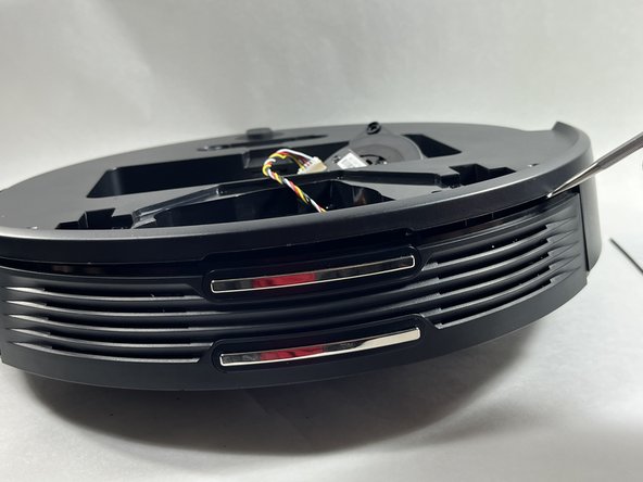

  12. Wyze WVCR200s Wheels Replacement, Wheels: crwdns2935265:012crwdnd2935265:01crwdnd2935265:02crwdne2935265:0 Wyze WVCR200s Wheels Replacement, Wheels: crwdns2935265:012crwdnd2935265:02crwdnd2935265:02crwdne2935265:0
    • Use a spudger to pry the cover off that surrounds the vacuum mechanism.
    • Remove the six screws securing the access cover hinges.
    • Remove the cover.

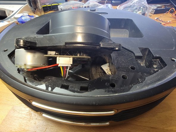

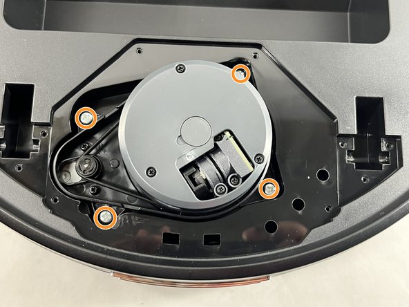

  13. Wyze WVCR200s Wheels Replacement: crwdns2935265:013crwdnd2935265:01crwdnd2935265:03crwdne2935265:0 Wyze WVCR200s Wheels Replacement: crwdns2935265:013crwdnd2935265:02crwdnd2935265:03crwdne2935265:0 Wyze WVCR200s Wheels Replacement: crwdns2935265:013crwdnd2935265:03crwdnd2935265:03crwdne2935265:0
    • Use a screwdriver to remove the four screws surrounding the LIDAR sensor cover.
    • Use a screwdriver to remove the four screws holding the mechanism itself.
    • Lift the LIDAR sensor from the vacuum.
    • It is connected to the vacuum by a cable so don't pull it out quickly or yank it out.
    • Note how the connector is plugged in for reassembly.
    • Disconnect the cable from the vacuum.

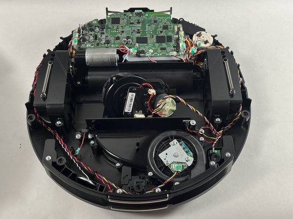

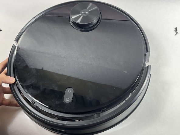

  14. Wyze WVCR200s Wheels Replacement: crwdns2935265:014crwdnd2935265:01crwdnd2935265:03crwdne2935265:0 Wyze WVCR200s Wheels Replacement: crwdns2935265:014crwdnd2935265:02crwdnd2935265:03crwdne2935265:0 Wyze WVCR200s Wheels Replacement: crwdns2935265:014crwdnd2935265:03crwdnd2935265:03crwdne2935265:0
    • Use a screwdriver to remove the ten screws on the back side of the vacuum that hold the outer shell in place.
    • Use a spudger or opening tool to pry along the edges of the vacuum and separate the two parts.

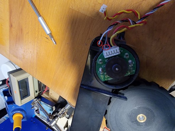

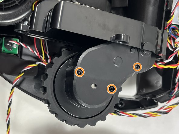

  15. Wyze WVCR200s Wheels Replacement: crwdns2935265:015crwdnd2935265:01crwdnd2935265:03crwdne2935265:0 Wyze WVCR200s Wheels Replacement: crwdns2935265:015crwdnd2935265:02crwdnd2935265:03crwdne2935265:0 Wyze WVCR200s Wheels Replacement: crwdns2935265:015crwdnd2935265:03crwdnd2935265:03crwdne2935265:0
    • The wheels are located on each side of the vacuum.
    • Use a screwdriver to remove three screws from each wheel holding them in place.
    • Remove the wheels.

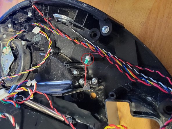

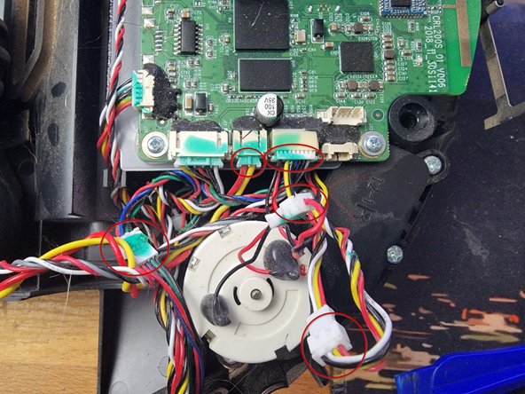

  16. Wyze WVCR200s Wheels Replacement, Change the RIGHT complete wheel assembly: crwdns2935265:016crwdnd2935265:01crwdnd2935265:02crwdne2935265:0 Wyze WVCR200s Wheels Replacement, Change the RIGHT complete wheel assembly: crwdns2935265:016crwdnd2935265:02crwdnd2935265:02crwdne2935265:0
    • There are 5 connectors on a new wheel assembly, but the connectors vary a little for the left wheel assembly vs the right wheel assembly. These images are specific to the right wheel assembly. See the next step for the left wheel assembly images.
    • Locate the 5 connectors on the vacuum. Note the direction all plugs are plugged in so the connectors can be reconnected the same way.
    • Also note in the image, there is a dab of glue (bluish green stuff on each connector) helping to hold the connectors together. It's a good idea to use an adhesive when changing the wheel assembly.
    • Use care when disconnecting and reconnecting the connectors as these can be difficult to get apart.

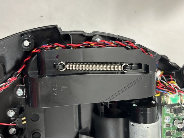

  17. Wyze WVCR200s Wheels Replacement, Change the LEFT wheel assembly: crwdns2935265:017crwdnd2935265:01crwdnd2935265:03crwdne2935265:0 Wyze WVCR200s Wheels Replacement, Change the LEFT wheel assembly: crwdns2935265:017crwdnd2935265:02crwdnd2935265:03crwdne2935265:0 Wyze WVCR200s Wheels Replacement, Change the LEFT wheel assembly: crwdns2935265:017crwdnd2935265:03crwdnd2935265:03crwdne2935265:0
    • This is very similar to the right wheel assembly, but the connector locations are a bit different. MAKE NOTE of how the cables/wires are run around the wheel assembly. Failure to tuck the wires back into the same wire guides may result in issues getting the cover back on, or interference with the bumper switch and or wheel assembly.
    • Locate the 5 connectors for the left wheel assembly. Note the direction for all plugs so the connectors can be reconnected the same way. See the images for the location of the plugs.
    • For the left wheel, two of the sockets for these plugs are under the motherboard. Two others are tucked under the motherboard, and the 5th connector goes to the bin sensor behind the wheel assembly.
    • After replacing the wheel assembly, take your time to make sure all the wires are tucked in properly, and if there's a tie wrap around the cables to hold them out of the way of the bumper switch, replace the tie wrap with a new one.
    • The last image shows a BAD left wheel assembly. Note how the white wire is severed from the plug on the wheel assembly.
