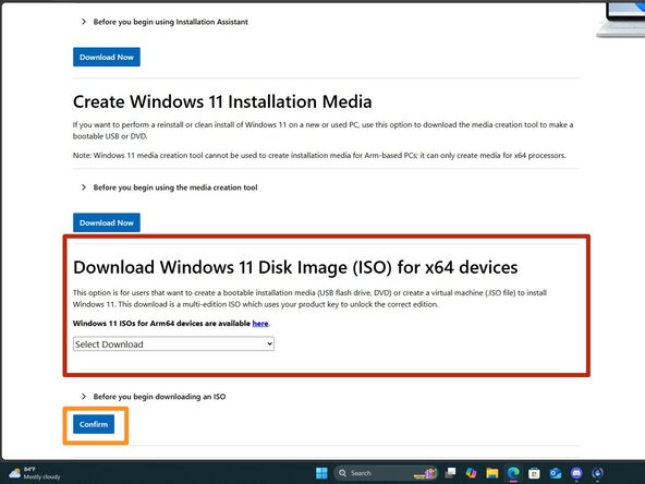

  1. Windows 10/11 - USB Installation Media Creation, Download Windows 10 or 11: crwdns2935265:01crwdnd2935265:01crwdnd2935265:03crwdne2935265:0 Windows 10/11 - USB Installation Media Creation, Download Windows 10 or 11: crwdns2935265:01crwdnd2935265:02crwdnd2935265:03crwdne2935265:0 Windows 10/11 - USB Installation Media Creation, Download Windows 10 or 11: crwdns2935265:01crwdnd2935265:03crwdnd2935265:03crwdne2935265:0
    • NOTE: Due to space limits, I could not include the language selection option. Choose your native language and click "Confirm".
    • For this guide, I am downloading Windows 11, but Windows 10 works the same (but without internet access, you can bypass the account issue without this fix -- but if you want to apply it and be sure, it works the same).
    • Download a Windows 10 or 11 ISO from Microsoft - do not use other sources unless you trust it.
    • Windows 11: https://www.microsoft.com/en-us/software...
    • Windows 10: https://www.microsoft.com/en-us/software...

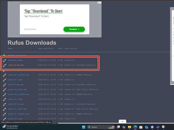

  2. Windows 10/11 - USB Installation Media Creation, Download Rufus: crwdns2935265:02crwdnd2935265:01crwdnd2935265:02crwdne2935265:0 Windows 10/11 - USB Installation Media Creation, Download Rufus: crwdns2935265:02crwdnd2935265:02crwdnd2935265:02crwdne2935265:0
    • THIS PROCEDURE WILL ERASE THE TARGET USB DRIVE! BACKUP THE DRIVE OR USE A NEW ONE IF YOU DO NOT HAVE A DRIVE THAT CAN BE ERASED.
    • If you are reusing an old drive, format it first!
    • IMPORTANT: make sure to use Rufus 3.x, 4.x or newer — anything older will not work. To write the ISO, download Rufus. Place this somewhere it is easily found.
