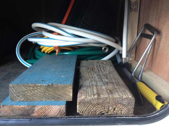

  3. Wilwood 195BH Winterization, Exterior 3 - Bumper cleaning: crwdns2935265:03crwdnd2935265:01crwdnd2935265:02crwdne2935265:0 Wilwood 195BH Winterization, Exterior 3 - Bumper cleaning: crwdns2935265:03crwdnd2935265:02crwdnd2935265:02crwdne2935265:0

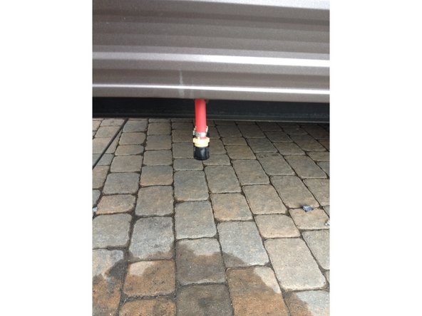

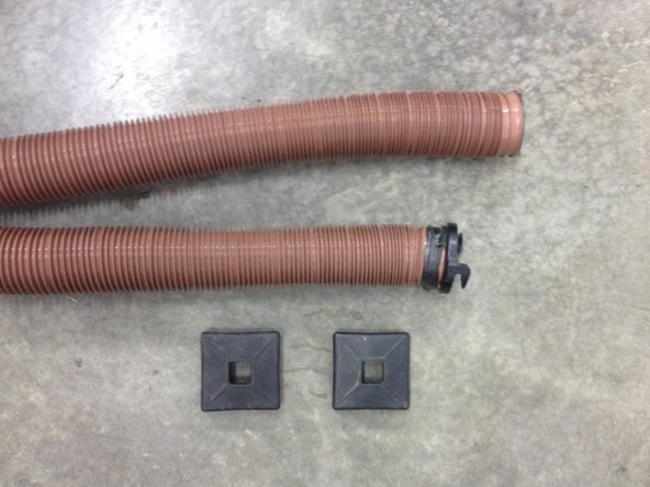

    • After the exterior cleaning, it is an ideal moment to rinse with plenty of water the bumper which also serves as a storage for the sewer pipe.
    • Thoroughly rinse the inner bumper
    • Thoroughly rinse the pipe
    • Leave everything to air dry for a day.
    • A good idea to suspend the pipe so that it drips completely
    • Put it all back in the bumper

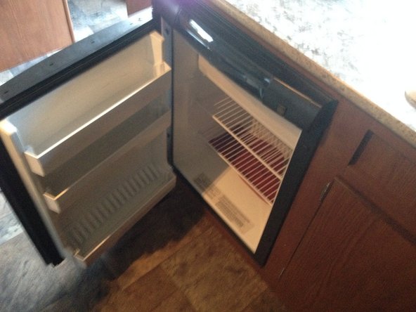

  4. Wilwood 195BH Winterization, Inside 1 - Refrigerated Defrost: crwdns2935265:04crwdnd2935265:01crwdnd2935265:03crwdne2935265:0 Wilwood 195BH Winterization, Inside 1 - Refrigerated Defrost: crwdns2935265:04crwdnd2935265:02crwdnd2935265:03crwdne2935265:0 Wilwood 195BH Winterization, Inside 1 - Refrigerated Defrost: crwdns2935265:04crwdnd2935265:03crwdnd2935265:03crwdne2935265:0
    • Close the refrigerator by pressing OFF
    • Taking tea towels, place it at the bottom of the refrigerator and leave the door open
  5. Wilwood 195BH Winterization, Interior 2 - Fridge - cool: crwdns2935265:05crwdnd2935265:01crwdnd2935265:03crwdne2935265:0 Wilwood 195BH Winterization, Interior 2 - Fridge - cool: crwdns2935265:05crwdnd2935265:02crwdnd2935265:03crwdne2935265:0 Wilwood 195BH Winterization, Interior 2 - Fridge - cool: crwdns2935265:05crwdnd2935265:03crwdnd2935265:03crwdne2935265:0

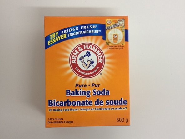

    • The next day, clean dry the inside
    • Place baking soda during hibernation
    • Place scraps of wood so that the freezer compartment can breathe and have air
    • If possible open the door ajar during hibernation

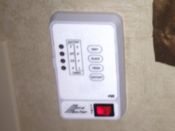

  6. Wilwood 195BH Winterization, Interior 3 - Clean the tank: crwdns2935265:06crwdnd2935265:01crwdnd2935265:03crwdne2935265:0 Wilwood 195BH Winterization, Interior 3 - Clean the tank: crwdns2935265:06crwdnd2935265:02crwdnd2935265:03crwdne2935265:0 Wilwood 195BH Winterization, Interior 3 - Clean the tank: crwdns2935265:06crwdnd2935265:03crwdnd2935265:03crwdne2935265:0
    • With a jet nozzle clean the toilet until no more deposits remain and your outlet water is clear
    • If you are not connected to a drain, you can use a bucket and gloves
    • This is the last step where you have running water in the trailer

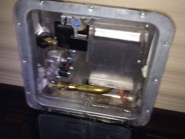

  7. Wilwood 195BH Winterization, Water heater 1 - Closing the valve: crwdns2935265:07crwdnd2935265:01crwdnd2935265:03crwdne2935265:0 Wilwood 195BH Winterization, Water heater 1 - Closing the valve: crwdns2935265:07crwdnd2935265:02crwdnd2935265:03crwdne2935265:0 Wilwood 195BH Winterization, Water heater 1 - Closing the valve: crwdns2935265:07crwdnd2935265:03crwdnd2935265:03crwdne2935265:0
    • Make sure the heater has been completely shut down for a long time. RISK OF INJURY
    • Make sure the water is turned off before starting the conduit winterization steps
    • The valves are placed in such a way as to allocate cold water into the water heater and out. The cold-hot junction valve is closed
    • Open valves to prevent cold water from entering and hot water from exiting. Open the cold-hot junction valve
  8. Wilwood 195BH Winterization, Water heater 2 - Water drain: crwdns2935265:08crwdnd2935265:01crwdnd2935265:03crwdne2935265:0 Wilwood 195BH Winterization, Water heater 2 - Water drain: crwdns2935265:08crwdnd2935265:02crwdnd2935265:03crwdne2935265:0 Wilwood 195BH Winterization, Water heater 2 - Water drain: crwdns2935265:08crwdnd2935265:03crwdnd2935265:03crwdne2935265:0
    • To drain the water heater, the anode must be unscrewed with a 1 and 1/16 inch socket.
    • Note that I needed a 3/8 to 1/2 adapter to use the socket with my "ratchets"
    • Release pressure by pressing the valve repeatedly
    • Unscrew the anode completely and let the water flow completely out of the water heater
    • The teflon tape will be to replace that of the anode next spring
    • Once empty replace the anode

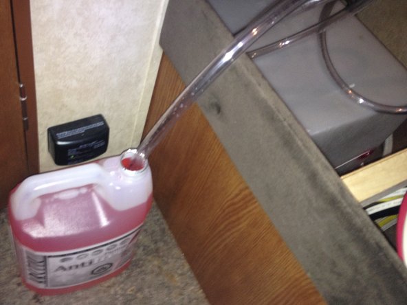

    • The installation of a Tee was necessary so as not to have to dismantle the connector from the tank
    • Turn the valve down (for my system) and the pump will draw liquid from the food grade antifreeze container
    • Start the pump
  10. Wilwood 195BH Winterization, Antifreeze 2: crwdns2935265:010crwdnd2935265:01crwdnd2935265:03crwdne2935265:0 Wilwood 195BH Winterization, Antifreeze 2: crwdns2935265:010crwdnd2935265:02crwdnd2935265:03crwdne2935265:0 Wilwood 195BH Winterization, Antifreeze 2: crwdns2935265:010crwdnd2935265:03crwdnd2935265:03crwdne2935265:0
    • Make sure you've done step 7! Antifreeze MUST NOT enter the water heater!
    • Always one faucet at a time, start with the sink cold water stop when the antifreeze comes out fully pink
    • Continue with the hot water tap
    • Go use the toilet
    • Do NOT leave antifreeze in the bottom of the toilet all winter. Antifreeze stains plastic

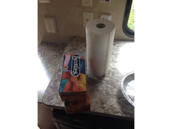

  12. Wilwood 195BH Winterization, Finish 1: crwdns2935265:012crwdnd2935265:01crwdnd2935265:03crwdne2935265:0 Wilwood 195BH Winterization, Finish 1: crwdns2935265:012crwdnd2935265:02crwdnd2935265:03crwdne2935265:0 Wilwood 195BH Winterization, Finish 1: crwdns2935265:012crwdnd2935265:03crwdnd2935265:03crwdne2935265:0
    • Take the fire extinguisher, shake it to stir the powder inside
    • You can knock it lightly on a padded surface
    • Remove any type of fabric likely to be undone by mice or rodents: tissues, paper towels, etc.
    • Finally, place Bounce sheets under mattresses and other pillows.
    • Placed in places near an exterior mouth keep mice and other rodents away with their scent

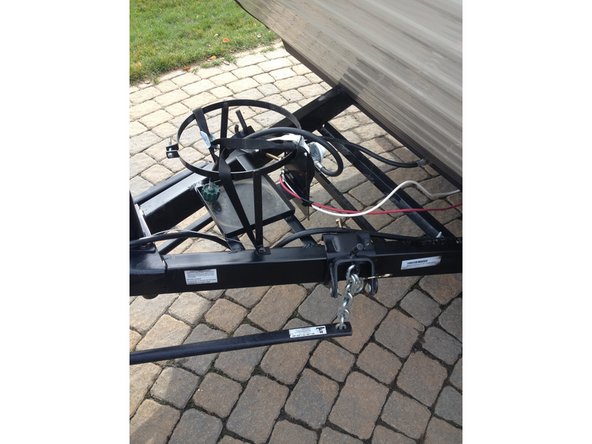

    • Disassemble the tank, tie the wires securely so they don't hang or catch anything along the way.
    • Burn the excess gas via the rings, the fridge, the water heater. As soon as the flame starter clicks stop
  14. Wilwood 195BH Winterization, Finish 3: crwdns2935265:014crwdnd2935265:01crwdnd2935265:03crwdne2935265:0 Wilwood 195BH Winterization, Finish 3: crwdns2935265:014crwdnd2935265:02crwdnd2935265:03crwdne2935265:0 Wilwood 195BH Winterization, Finish 3: crwdns2935265:014crwdnd2935265:03crwdnd2935265:03crwdne2935265:0
    • Close the circuit breakers so as not to draw all the energy from the battery of the towing vehicle during the trip to storage
    • Disconnect the battery and store it out of the gel on a wooden or plastic surface. Anything but concrete. Recharge the battery once or twice during the winter and before leaving with the trailer
    • Tie the battery wires securely
    • Open drain plugs to remove excess water
