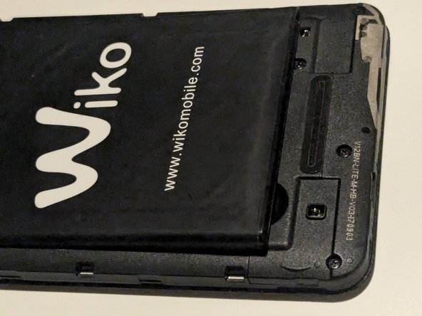

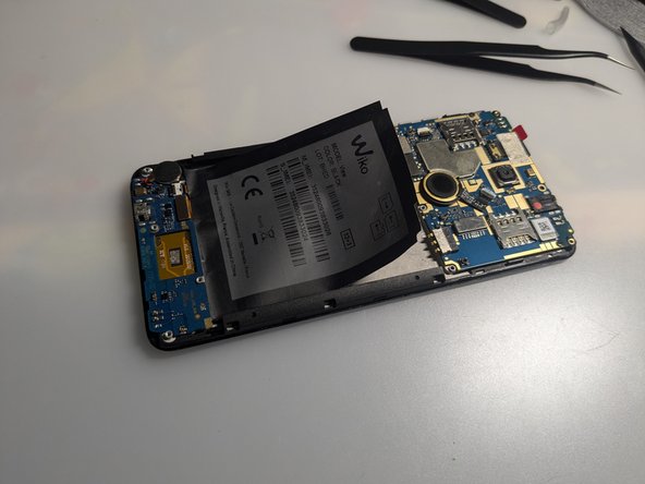

    2. Wiko View Screen Replacement, Remove the battery: crwdns2935265:03crwdnd2935265:01crwdnd2935265:03crwdne2935265:0 Wiko View Screen Replacement, Remove the battery: crwdns2935265:03crwdnd2935265:02crwdnd2935265:03crwdne2935265:0 Wiko View Screen Replacement, Remove the battery: crwdns2935265:03crwdnd2935265:03crwdnd2935265:03crwdne2935265:0
      • Once the back cover is completely removed, you can remove the battery by lifting it from the bottom-left corner.
      • There is another small gap for help.
      • You won't need the help of any tool for this.

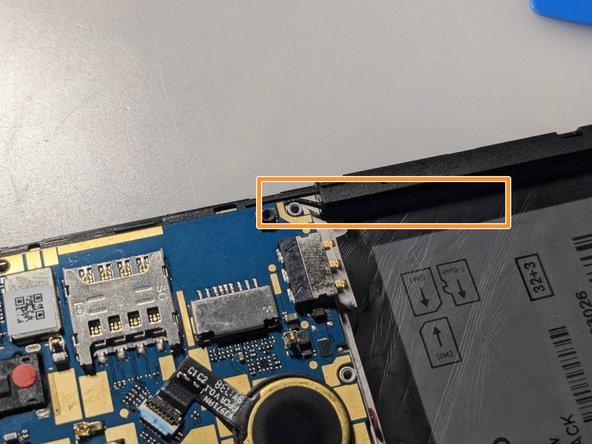

      • From now on, be very careful not to damage the tiny metal springs. The next steps will remove any protection for them; they are thin and very easy to break.
      • If you break one of them, you need to do precision soldering (or just tape it back in place with electrical tape for a quicker but very cheap solution).

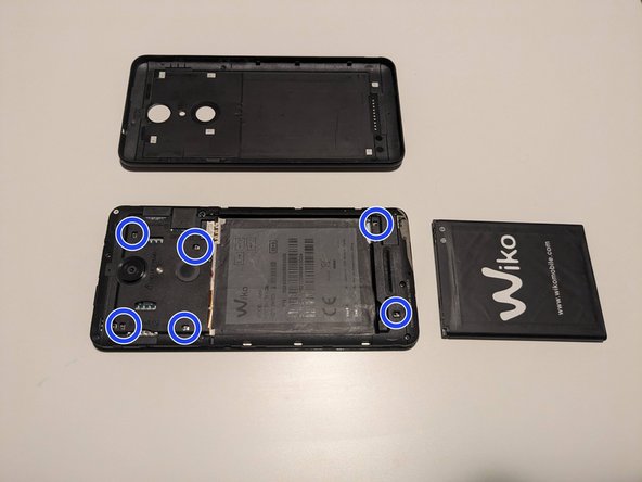

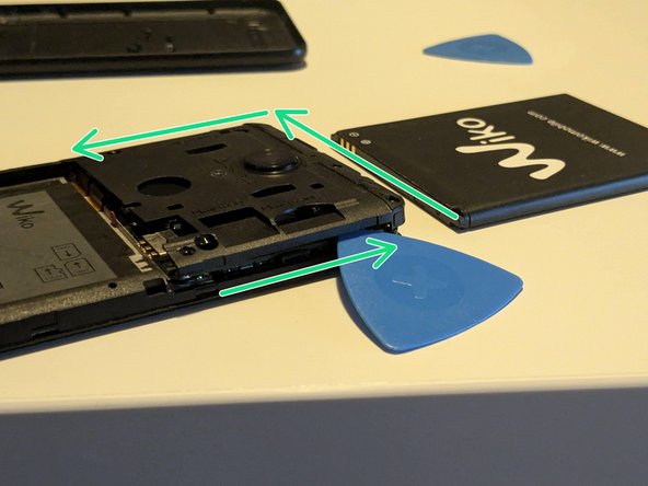

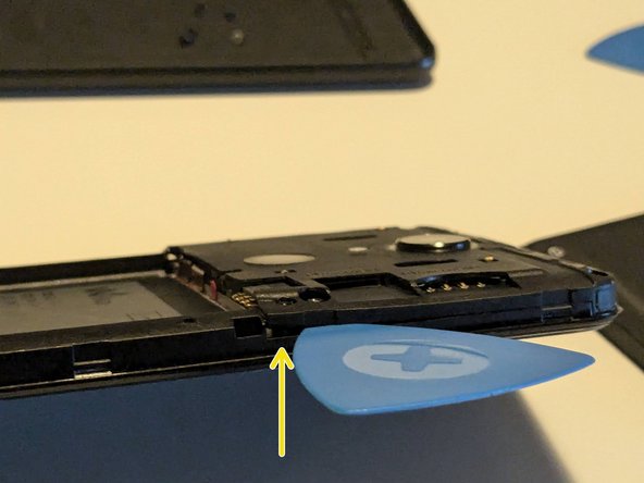

    3. Wiko View Screen Replacement, Remove the top plastic cover: crwdns2935265:04crwdnd2935265:01crwdnd2935265:03crwdne2935265:0 Wiko View Screen Replacement, Remove the top plastic cover: crwdns2935265:04crwdnd2935265:02crwdnd2935265:03crwdne2935265:0 Wiko View Screen Replacement, Remove the top plastic cover: crwdns2935265:04crwdnd2935265:03crwdnd2935265:03crwdne2935265:0
      • Remove every SIM or SD card from the slots.
      • Unscrew all the six screws from the top plastic cover.
      • Start to lift gently the cover using opening picks from its bottom-right corner.
      • Only insert the pick up to 3.5 mm to avoid damaging the internals.
      • Keep pushing the opening pick along all the external sides of the plastic cover.
      • You need to open all the plastic clips hidden under the cover itself. You can notice a soft "pop" when opening successfully one of them.
      • When all the clips are opened, you can lift the cover completely with caution.

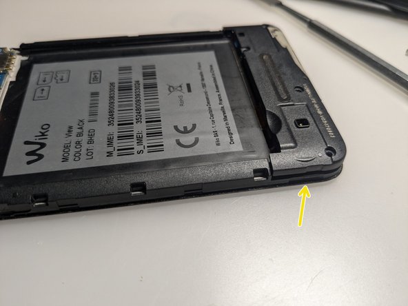

    6. Wiko View Screen Replacement, Remove the bottom plastic cover: crwdns2935265:07crwdnd2935265:01crwdnd2935265:03crwdne2935265:0 Wiko View Screen Replacement, Remove the bottom plastic cover: crwdns2935265:07crwdnd2935265:02crwdnd2935265:03crwdne2935265:0 Wiko View Screen Replacement, Remove the bottom plastic cover: crwdns2935265:07crwdnd2935265:03crwdnd2935265:03crwdne2935265:0
      • Unscrew all four screws.
      • Like in the Step 4, use an opening pick to lift and remove carefully the cover from the bottom-left corner.

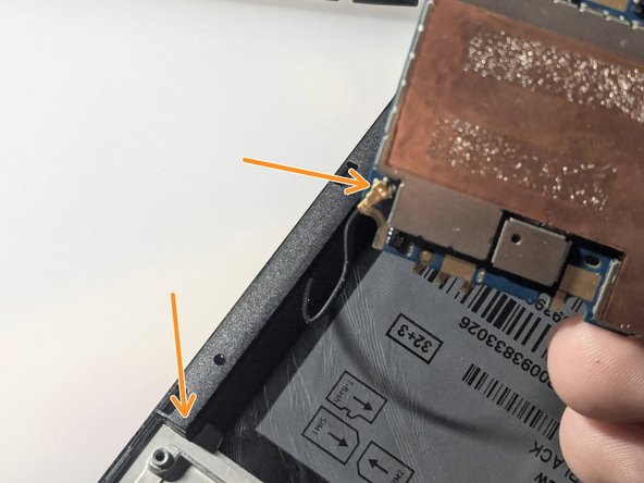

    7. Wiko View Screen Replacement, Remove the motherboard: crwdns2935265:08crwdnd2935265:01crwdnd2935265:03crwdne2935265:0 Wiko View Screen Replacement, Remove the motherboard: crwdns2935265:08crwdnd2935265:02crwdnd2935265:03crwdne2935265:0 Wiko View Screen Replacement, Remove the motherboard: crwdns2935265:08crwdnd2935265:03crwdnd2935265:03crwdne2935265:0
      • Unscrew the two screws that hold the motherboard.
      • Do not apply force to remove the motherboard, otherwise you will cut the antenna cable.
      • Gently lift the motherboard passing the cable under the plastic frame and go to the next step.

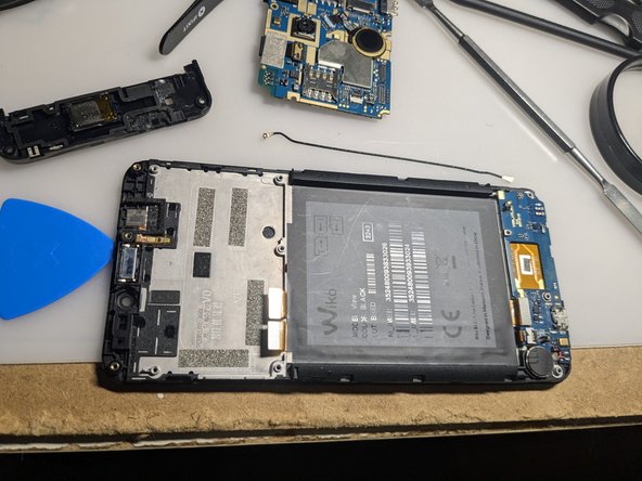

    8. Wiko View Screen Replacement, Remove the antenna cable: crwdns2935265:09crwdnd2935265:01crwdnd2935265:02crwdne2935265:0 Wiko View Screen Replacement, Remove the antenna cable: crwdns2935265:09crwdnd2935265:02crwdnd2935265:02crwdne2935265:0
      • Unplug the antenna cable from both ends.
      • It has a coaxial connector.
      • Remember to reconnect the antenna cable before remounting the motherboard.

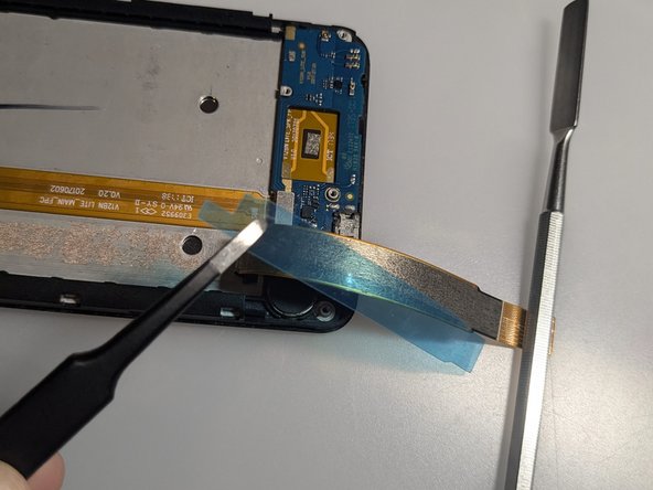

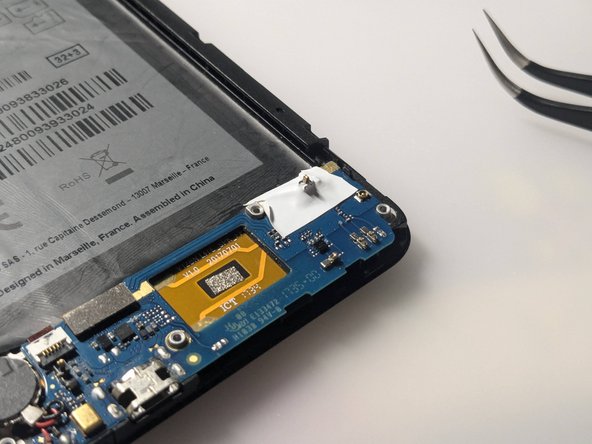

    9. Wiko View Screen Replacement, Remove the sticker: crwdns2935265:010crwdnd2935265:01crwdnd2935265:02crwdne2935265:0 Wiko View Screen Replacement, Remove the sticker: crwdns2935265:010crwdnd2935265:02crwdnd2935265:02crwdne2935265:0
      • With the help of a tweezer, remove slowly the back sticker.
      • Take note of the codes written in case it breaks.
      • After the substitution, you can put it back where was.

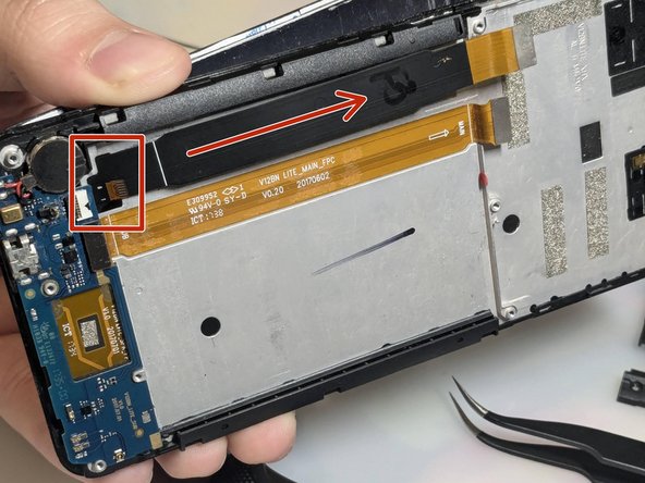

    10. Wiko View Screen Replacement, Unplug the motherboard's link cable: crwdns2935265:011crwdnd2935265:01crwdnd2935265:02crwdne2935265:0 Wiko View Screen Replacement, Unplug the motherboard's link cable: crwdns2935265:011crwdnd2935265:02crwdnd2935265:02crwdne2935265:0
      • Unplug the cable that links the two motherboards.
      • Do not completely remove the cable from the metal case.

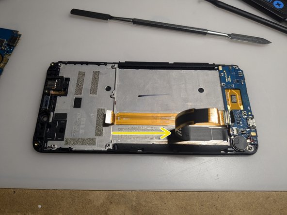

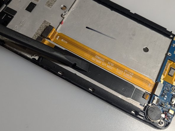

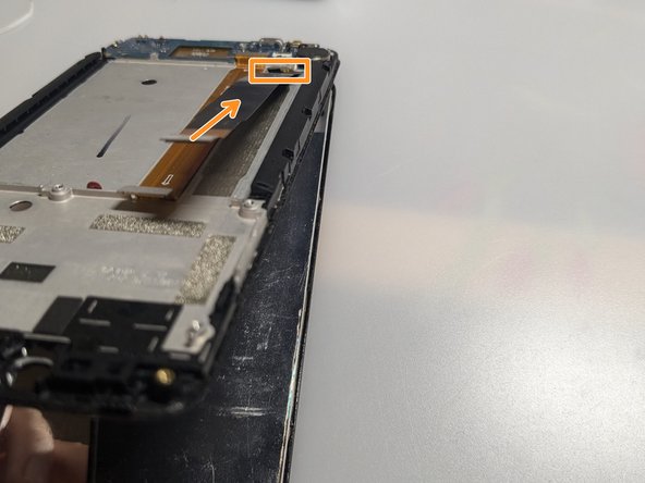

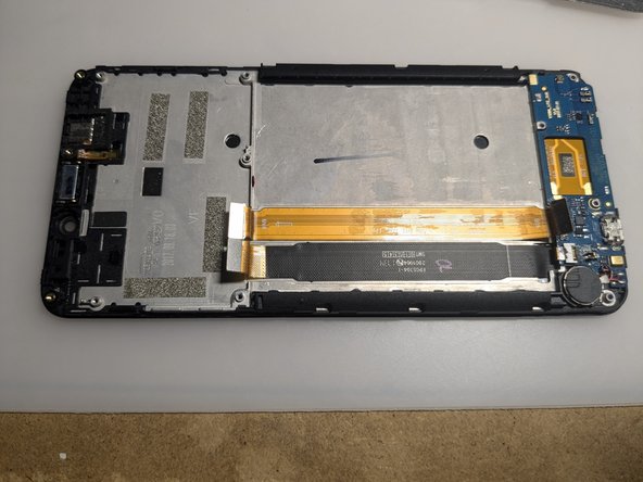

    11. Wiko View Screen Replacement, Remove the display cable: crwdns2935265:012crwdnd2935265:01crwdnd2935265:03crwdne2935265:0 Wiko View Screen Replacement, Remove the display cable: crwdns2935265:012crwdnd2935265:02crwdnd2935265:03crwdne2935265:0 Wiko View Screen Replacement, Remove the display cable: crwdns2935265:012crwdnd2935265:03crwdnd2935265:03crwdne2935265:0
      • First, unplug the cable from the bottom motherboard.
      • It's a "no-fuss" ribble cable connector.
      • Then slowly pull the bigger cable.

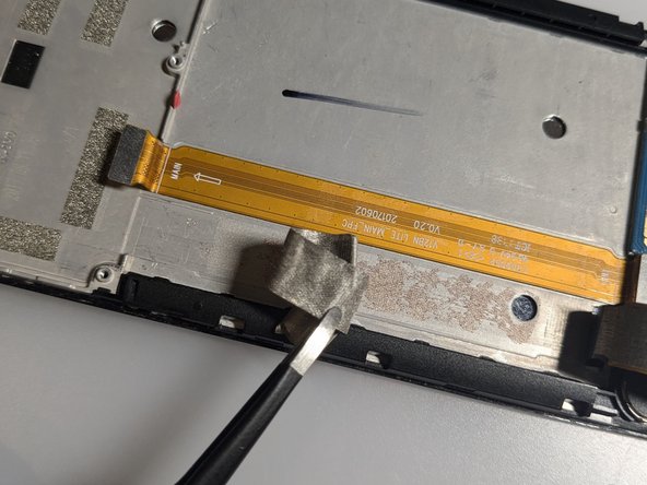

      • The cable is glued to the metal case.
      • Be sure to lift the cable for all its length, so the adhesive won't keep it in place and break it in the following steps.
      • Do not completely remove the cable - it is linked to the display under the metal case.
      • Remove the grey adhesive.

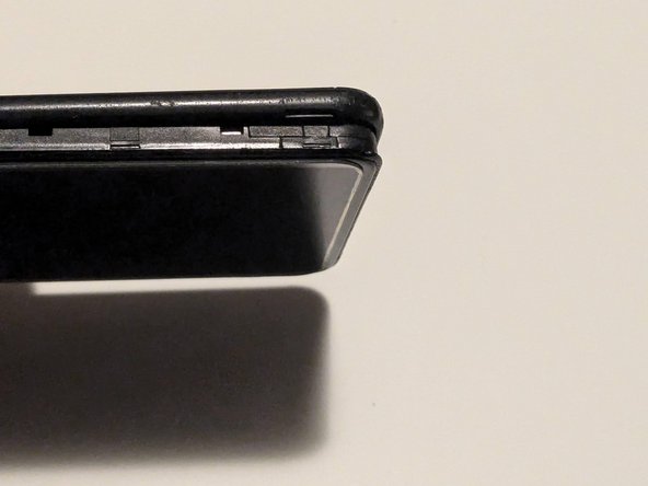

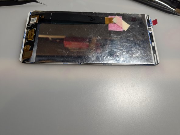

    12. Wiko View Screen Replacement, Remove the display: crwdns2935265:013crwdnd2935265:01crwdnd2935265:03crwdne2935265:0 Wiko View Screen Replacement, Remove the display: crwdns2935265:013crwdnd2935265:02crwdnd2935265:03crwdne2935265:0 Wiko View Screen Replacement, Remove the display: crwdns2935265:013crwdnd2935265:03crwdnd2935265:03crwdne2935265:0
      • Heat an iOpener and apply it to the right edge of the screen for two minutes.
      • A hair dryer, heat gun, or hot plate may also be used, but be careful not to overheat the phone - the display is susceptible to heat damage.
      • Apply a suction cup to the screen, as close to the center of the right edge as possible, and pull up with strong, steady force to create a gap between the bezel and the frame.
      • Insert an opening pick into the gap.
      • Depending on the age of your phone, this may be difficult. If you're having trouble, apply more heat to the edge and try again. You can also use a Jimmy instead (being very careful not to scratch the metal frame). If your display is badly cracked, covering it with a layer of clear packing tape may allow the suction cup to adhere.

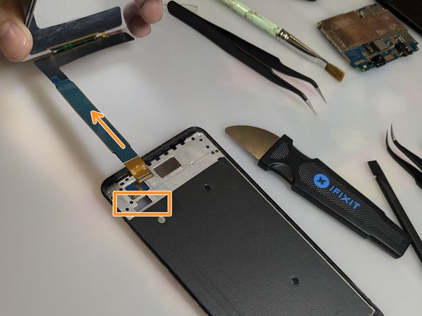

      • Release all the clips and unglue the screen.
      • Pull the cable through the frame's opening.

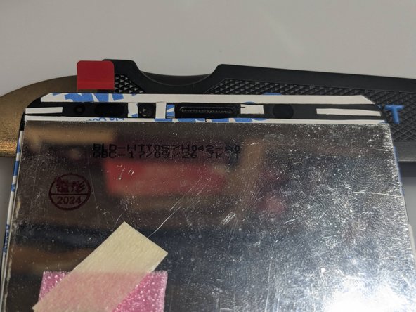

    13. Wiko View Screen Replacement, Remove adhesives: crwdns2935265:014crwdnd2935265:01crwdnd2935265:01crwdne2935265:0
      • Remove the adhesive backings from the new part
      • Remove the protective adhesive in front of the screen only when the reparation is complete.

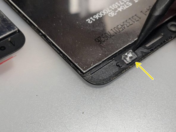

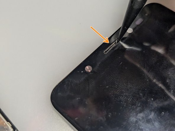

    14. Wiko View Screen Replacement, Transfer the remaining components: crwdns2935265:015crwdnd2935265:01crwdnd2935265:03crwdne2935265:0 Wiko View Screen Replacement, Transfer the remaining components: crwdns2935265:015crwdnd2935265:02crwdnd2935265:03crwdne2935265:0 Wiko View Screen Replacement, Transfer the remaining components: crwdns2935265:015crwdnd2935265:03crwdnd2935265:03crwdne2935265:0
      • Compare your new replacement part to the original part - you may need to transfer the remaining components.
      • For example:
      • The ear capsule grid.
      • The lens of the internal flash.
    15. Wiko View Screen Replacement, Add the new adhesive: crwdns2935265:016crwdnd2935265:01crwdnd2935265:03crwdne2935265:0 Wiko View Screen Replacement, Add the new adhesive: crwdns2935265:016crwdnd2935265:02crwdnd2935265:03crwdne2935265:0 Wiko View Screen Replacement, Add the new adhesive: crwdns2935265:016crwdnd2935265:03crwdnd2935265:03crwdne2935265:0
      • Fill all the screen's borders with the double-sided adhesive.
      • You can use the precision tweezer and spudger to help you position and compress the tape in place.
    16. Wiko View Screen Replacement, Place the new display cable: crwdns2935265:017crwdnd2935265:01crwdnd2935265:02crwdne2935265:0 Wiko View Screen Replacement, Place the new display cable: crwdns2935265:017crwdnd2935265:02crwdnd2935265:02crwdne2935265:0
      • Insert the new display cable in the metal case opening.
