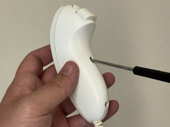

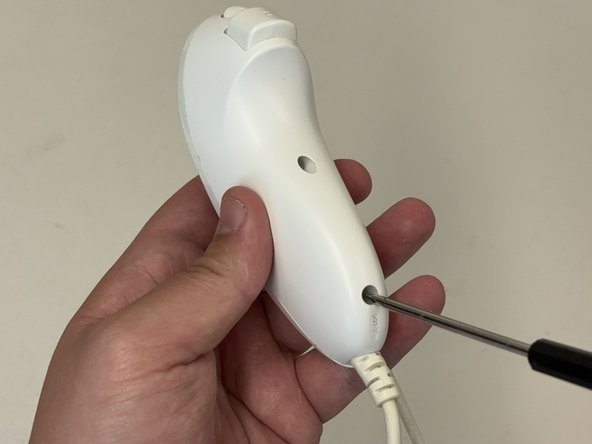

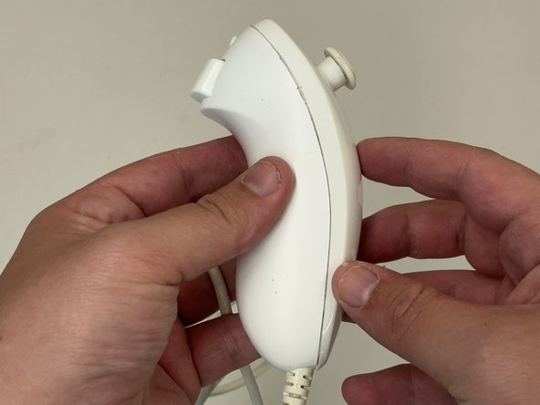

    • Use a Tri-point Y0 screwdriver to remove the two 9.2 mm screws from the back of the controller.
  2. Wii Nunchuk Joystick and Button Replacement: crwdns2935265:02crwdnd2935265:01crwdnd2935265:03crwdne2935265:0 Wii Nunchuk Joystick and Button Replacement: crwdns2935265:02crwdnd2935265:02crwdnd2935265:03crwdne2935265:0 Wii Nunchuk Joystick and Button Replacement: crwdns2935265:02crwdnd2935265:03crwdnd2935265:03crwdne2935265:0
    • Use a spudger or your hands to separate the top case of the Wii Nunchuk.
    • To remove it you will need to apply pressure at the top of the device near the joysick first. Once you apply pressure, gently pry apart the controller.

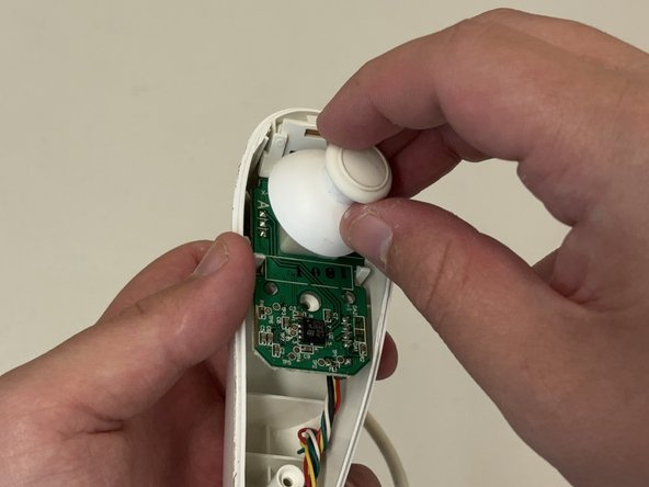

  3. Wii Nunchuk Joystick and Button Replacement: crwdns2935265:03crwdnd2935265:01crwdnd2935265:01crwdne2935265:0

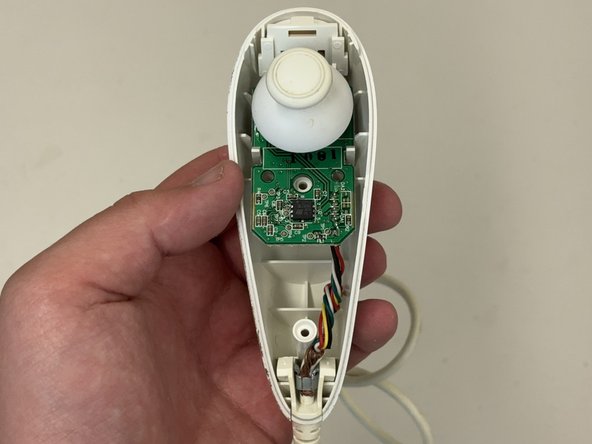

    • Pull the joystick off the attachment on the motherboard.
    • This will also expose the gyroscopic mechanism and allow you to clean off any debris that could be causing issues. Use a lint free cloth and isopropyl alcohol to clean the area. Make sure to let it dry before you reassemble the device.

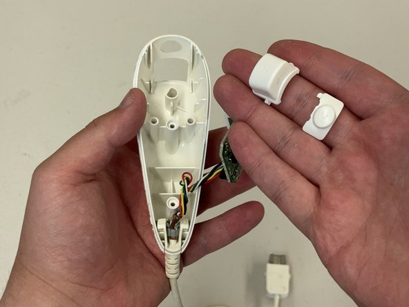

  4. Wii Nunchuk Joystick and Button Replacement: crwdns2935265:04crwdnd2935265:01crwdnd2935265:02crwdne2935265:0 Wii Nunchuk Joystick and Button Replacement: crwdns2935265:04crwdnd2935265:02crwdnd2935265:02crwdne2935265:0

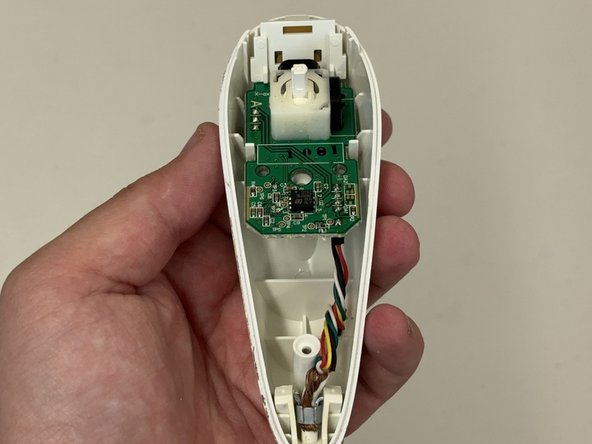

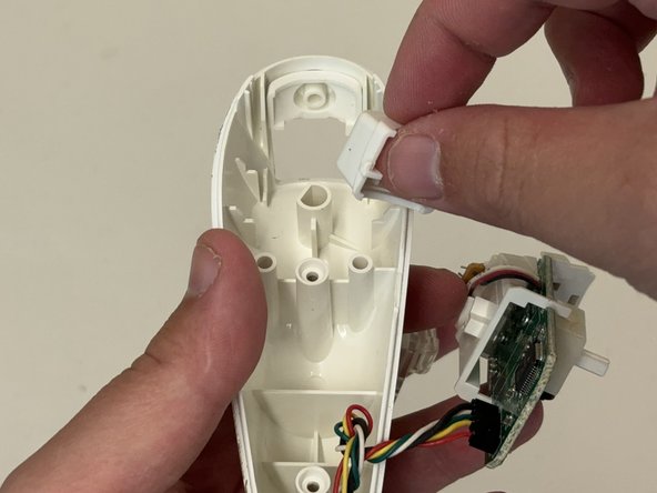

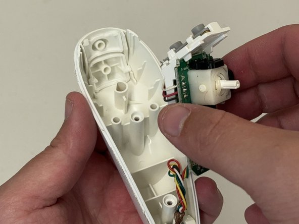

    • Take the motherboard by the edges, and gently lift it out of the shell, exposing the buttons.
  5. Wii Nunchuk Joystick and Button Replacement: crwdns2935265:05crwdnd2935265:01crwdnd2935265:03crwdne2935265:0 Wii Nunchuk Joystick and Button Replacement: crwdns2935265:05crwdnd2935265:02crwdnd2935265:03crwdne2935265:0 Wii Nunchuk Joystick and Button Replacement: crwdns2935265:05crwdnd2935265:03crwdnd2935265:03crwdne2935265:0
    • Set the motherboard to the side so that it is out of the way.
    • Push the buttons in from the outside of the device to pop them out.
    • Set the new buttons into the cutouts of the controller shell, ensuring they sit flush inside the controller.

  7. Wii Nunchuk Joystick and Button Replacement: crwdns2935265:07crwdnd2935265:01crwdnd2935265:03crwdne2935265:0 Wii Nunchuk Joystick and Button Replacement: crwdns2935265:07crwdnd2935265:02crwdnd2935265:03crwdne2935265:0 Wii Nunchuk Joystick and Button Replacement: crwdns2935265:07crwdnd2935265:03crwdnd2935265:03crwdne2935265:0
    • Push the new joystick onto the white attachment on the motherboard.
    • Make sure that the notch on the joystick and the notch on the attachment point line up to ensure a secure fit. The joystick may not attach if the notches are not aligned.
