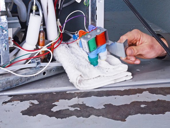

    • Pull the inlet valve assembly off its slot in the chassis and rest it on the floor.
  8. Whirlpool Refrigerator Water Inlet Valve Replacement: crwdns2935265:08crwdnd2935265:01crwdnd2935265:02crwdne2935265:0 Whirlpool Refrigerator Water Inlet Valve Replacement: crwdns2935265:08crwdnd2935265:02crwdnd2935265:02crwdne2935265:0
    • Place a clean and dry rag under the inlet valve assembly before continuing.

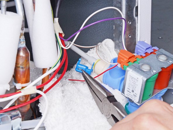

  9. Whirlpool Refrigerator Water Inlet Valve Replacement, Remove the clip: crwdns2935265:09crwdnd2935265:01crwdnd2935265:02crwdne2935265:0 Whirlpool Refrigerator Water Inlet Valve Replacement, Remove the clip: crwdns2935265:09crwdnd2935265:02crwdnd2935265:02crwdne2935265:0
    • Use needle nose pliers, or your hands, to pull the clip off the rear water hose.
  10. Whirlpool Refrigerator Water Inlet Valve Replacement: crwdns2935265:010crwdnd2935265:01crwdnd2935265:03crwdne2935265:0 Whirlpool Refrigerator Water Inlet Valve Replacement: crwdns2935265:010crwdnd2935265:02crwdnd2935265:03crwdne2935265:0 Whirlpool Refrigerator Water Inlet Valve Replacement: crwdns2935265:010crwdnd2935265:03crwdnd2935265:03crwdne2935265:0
    • Push the yellow plastic ring above the rear water hose to release its clips.
    • As you push the ring, pull the water hose away from the inlet valve assembly to disconnect it.
