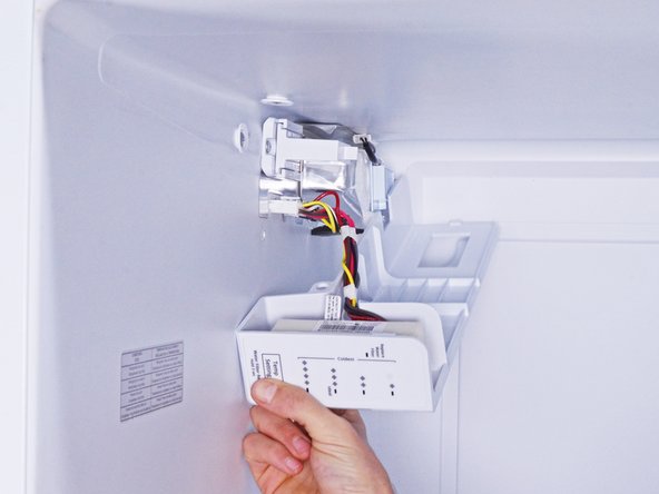

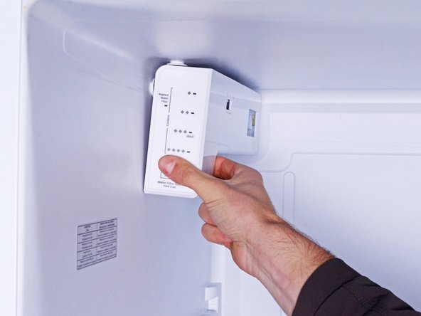

  4. Whirlpool Refrigerator Thermistor Replacement, Reposition the assembly: crwdns2935265:04crwdnd2935265:01crwdnd2935265:03crwdne2935265:0 Whirlpool Refrigerator Thermistor Replacement, Reposition the assembly: crwdns2935265:04crwdnd2935265:02crwdnd2935265:03crwdne2935265:0 Whirlpool Refrigerator Thermistor Replacement, Reposition the assembly: crwdns2935265:04crwdnd2935265:03crwdnd2935265:03crwdne2935265:0
    • Pull the temperature control board assembly off its slot in the chassis.
    • Let the assembly hang to access its connectors.
  5. Whirlpool Refrigerator Thermistor Replacement, Disconnect the temperature control board: crwdns2935265:05crwdnd2935265:01crwdnd2935265:03crwdne2935265:0 Whirlpool Refrigerator Thermistor Replacement, Disconnect the temperature control board: crwdns2935265:05crwdnd2935265:02crwdnd2935265:03crwdne2935265:0 Whirlpool Refrigerator Thermistor Replacement, Disconnect the temperature control board: crwdns2935265:05crwdnd2935265:03crwdnd2935265:03crwdne2935265:0
    • Use a flathead screwdriver, or a similar tool, to disconnect any connectors attached to the temperature control board assembly.
  6. Whirlpool Refrigerator Thermistor Replacement, Remove the assembly: crwdns2935265:06crwdnd2935265:01crwdnd2935265:01crwdne2935265:0
    • Remove the temperature control board assembly.

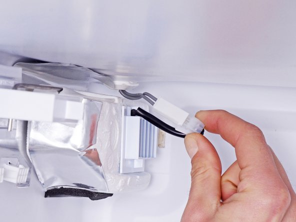

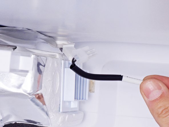

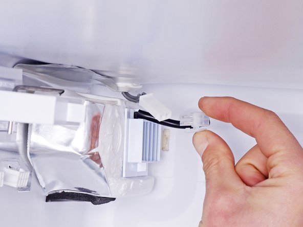

  7. Whirlpool Refrigerator Thermistor Replacement, Disconnect the thermistor: crwdns2935265:07crwdnd2935265:01crwdnd2935265:03crwdne2935265:0 Whirlpool Refrigerator Thermistor Replacement, Disconnect the thermistor: crwdns2935265:07crwdnd2935265:02crwdnd2935265:03crwdne2935265:0 Whirlpool Refrigerator Thermistor Replacement, Disconnect the thermistor: crwdns2935265:07crwdnd2935265:03crwdnd2935265:03crwdne2935265:0
    • Disconnect any connectors attached to the thermistor.
  8. Whirlpool Refrigerator Thermistor Replacement, Remove the thermistor: crwdns2935265:08crwdnd2935265:01crwdnd2935265:02crwdne2935265:0 Whirlpool Refrigerator Thermistor Replacement, Remove the thermistor: crwdns2935265:08crwdnd2935265:02crwdnd2935265:02crwdne2935265:0
    • Use a flathead screwdriver, or a similar tool, to pry up the thermistor from its slot in the chassis.
    • Remove the thermistor.
