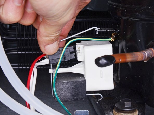

  4. Whirlpool Refrigerator Start Relay Assembly Replacement, Disconnect the start relay assembly: crwdns2935265:04crwdnd2935265:01crwdnd2935265:03crwdne2935265:0 Whirlpool Refrigerator Start Relay Assembly Replacement, Disconnect the start relay assembly: crwdns2935265:04crwdnd2935265:02crwdnd2935265:03crwdne2935265:0 Whirlpool Refrigerator Start Relay Assembly Replacement, Disconnect the start relay assembly: crwdns2935265:04crwdnd2935265:03crwdnd2935265:03crwdne2935265:0
    • Use a flathead screwdriver, or a similar tool, to disconnect any connectors attached to the start relay assembly.

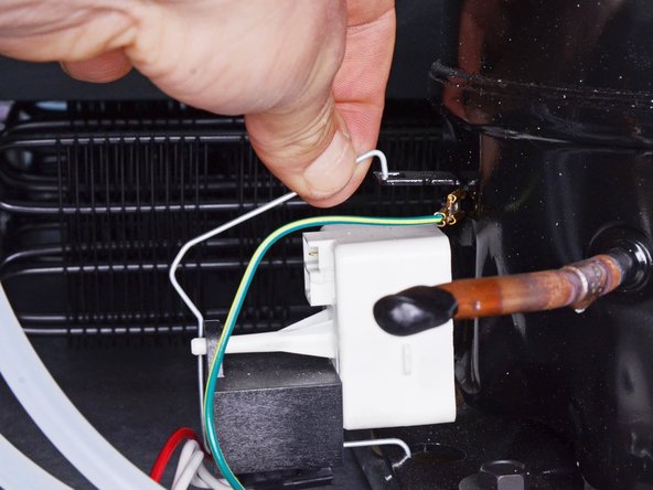

  5. Whirlpool Refrigerator Start Relay Assembly Replacement, Unclip the start relay assembly: crwdns2935265:05crwdnd2935265:01crwdnd2935265:03crwdne2935265:0 Whirlpool Refrigerator Start Relay Assembly Replacement, Unclip the start relay assembly: crwdns2935265:05crwdnd2935265:02crwdnd2935265:03crwdne2935265:0 Whirlpool Refrigerator Start Relay Assembly Replacement, Unclip the start relay assembly: crwdns2935265:05crwdnd2935265:03crwdnd2935265:03crwdne2935265:0
    • Pull the metal clip out its hole in the top of the start relay assembly.
    • Rest the clip next to the assembly.
  6. Whirlpool Refrigerator Start Relay Assembly Replacement, Remove the start relay assembly: crwdns2935265:06crwdnd2935265:01crwdnd2935265:03crwdne2935265:0 Whirlpool Refrigerator Start Relay Assembly Replacement, Remove the start relay assembly: crwdns2935265:06crwdnd2935265:02crwdnd2935265:03crwdne2935265:0 Whirlpool Refrigerator Start Relay Assembly Replacement, Remove the start relay assembly: crwdns2935265:06crwdnd2935265:03crwdnd2935265:03crwdne2935265:0
    • Pull the start relay assembly straight off its prongs in the chassis.
    • Remove the start relay assembly.
    • The assembly consists of the run capacitor, start relay, and overload relay.

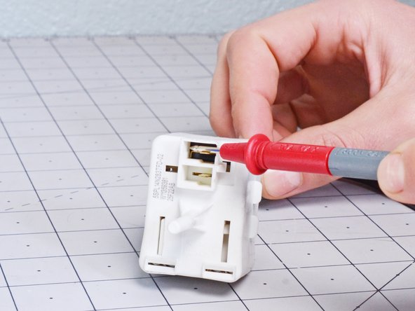

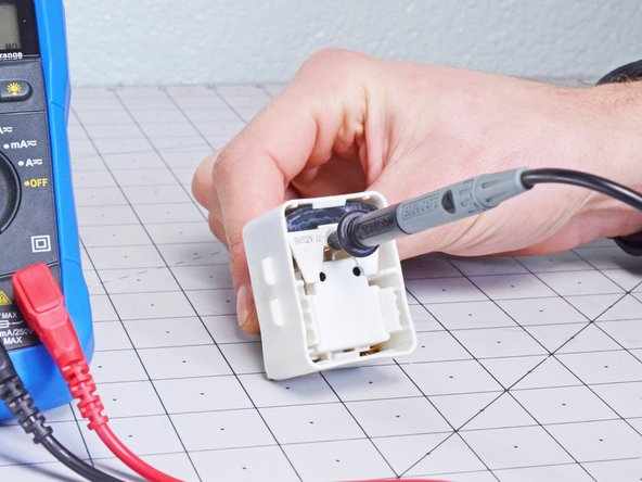

  7. Whirlpool Refrigerator Start Relay Assembly Replacement, Meter the start relay assembly: crwdns2935265:07crwdnd2935265:01crwdnd2935265:03crwdne2935265:0 Whirlpool Refrigerator Start Relay Assembly Replacement, Meter the start relay assembly: crwdns2935265:07crwdnd2935265:02crwdnd2935265:03crwdne2935265:0 Whirlpool Refrigerator Start Relay Assembly Replacement, Meter the start relay assembly: crwdns2935265:07crwdnd2935265:03crwdnd2935265:03crwdne2935265:0
    • If you own a multimeter, you can test the start relay and overload relay's resistance.
    • A range between 0–1 Ω for the overload relay, and 0–5 Ω for the start relay is acceptable.
