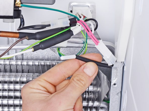

  7. Whirlpool Refrigerator Freezer Thermistor Replacement, Unclip the thermistor: crwdns2935265:07crwdnd2935265:01crwdnd2935265:03crwdne2935265:0 Whirlpool Refrigerator Freezer Thermistor Replacement, Unclip the thermistor: crwdns2935265:07crwdnd2935265:02crwdnd2935265:03crwdne2935265:0 Whirlpool Refrigerator Freezer Thermistor Replacement, Unclip the thermistor: crwdns2935265:07crwdnd2935265:03crwdnd2935265:03crwdne2935265:0
    • Use a spudger to push the tip of the thermistor through its slot in the wire harness.

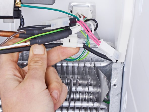

  8. Whirlpool Refrigerator Freezer Thermistor Replacement, Disconnect the thermistor: crwdns2935265:08crwdnd2935265:01crwdnd2935265:02crwdne2935265:0 Whirlpool Refrigerator Freezer Thermistor Replacement, Disconnect the thermistor: crwdns2935265:08crwdnd2935265:02crwdnd2935265:02crwdne2935265:0
    • Disconnect any connectors attached to the thermistor.
  9. Whirlpool Refrigerator Freezer Thermistor Replacement, Remove the thermistor: crwdns2935265:09crwdnd2935265:01crwdnd2935265:01crwdne2935265:0
    • Remove the thermistor.
