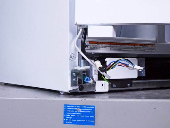

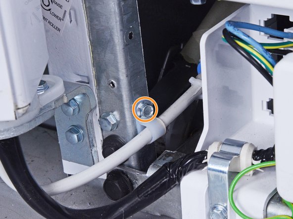

  5. Whirlpool Refrigerator Freezer Door Replacement, Unfasten the door connections: crwdns2935265:05crwdnd2935265:01crwdnd2935265:02crwdne2935265:0 Whirlpool Refrigerator Freezer Door Replacement, Unfasten the door connections: crwdns2935265:05crwdnd2935265:02crwdnd2935265:02crwdne2935265:0
    • Remove the screw(s) securing the freezer door wiring harness.
    • Remove the screw(s) securing the freezer door water hose.

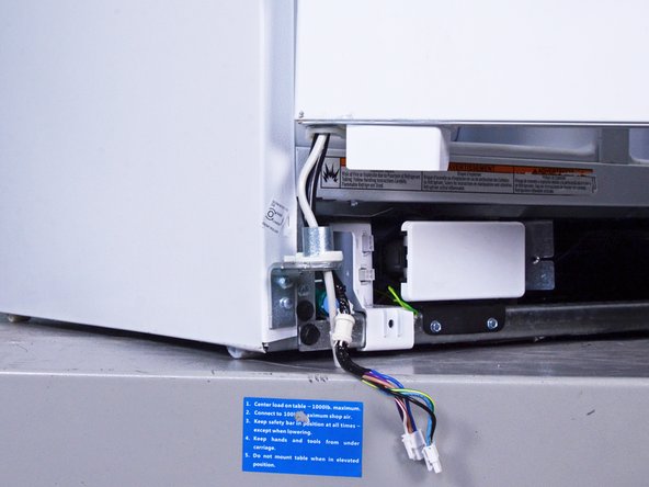

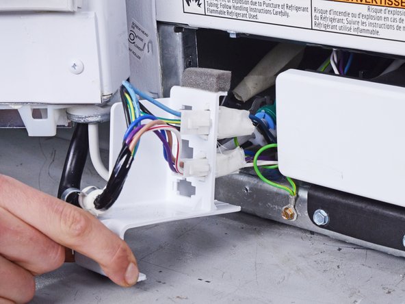

  6. Whirlpool Refrigerator Freezer Door Replacement, Reposition the wiring harness: crwdns2935265:06crwdnd2935265:01crwdnd2935265:02crwdne2935265:0 Whirlpool Refrigerator Freezer Door Replacement, Reposition the wiring harness: crwdns2935265:06crwdnd2935265:02crwdnd2935265:02crwdne2935265:0

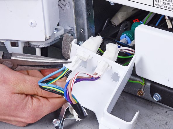

    • Pull the wiring harness out of its slot in the chassis to access its connectors.

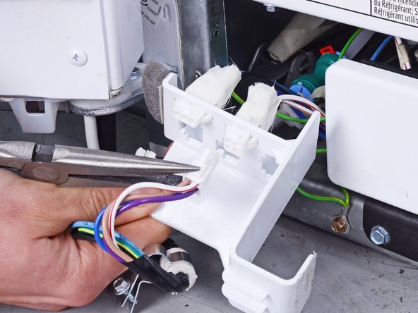

  7. Whirlpool Refrigerator Freezer Door Replacement, Disconnect the wiring harness: crwdns2935265:07crwdnd2935265:01crwdnd2935265:03crwdne2935265:0 Whirlpool Refrigerator Freezer Door Replacement, Disconnect the wiring harness: crwdns2935265:07crwdnd2935265:02crwdnd2935265:03crwdne2935265:0 Whirlpool Refrigerator Freezer Door Replacement, Disconnect the wiring harness: crwdns2935265:07crwdnd2935265:03crwdnd2935265:03crwdne2935265:0
    • Disconnect any connectors attached to the door wiring harness.

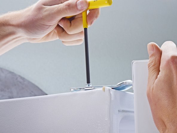

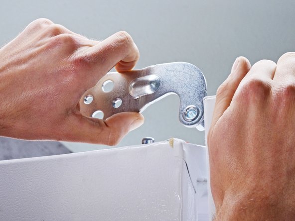

  11. Whirlpool Refrigerator Freezer Door Replacement, Unfasten the freezer door: crwdns2935265:011crwdnd2935265:01crwdnd2935265:02crwdne2935265:0 Whirlpool Refrigerator Freezer Door Replacement, Unfasten the freezer door: crwdns2935265:011crwdnd2935265:02crwdnd2935265:02crwdne2935265:0
    • Depending on your device, you may have a plastic cover on the hinge. Remove it before continuing.
    • Hold the door while performing the next two steps to avoid the door from accidentally falling.
    • Remove the screw(s) securing the freezer door.
    • Some devices may have screws solely for alignment. You don't need to remove these.

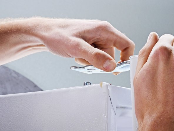

  12. Whirlpool Refrigerator Freezer Door Replacement, Remove the door hinge: crwdns2935265:012crwdnd2935265:01crwdnd2935265:03crwdne2935265:0 Whirlpool Refrigerator Freezer Door Replacement, Remove the door hinge: crwdns2935265:012crwdnd2935265:02crwdnd2935265:03crwdne2935265:0 Whirlpool Refrigerator Freezer Door Replacement, Remove the door hinge: crwdns2935265:012crwdnd2935265:03crwdnd2935265:03crwdne2935265:0
    • Pull the door hinge straight up to separate its alignment pins from the chassis.
    • Remove the door hinge.

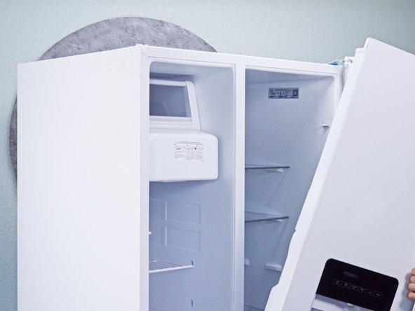

  13. Whirlpool Refrigerator Freezer Door Replacement, Reposition the cables: crwdns2935265:013crwdnd2935265:01crwdnd2935265:03crwdne2935265:0 Whirlpool Refrigerator Freezer Door Replacement, Reposition the cables: crwdns2935265:013crwdnd2935265:02crwdnd2935265:03crwdne2935265:0 Whirlpool Refrigerator Freezer Door Replacement, Reposition the cables: crwdns2935265:013crwdnd2935265:03crwdnd2935265:03crwdne2935265:0
    • Pull the freezer door straight up to disconnect it from the chassis.
    • Thread the cables through their slot in the chassis.
    • You may need to thread them individually.
  14. Whirlpool Refrigerator Freezer Door Replacement, Remove the door: crwdns2935265:014crwdnd2935265:01crwdnd2935265:02crwdne2935265:0 Whirlpool Refrigerator Freezer Door Replacement, Remove the door: crwdns2935265:014crwdnd2935265:02crwdnd2935265:02crwdne2935265:0
    • You're now left with the freezer door.
