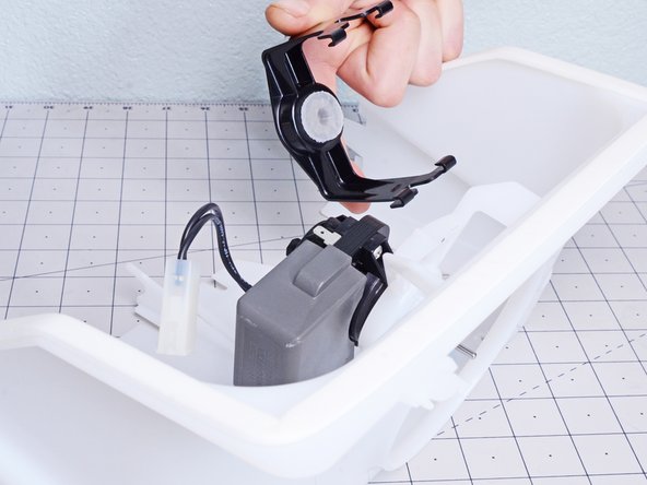

  13. Whirlpool Refrigerator Evaporator Fan Replacement, Remove the motor bracket: crwdns2935265:013crwdnd2935265:01crwdnd2935265:03crwdne2935265:0 Whirlpool Refrigerator Evaporator Fan Replacement, Remove the motor bracket: crwdns2935265:013crwdnd2935265:02crwdnd2935265:03crwdne2935265:0 Whirlpool Refrigerator Evaporator Fan Replacement, Remove the motor bracket: crwdns2935265:013crwdnd2935265:03crwdnd2935265:03crwdne2935265:0
    • Use your fingers to pry up and release the motor bracket clips from the housing.
  14. Whirlpool Refrigerator Evaporator Fan Replacement, Remove the motor bracket: crwdns2935265:014crwdnd2935265:01crwdnd2935265:02crwdne2935265:0 Whirlpool Refrigerator Evaporator Fan Replacement, Remove the motor bracket: crwdns2935265:014crwdnd2935265:02crwdnd2935265:02crwdne2935265:0
    • Remove the motor bracket.
  15. Whirlpool Refrigerator Evaporator Fan Replacement, Remove the motor: crwdns2935265:015crwdnd2935265:01crwdnd2935265:03crwdne2935265:0 Whirlpool Refrigerator Evaporator Fan Replacement, Remove the motor: crwdns2935265:015crwdnd2935265:02crwdnd2935265:03crwdne2935265:0 Whirlpool Refrigerator Evaporator Fan Replacement, Remove the motor: crwdns2935265:015crwdnd2935265:03crwdnd2935265:03crwdne2935265:0
    • Pull the motor straight out of its housing to remove it.
