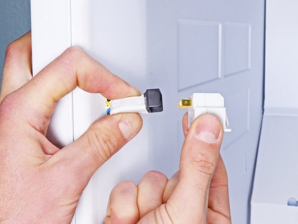

      • Depending on your repair, open one or both doors.
    1. Whirlpool Refrigerator Door Sensor Replacement, Unclip the door sensor: crwdns2935265:02crwdnd2935265:01crwdnd2935265:03crwdne2935265:0 Whirlpool Refrigerator Door Sensor Replacement, Unclip the door sensor: crwdns2935265:02crwdnd2935265:02crwdnd2935265:03crwdne2935265:0 Whirlpool Refrigerator Door Sensor Replacement, Unclip the door sensor: crwdns2935265:02crwdnd2935265:03crwdnd2935265:03crwdne2935265:0
      • Insert a flathead screwdriver, or a similar tool, between the door sensor and the chassis.
      • Pry up to separate the door sensor enough so you can grip it with your fingers.
    2. Whirlpool Refrigerator Door Sensor Replacement, Remove the door sensor: crwdns2935265:03crwdnd2935265:01crwdnd2935265:02crwdne2935265:0 Whirlpool Refrigerator Door Sensor Replacement, Remove the door sensor: crwdns2935265:03crwdnd2935265:02crwdnd2935265:02crwdne2935265:0
      • Pull the door sensor through the chassis enough to access its connectors.
      • Disconnect any connectors attached to the door sensor.
      • Remove the door sensor.

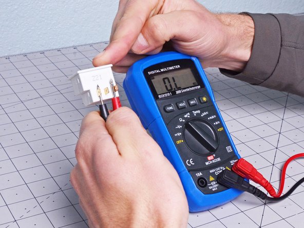

    3. Whirlpool Refrigerator Door Sensor Replacement, Meter the door sensor: crwdns2935265:04crwdnd2935265:01crwdnd2935265:02crwdne2935265:0 Whirlpool Refrigerator Door Sensor Replacement, Meter the door sensor: crwdns2935265:04crwdnd2935265:02crwdnd2935265:02crwdne2935265:0
      • If you own a multimeter, you can test your door sensor's resistance.
      • Set the multimeter to the resistance or continuity measurement mode.
      • With the button in its neutral position, the multimeter should read "OL."
      • With the button pressed, the multimeter should read around 0Ω.
