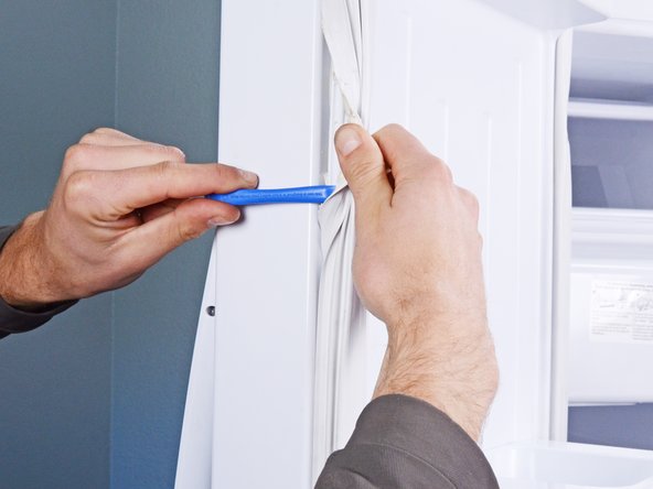

  3. Whirlpool Refrigerator Door Seal Replacement, Disconnect the door seal: crwdns2935265:03crwdnd2935265:01crwdnd2935265:03crwdne2935265:0 Whirlpool Refrigerator Door Seal Replacement, Disconnect the door seal: crwdns2935265:03crwdnd2935265:02crwdnd2935265:03crwdne2935265:0 Whirlpool Refrigerator Door Seal Replacement, Disconnect the door seal: crwdns2935265:03crwdnd2935265:03crwdnd2935265:03crwdne2935265:0
    • Insert an opening tool, or a similar tool, between the door frame and the seal.
    • Pry up to separate the seal from its groove on the frame.
    • This may take significant force.
  4. Whirlpool Refrigerator Door Seal Replacement, Remove the door seal: crwdns2935265:04crwdnd2935265:01crwdnd2935265:03crwdne2935265:0 Whirlpool Refrigerator Door Seal Replacement, Remove the door seal: crwdns2935265:04crwdnd2935265:02crwdnd2935265:03crwdne2935265:0 Whirlpool Refrigerator Door Seal Replacement, Remove the door seal: crwdns2935265:04crwdnd2935265:03crwdnd2935265:03crwdne2935265:0
    • Use your hand and the opening tool to peel the door seal away from the frame.
    • Repeat this process for the perimeter of the door seal until the seal is completely separated.
