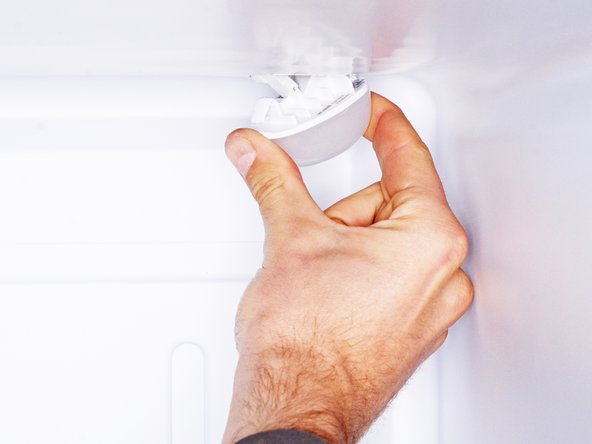

    • Depending on your repair, open one or both doors.
  2. Whirlpool Refrigerator Door Light Replacement, Unclip the door light: crwdns2935265:02crwdnd2935265:01crwdnd2935265:02crwdne2935265:0 Whirlpool Refrigerator Door Light Replacement, Unclip the door light: crwdns2935265:02crwdnd2935265:02crwdnd2935265:02crwdne2935265:0
    • Be careful during this step, as it's easy to scratch the interior of the fridge or crack cold and brittle plastic.
    • Carefully insert a flathead screwdriver, or a similar tool, between the door light and the chassis.
    • Pry up to separate the door light enough so you can grip it with your fingers.
  3. Whirlpool Refrigerator Door Light Replacement: crwdns2935265:03crwdnd2935265:01crwdnd2935265:03crwdne2935265:0 Whirlpool Refrigerator Door Light Replacement: crwdns2935265:03crwdnd2935265:02crwdnd2935265:03crwdne2935265:0 Whirlpool Refrigerator Door Light Replacement: crwdns2935265:03crwdnd2935265:03crwdnd2935265:03crwdne2935265:0
    • Tilt the door light downward to completely release its plastic clips.
    • Pull the light down to expose its connectors.
  4. Whirlpool Refrigerator Door Light Replacement: crwdns2935265:04crwdnd2935265:01crwdnd2935265:03crwdne2935265:0 Whirlpool Refrigerator Door Light Replacement: crwdns2935265:04crwdnd2935265:02crwdnd2935265:03crwdne2935265:0 Whirlpool Refrigerator Door Light Replacement: crwdns2935265:04crwdnd2935265:03crwdnd2935265:03crwdne2935265:0
    • Disconnect any connectors attached to the door light.
    • Remove the door light.
