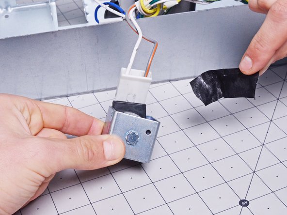

    • Remove the dispenser head out of its metal solenoid cube.
  14. Whirlpool Refrigerator Dispenser Solenoid Replacement, Remove the tape: crwdns2935265:014crwdnd2935265:01crwdnd2935265:03crwdne2935265:0 Whirlpool Refrigerator Dispenser Solenoid Replacement, Remove the tape: crwdns2935265:014crwdnd2935265:02crwdnd2935265:03crwdne2935265:0 Whirlpool Refrigerator Dispenser Solenoid Replacement, Remove the tape: crwdns2935265:014crwdnd2935265:03crwdnd2935265:03crwdne2935265:0
    • Peel the tape off the solenoid connector.
    • Set the tape aside. You'll reuse it during reassembly.
  15. Whirlpool Refrigerator Dispenser Solenoid Replacement, Disconnect the solenoid: crwdns2935265:015crwdnd2935265:01crwdnd2935265:03crwdne2935265:0 Whirlpool Refrigerator Dispenser Solenoid Replacement, Disconnect the solenoid: crwdns2935265:015crwdnd2935265:02crwdnd2935265:03crwdne2935265:0 Whirlpool Refrigerator Dispenser Solenoid Replacement, Disconnect the solenoid: crwdns2935265:015crwdnd2935265:03crwdnd2935265:03crwdne2935265:0
    • Disconnect the connector attached to the solenoid.
  16. Whirlpool Refrigerator Dispenser Solenoid Replacement, Meter the solenoid: crwdns2935265:016crwdnd2935265:01crwdnd2935265:01crwdne2935265:0
    • If you own a multimeter, you can test your solenoid's resistance.
    • A range between 10-500Ω is acceptable. Check your fridge solenoid specs sheet for more details. The pictured solenoid measured at 33.9Ω.
