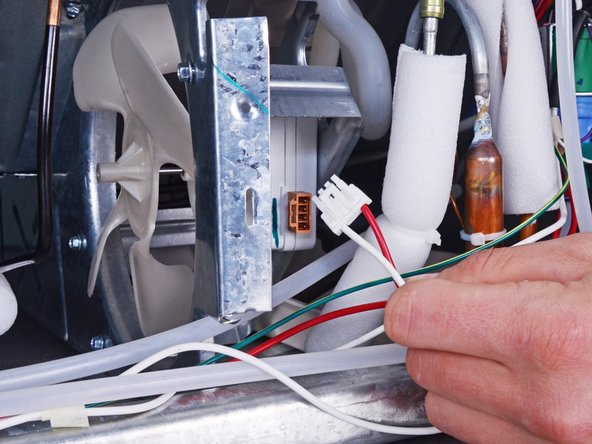

    1. Whirlpool Refrigerator Condenser Fan Replacement, Disconnect the condenser fan: crwdns2935265:04crwdnd2935265:01crwdnd2935265:02crwdne2935265:0 Whirlpool Refrigerator Condenser Fan Replacement, Disconnect the condenser fan: crwdns2935265:04crwdnd2935265:02crwdnd2935265:02crwdne2935265:0
      • Disconnect the connector attached to the condenser fan.

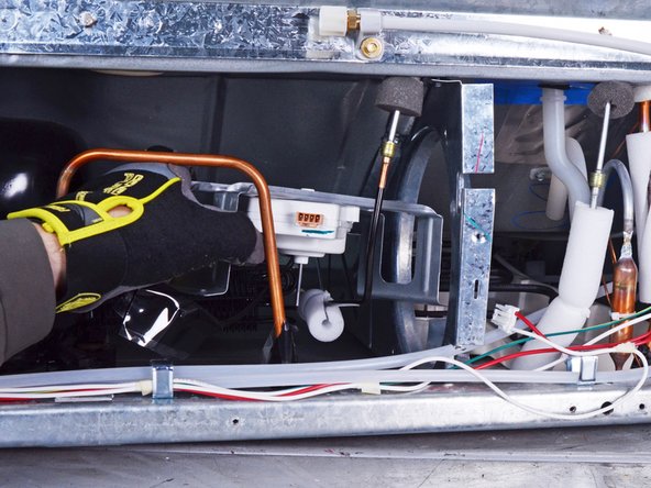

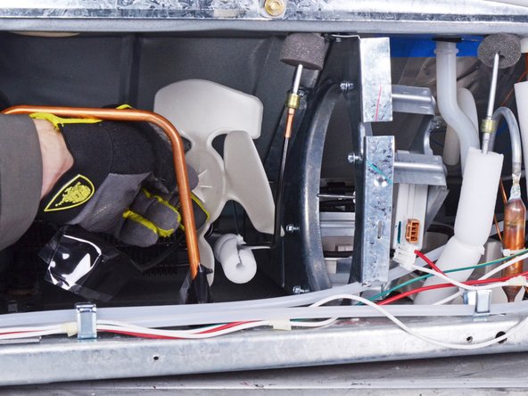

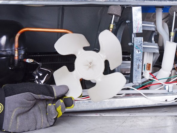

    2. Whirlpool Refrigerator Condenser Fan Replacement, Remove the condenser fan: crwdns2935265:05crwdnd2935265:01crwdnd2935265:03crwdne2935265:0 Whirlpool Refrigerator Condenser Fan Replacement, Remove the condenser fan: crwdns2935265:05crwdnd2935265:02crwdnd2935265:03crwdne2935265:0 Whirlpool Refrigerator Condenser Fan Replacement, Remove the condenser fan: crwdns2935265:05crwdnd2935265:03crwdnd2935265:03crwdne2935265:0
      • Put on gloves before continuing, as the sheet metal and the fan itself are sharp.
      • Pull the condenser fan straight off its peg to remove it.

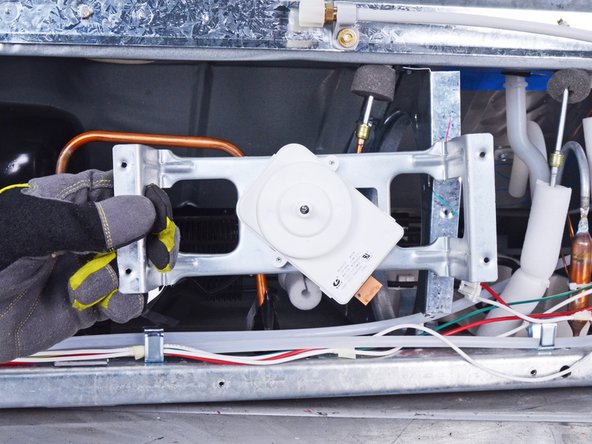

    3. Whirlpool Refrigerator Condenser Fan Replacement, Unfasten the condenser fan motor: crwdns2935265:06crwdnd2935265:01crwdnd2935265:01crwdne2935265:0
      • Remove the screw(s) securing the condenser fan motor to the chassis.
    4. Whirlpool Refrigerator Condenser Fan Replacement, Remove the motor: crwdns2935265:07crwdnd2935265:01crwdnd2935265:03crwdne2935265:0 Whirlpool Refrigerator Condenser Fan Replacement, Remove the motor: crwdns2935265:07crwdnd2935265:02crwdnd2935265:03crwdne2935265:0 Whirlpool Refrigerator Condenser Fan Replacement, Remove the motor: crwdns2935265:07crwdnd2935265:03crwdnd2935265:03crwdne2935265:0
      • Rotate the motor housing through its slot in the chassis.
      • Remove the motor.
