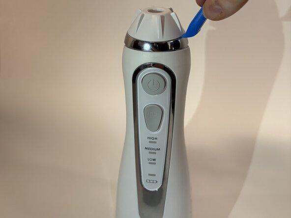

Depress the tip eject button and remove the tip.

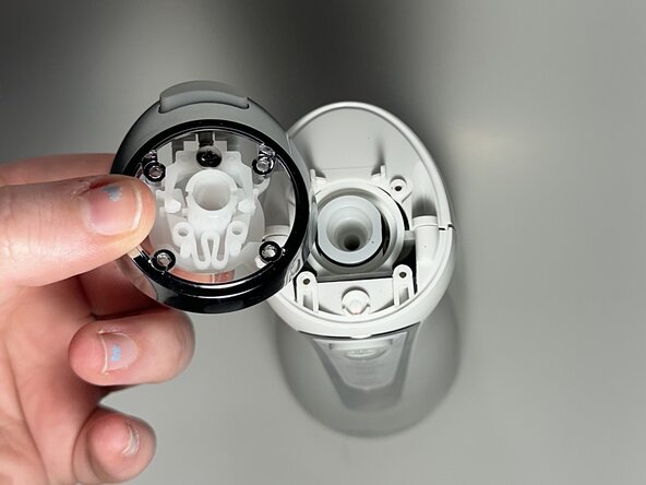

Use an opening tool to pry off the tip rotator.
Remove the four Phillips screws beneath the tip rotator.
Remove the eject button assembly.

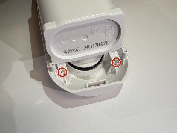

Use a Phillips #0 screwdriver to remove the two screws beneath the eject button assembly.
Remove the water reservoir.

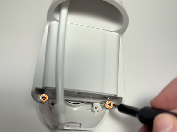

Remove the two Phillips #0 screws toward the bottom of the device.

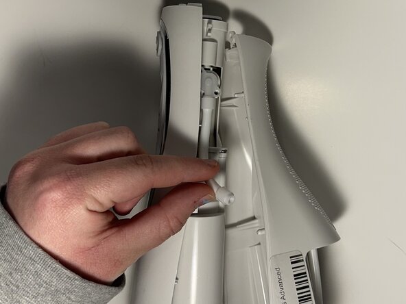

Insert the flat end of a spudger into the seam between the front and rear case and gently begin to pry the two halves apart.
Disconnect the hose from the right side of the device and fully separate the two halves.

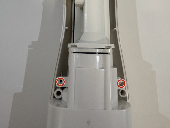

Remove the two screws at the top, two screws in the middle, and two screws at the bottom using a Phillips #0 screwdriver.

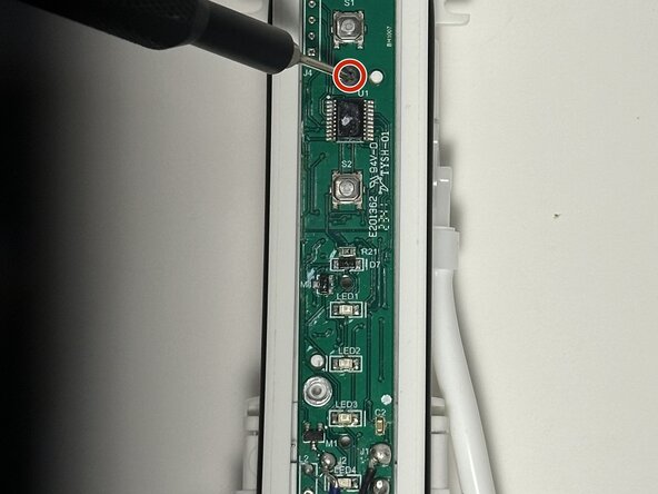

Use a Phillips screwdriver to remove the two screws that secure the motherboard.
Carefully desolder the black, red, and blue wires from the motherboard.
Remove the motherboard.
