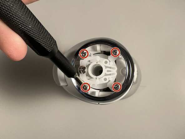

  2. Waterpik Cordless Advanced 2.0 WP-580 Motherboard Replacement: crwdns2935265:02crwdnd2935265:01crwdnd2935265:02crwdne2935265:0 Waterpik Cordless Advanced 2.0 WP-580 Motherboard Replacement: crwdns2935265:02crwdnd2935265:02crwdnd2935265:02crwdne2935265:0
    • Remove the four Phillips screws beneath the tip rotator.
    • Remove the eject button assembly.
