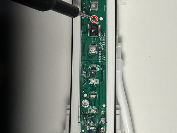

  6. Waterpik Cordless Advanced 2.0 WP-580 Battery Replacement: crwdns2935265:06crwdnd2935265:01crwdnd2935265:03crwdne2935265:0 Waterpik Cordless Advanced 2.0 WP-580 Battery Replacement: crwdns2935265:06crwdnd2935265:02crwdnd2935265:03crwdne2935265:0 Waterpik Cordless Advanced 2.0 WP-580 Battery Replacement: crwdns2935265:06crwdnd2935265:03crwdnd2935265:03crwdne2935265:0
    • Use a Phillips screwdriver to remove the two screws that secure the motherboard.
