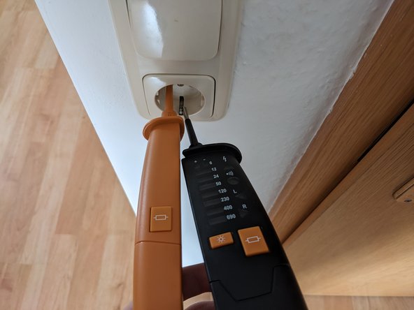

  2. Wall Outlet (Type F) Replacement, Determine voltage absence: crwdns2935265:02crwdnd2935265:01crwdnd2935265:01crwdne2935265:0
    • Use a Duspol or any other two-pole voltage tester to test if there is voltage at the contacts.
    • Do not work on live circuits if you are not an experienced professional.

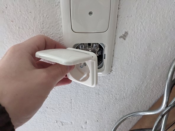

  3. Wall Outlet (Type F) Replacement, Remove the old outlet cover: crwdns2935265:03crwdnd2935265:01crwdnd2935265:03crwdne2935265:0 Wall Outlet (Type F) Replacement, Remove the old outlet cover: crwdns2935265:03crwdnd2935265:02crwdnd2935265:03crwdne2935265:0 Wall Outlet (Type F) Replacement, Remove the old outlet cover: crwdns2935265:03crwdnd2935265:03crwdnd2935265:03crwdne2935265:0
    • Remove the outlet cover by unscrewing the middle captive screw with flat head screwdriver.
    • Remove the frame.
    • If you can't remove the frame because there's a switch on the same frame, take a look at this guide, on how to remove the cover of a switch.
  4. Wall Outlet (Type F) Replacement, Remove the wall outlet: crwdns2935265:04crwdnd2935265:01crwdnd2935265:01crwdne2935265:0
    • Loosen the holding claws by turning the two screws.
    • If your outlet is mounted inside a cavity wall box you can remove it by loosening the two screws around the perimeter and turning the switch until the two keyholes line up.

  8. Wall Outlet (Type F) Replacement, Test the new outlet: crwdns2935265:09crwdnd2935265:01crwdnd2935265:03crwdne2935265:0 Wall Outlet (Type F) Replacement, Test the new outlet: crwdns2935265:09crwdnd2935265:02crwdnd2935265:03crwdne2935265:0 Wall Outlet (Type F) Replacement, Test the new outlet: crwdns2935265:09crwdnd2935265:03crwdnd2935265:03crwdne2935265:0
    • Measure across Hot and Neutral.
    • You want 230V
    • Measure across Hot and Ground.
    • You want 230V
    • Measure across Ground and Neutral.
    • You want 0V
    • Apply load between Hot and Neutral by pressing the two large buttons.
    • If this trips your GFCI, you either swapped Ground and Neutral, or your Neutral belongs to a different GFCI than your Phase Conductor.
