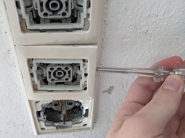

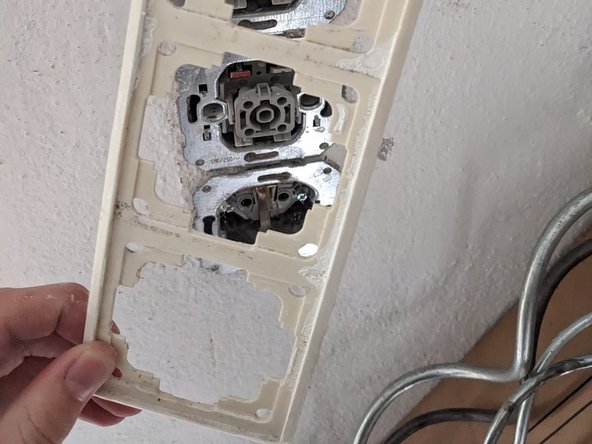

  2. Momentary Switch Replacement, Remove the old switch cover: crwdns2935265:03crwdnd2935265:01crwdnd2935265:03crwdne2935265:0 Momentary Switch Replacement, Remove the old switch cover: crwdns2935265:03crwdnd2935265:02crwdnd2935265:03crwdne2935265:0 Momentary Switch Replacement, Remove the old switch cover: crwdns2935265:03crwdnd2935265:03crwdnd2935265:03crwdne2935265:0
    • Remove the switch cover by jamming a flat head screwdriver into the gap between the outer frame and the switch cover.
    • Some manufacturers, like Busch-Jaeger have an extra frame beneath the switch cover, so you'll have to remove that as well.
    • Remove the frame
    • If you can't remove the frame because there's a wall socket on the same frame, take a look at this guide, on how to remove the cover of a wall outlet.

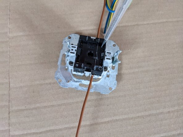

  4. Momentary Switch Replacement, Determine voltage absence: crwdns2935265:05crwdnd2935265:01crwdnd2935265:02crwdne2935265:0 Momentary Switch Replacement, Determine voltage absence: crwdns2935265:05crwdnd2935265:02crwdnd2935265:02crwdne2935265:0
    • Use a Duspol or any other two-pole voltage tester to test if there is voltage at the contacts.
    • Do not work on live circuits if you are not an experienced professional.
  5. Momentary Switch Replacement, Disconnect the wires: crwdns2935265:06crwdnd2935265:01crwdnd2935265:01crwdne2935265:0
    • Disconnect the wires form the old switch.
    • If the old switch has Push-In contacts, you can unlock the terminals by pushing down on the plastic levers.
    • If you short Earth to Neutral you'll trigger your GFCI/RCD, even if the power is off.
  6. Momentary Switch Replacement, Connect the new switch: crwdns2935265:07crwdnd2935265:01crwdnd2935265:01crwdne2935265:0
    • Connect the new switch. The new switch will typically mark where to connect which wire.
    • In (Phase Conductor/L)
    • Out
