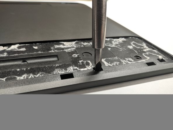

    2. Wacom Cintiq Pro 13 Disassembly: crwdns2935265:02crwdnd2935265:01crwdnd2935265:02crwdne2935265:0 Wacom Cintiq Pro 13 Disassembly: crwdns2935265:02crwdnd2935265:02crwdnd2935265:02crwdne2935265:0
      • Remove two rubber feet on both sides of the tablet
      • Use plastic tools to lift rubber feet to avoid scratching the back cover
      • Remove two #0 Phillips screws hiding under rubber feet

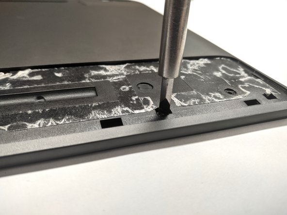

    3. Wacom Cintiq Pro 13 Disassembly: crwdns2935265:03crwdnd2935265:01crwdnd2935265:01crwdne2935265:0
      • Remove two T5 Torx screws on the bottom of the device
      • Remove two plastic covers as they come loose
      • Removing two T5 Torx screws and shields on the top side is not required to disassemble the device

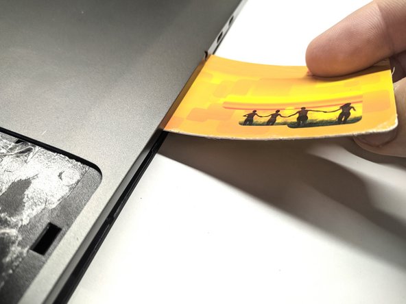

    4. Wacom Cintiq Pro 13 Disassembly: crwdns2935265:04crwdnd2935265:01crwdnd2935265:03crwdne2935265:0 Wacom Cintiq Pro 13 Disassembly: crwdns2935265:04crwdnd2935265:02crwdnd2935265:03crwdne2935265:0 Wacom Cintiq Pro 13 Disassembly: crwdns2935265:04crwdnd2935265:03crwdnd2935265:03crwdne2935265:0

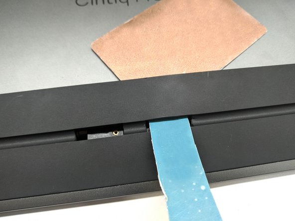

      • Heat up the bottom rubber plate near holes using heat gun or hairdryer and try to insert prying tool as adhesive softens.
      • A drip or two of isopropyl alcohol on the plastic tools can soften the adhesive even further
      • If you're using Heat Gun do not overheat the rubber plate as it may melt. You should be still able to touch the rubber plate with bare hands after heating it up.
      • Watch out for ribbon cables hiding in holes, as covers with T5 Torx screws are now removed.
      • As the adhesive softens, try to insert flat plastic tool on the top
      • Heat up the rest of the rubber plate and slide plastic tool along upper side of the rubber plate

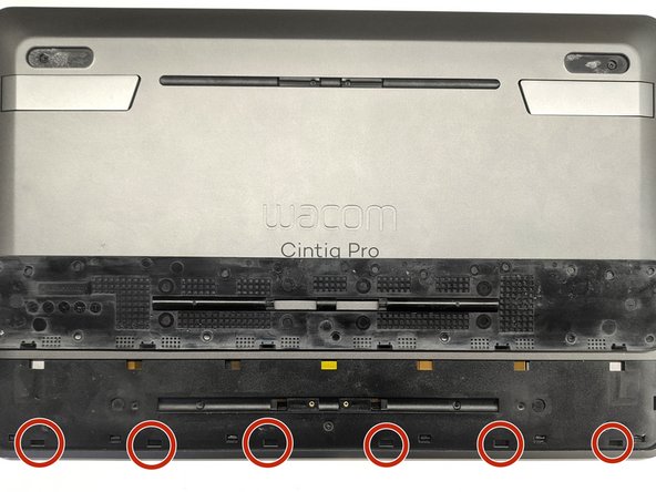

      • The bottom side of the plate has plastic clips (third image). Trying to push plastic tool too hard in lower part may result in damaging plastic clips
      • Remove the rubber plate

    6. Wacom Cintiq Pro 13 Disassembly: crwdns2935265:06crwdnd2935265:01crwdnd2935265:03crwdne2935265:0 Wacom Cintiq Pro 13 Disassembly: crwdns2935265:06crwdnd2935265:02crwdnd2935265:03crwdne2935265:0 Wacom Cintiq Pro 13 Disassembly: crwdns2935265:06crwdnd2935265:03crwdnd2935265:03crwdne2935265:0
      • Unclip ONE of top left/right clips holding back plate to display frame
      • Do not push in any of red circled holes - it may break ribbon cables, display or front glass

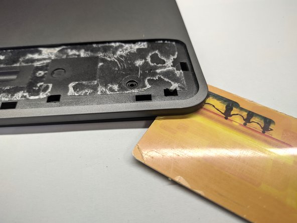

      • Push gently on the clip to allow flat plastic tool to be inserted on the corner of the device
      • Pushing too hard or pushing in holes circled red in last step may result in damage
      • Insert flat plastic tool between the rubber glass frame and the back panel
    8. Wacom Cintiq Pro 13 Disassembly: crwdns2935265:08crwdnd2935265:01crwdnd2935265:02crwdne2935265:0 Wacom Cintiq Pro 13 Disassembly: crwdns2935265:08crwdnd2935265:02crwdnd2935265:02crwdne2935265:0

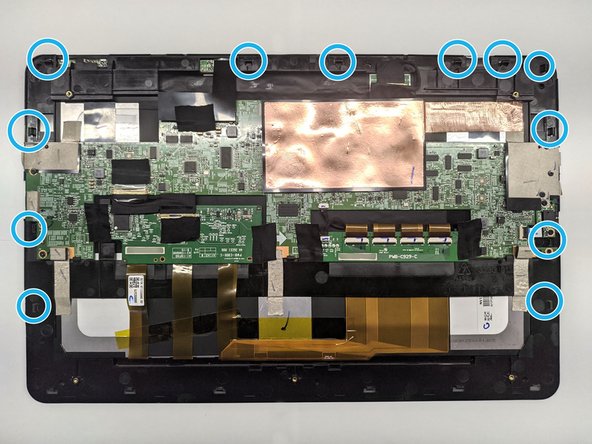

      • Unclip rest of visible clips
    9. Wacom Cintiq Pro 13 Disassembly: crwdns2935265:09crwdnd2935265:01crwdnd2935265:03crwdne2935265:0 Wacom Cintiq Pro 13 Disassembly: crwdns2935265:09crwdnd2935265:02crwdnd2935265:03crwdne2935265:0 Wacom Cintiq Pro 13 Disassembly: crwdns2935265:09crwdnd2935265:03crwdnd2935265:03crwdne2935265:0
      • The bottom part of the device will come loose allowing you to place finger between the case and the display assembly
      • Unclip hidden clips on left or right side and continue to opposite side. Plastic flat tool may come in handy here
      • You can insert plastic tools up to 2 cm / 1 inch inside and not damage anything. Third image will guide you through clips and other obstacles
      • Unclip all twelve clips. Keep one hand on the display to decrease display bending and second to slowly lift the back cover.
      • There is nothing connected to the back panel - no need to worry about hidden flex/ribbon cables
      • Remove the back cover

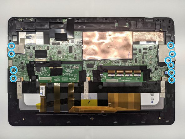

    10. Wacom Cintiq Pro 13 Disassembly, Internal components removal: crwdns2935265:010crwdnd2935265:01crwdnd2935265:02crwdne2935265:0 Wacom Cintiq Pro 13 Disassembly, Internal components removal: crwdns2935265:010crwdnd2935265:02crwdnd2935265:02crwdne2935265:0
      • Remove ten #0 Phillips screws
    11. Wacom Cintiq Pro 13 Disassembly: crwdns2935265:011crwdnd2935265:01crwdnd2935265:02crwdne2935265:0 Wacom Cintiq Pro 13 Disassembly: crwdns2935265:011crwdnd2935265:02crwdnd2935265:02crwdne2935265:0

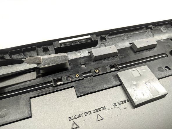

      • Remove thermal pads
      • You can place thermal pads onto the back plate, as there are special holes for every of them

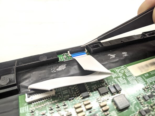

      • Release the latch of the audio jack flex cable port on the mainboard
      • Try to slide the flex cable towards the audio jack board and then lift it up
    14. Wacom Cintiq Pro 13 Disassembly, Unplugging Control and power button board: crwdns2935265:014crwdnd2935265:01crwdnd2935265:03crwdne2935265:0 Wacom Cintiq Pro 13 Disassembly, Unplugging Control and power button board: crwdns2935265:014crwdnd2935265:02crwdnd2935265:03crwdne2935265:0 Wacom Cintiq Pro 13 Disassembly, Unplugging Control and power button board: crwdns2935265:014crwdnd2935265:03crwdnd2935265:03crwdne2935265:0
      • Release the latch of the control board flex cable
      • Try to slide the flex cable towards the mainboard and then lift it up
      • Repeat the procedure for the flex cable connector on the mainboard
      • Remove the cable

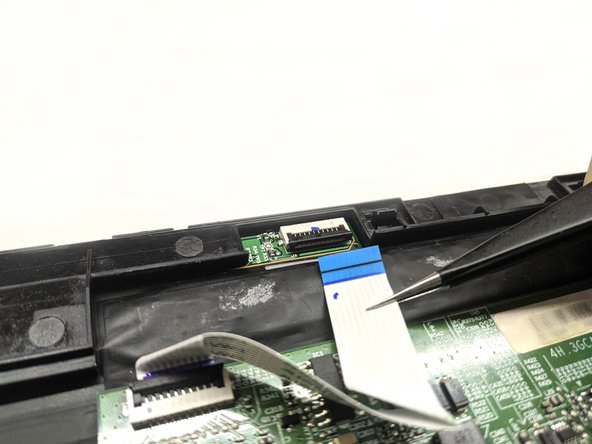

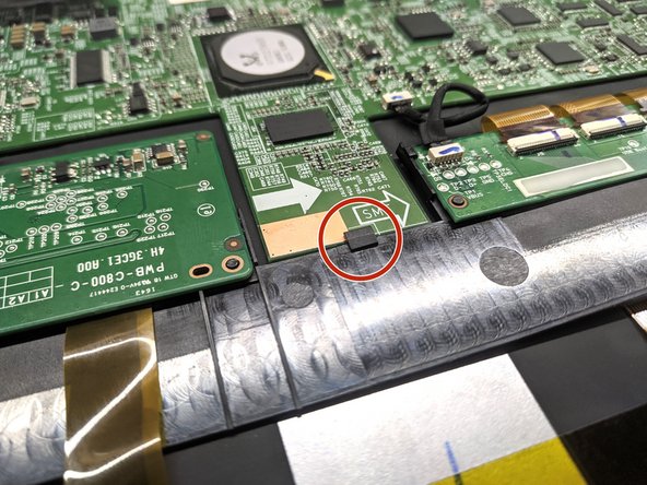

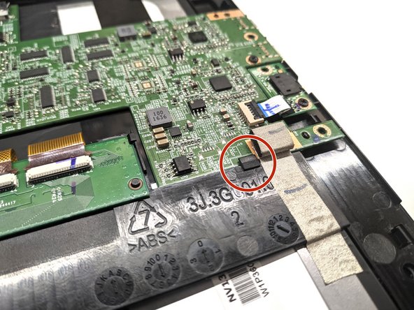

    15. Wacom Cintiq Pro 13 Disassembly, Disconnecting digitizer boards: crwdns2935265:015crwdnd2935265:01crwdnd2935265:01crwdne2935265:0
      • Remove the digitizer board cable
      • Try to hold it as near the plastic connector as possible and then pull it towards the digitizer board
      • Do not pull by the middle or opposite end of the cable
    16. Wacom Cintiq Pro 13 Disassembly: crwdns2935265:016crwdnd2935265:01crwdnd2935265:03crwdne2935265:0 Wacom Cintiq Pro 13 Disassembly: crwdns2935265:016crwdnd2935265:02crwdnd2935265:03crwdne2935265:0 Wacom Cintiq Pro 13 Disassembly: crwdns2935265:016crwdnd2935265:03crwdnd2935265:03crwdne2935265:0
      • Remove the adhesive from the mainboard
      • Do not remove it entirely - it's a part of the cable
      • Slide the cable towards the mainboard by holding it as near the connector as possible
      • Do not pull by the middle or other end of the cable
      • If cable seems hard to remove, try to push one side of the connector using a pair of tweezers by spots marked on third image
      • Do not push center part of the connector as it can be easily bent
      • Repeat the steps for another end of the cable connected to the mainboard

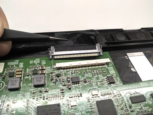

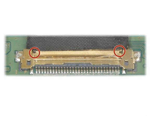

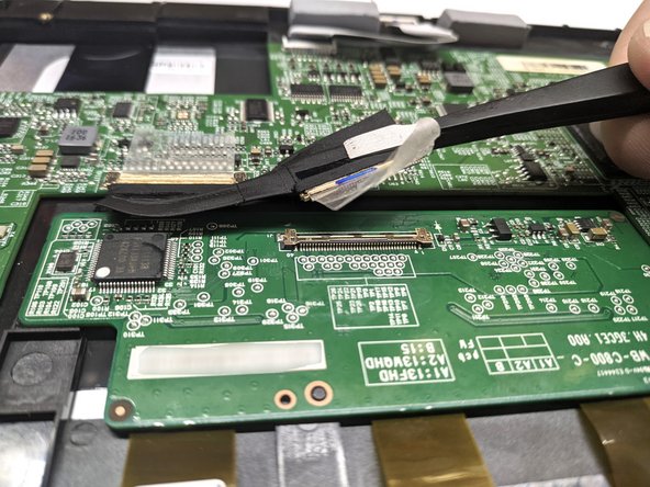

    17. Wacom Cintiq Pro 13 Disassembly, Disconnecting the display: crwdns2935265:017crwdnd2935265:01crwdnd2935265:03crwdne2935265:0 Wacom Cintiq Pro 13 Disassembly, Disconnecting the display: crwdns2935265:017crwdnd2935265:02crwdnd2935265:03crwdne2935265:0 Wacom Cintiq Pro 13 Disassembly, Disconnecting the display: crwdns2935265:017crwdnd2935265:03crwdnd2935265:03crwdne2935265:0

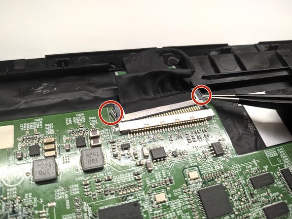

      • Remove the display connector
      • Press on the latch on left or right side of the cable
      • Slide one part of the cable just a bit
      • Repeat steps for the other side of the cable
      • Slide out the cable
      • If you wish to replace the cable, steps to disconnect the cable from the LCD display are the same as digitizer cable from last step
      • Do not pull by the cable - try holding onto the plug

Thank you for the Guide. The Cintiqe Pro 16 is of the same build and the open up part of the guide also works for that.
Differences:
Step 5: There are 7 Screws under the rubber
Step 9: The full cover has the two fans embedded into it, which are connected with 2 cables to the baseboard. You can simply unblug those to get the cover off.
Gerald Degeneve - crwdns2934203:0crwdne2934203:0 crwdns2950251:0crwdne2950251:0
